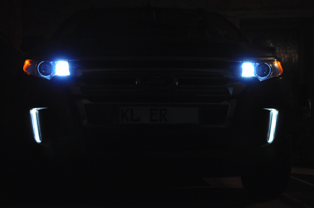

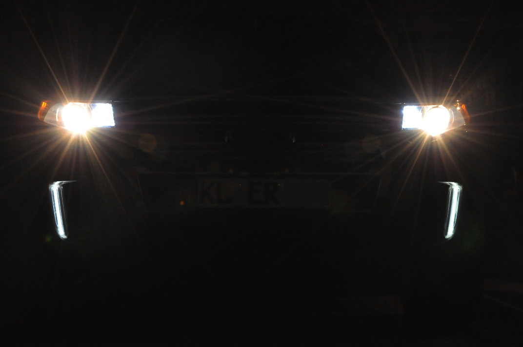

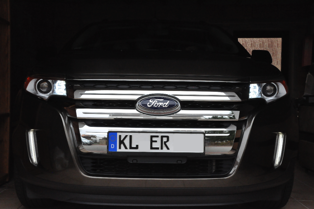

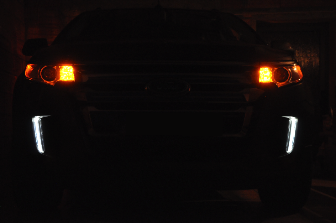

Dingo linked me these LED Switchbacks for turn signal lights. I purchased them and just got them in today. Sorry about the lighting, it started to get dark outside and there isn't good lighting in my garage. This is a really simple install. If you already know how to install them, then I hope this will help you decide if it looks good enough to install on your own Edge. Let me know what you think. I love them and can't wait to install other mod's like this!
http://www.youtube.com/watch?v=LeChFaZqfHM
Here are a few different pics I took during the day and night.
One of my next projects is changing out my HIDs for brighter ones with kc300c's instructions. That will help my lights look more uniform.
post-20945-0-01249100-1333662923_thumb.jpgpost-20945-0-03596300-1333662930_thumb.jpgpost-20945-0-07471300-1333662937_thumb.jpgpost-20945-0-02207000-1333662945_thumb.jpg

You've done me proud cellbine. That is a great video. Give me your honest opinion on the brightness and noticability of the amber light output. Are they as bright as the OEM incandescent amber light? I haven't had much luck on my last few cars finding LED turn signal bulbs that perform well enough.
A bit off topic, but what program or web site did you use to create the animated transitions and text in your video. It really looked good.
KC, I think these lights are very bright. I am really surprised with how bright the white light is and the amber lights are brighter than the OEMs. At night time is where these lights really "shine". Im very happy with them and now I just need to upgrade my headlights to match the color.
