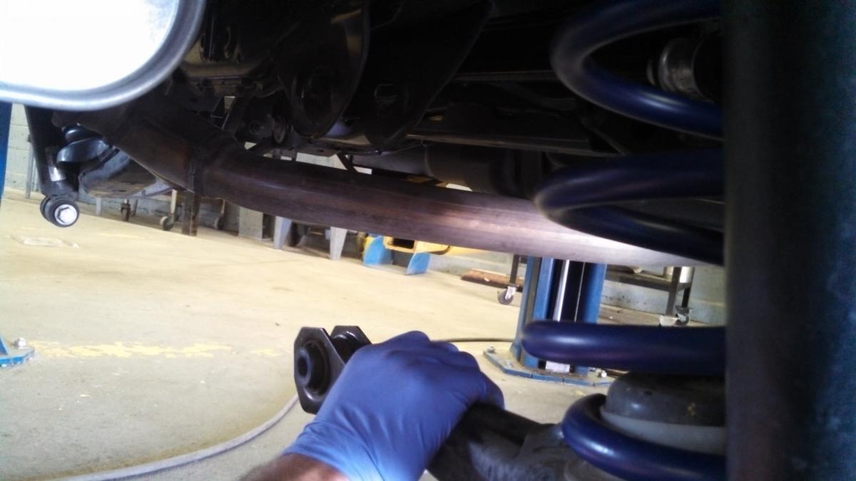

The rear springs are where I really made up time. The service manual would have you unbolt 8 or 9 things and remove the caliper, rotor, hub, and knuckle. I've attached pictures that prove that process unnecessary.
Basically, just put enough pressure on the arm and spring to relieve the tension on the rear camber bolt and slowly remove the nut locking the adjuster in place , then move to the other side of the arm and spin the adjuster bolt all the way out of its hole. As long as pressure is maintained on the arm just under the spring, the bolt slides out and you slowly lower the jack and then swing the arm down, swap springs and reinstall the bolt and nut. Total time on BOTH rears was less that 40 minutes.
Picture shows the rear camber bolt being backed out (after locking nut was removed from the opposite side) and the arm swinging down for the spring swap.
Easy stuff...

I have not lowered mine yet... but its on the list. With your couple of tips especially the rears I will be a little better prepared goin in. And yes removal of the front plastic window cowl is a huge time saver on removal of those top strut bolts! Did you mark those rear adjuster bolts before you loosened and backed them out to lower the arm and drop the stock springs?

The adjuster was already marked (factory?), i just lined it up again when I was done. It didnt matter though, it was still off a ton on the alignment rack, the drop springs pull it all over the place.

Ok..i got it, i just thought the cam adjusters would lose thier spot upon removal of the lower control arm bolt. I was wondering how it felt without an alignment. Most guys on here that did the lowering springs stated they drove it right to the alignment shop for adjustments. I pretty much expected that.
