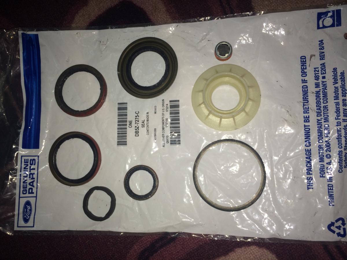

The manual recommended seal kit # DB5Z-7275-C.
The seal washer is little different and the extra seals were recycled.

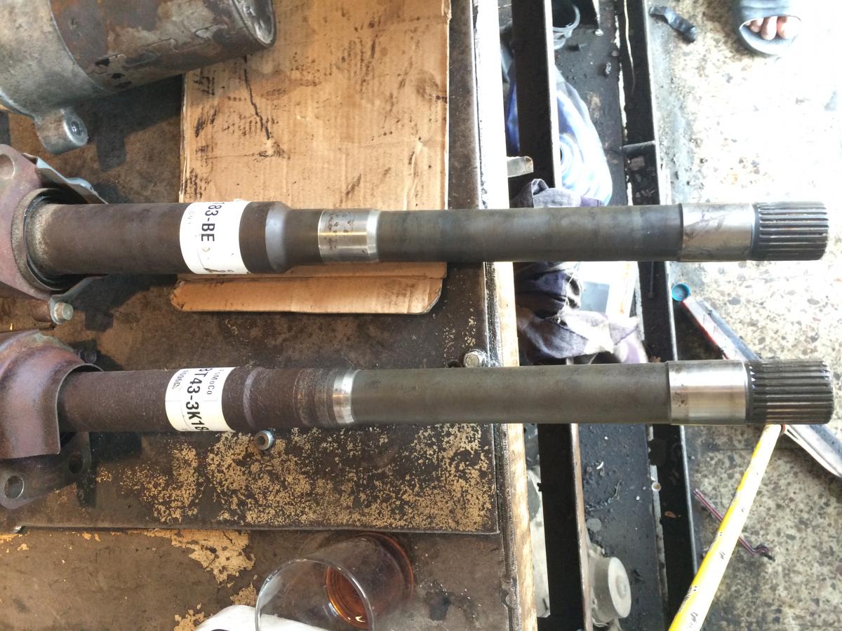

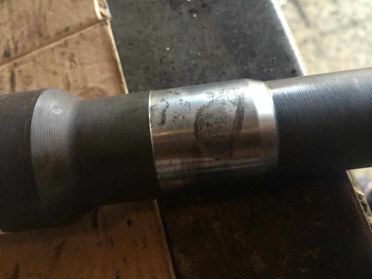

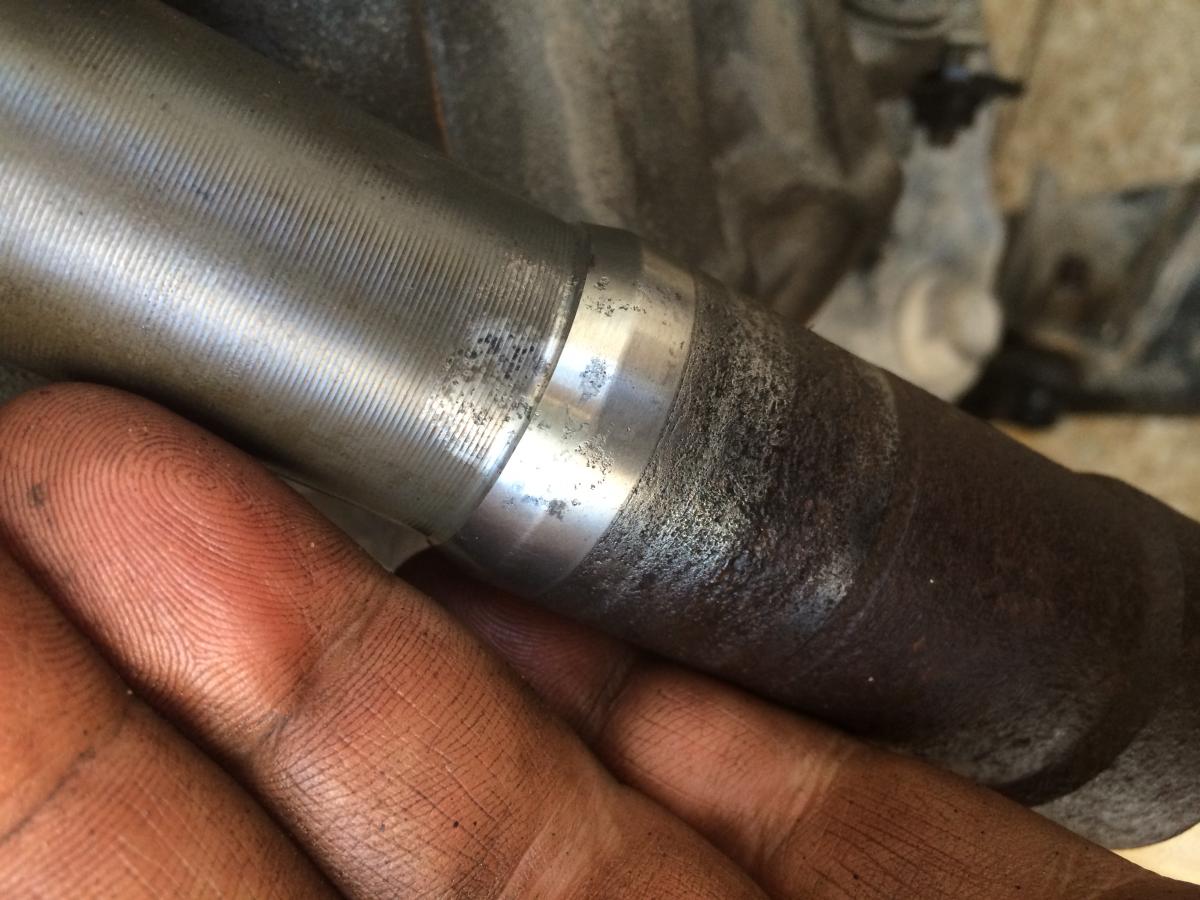

But this was a concern. The shaft journal that the seal seated on was bad.
Now I have the same new kit but need an advice.
Replace the intermediate shaft due to a bad journal. ?

The machined surfaces need to be perfect. The JY ones don't look much better than your original. I would go for a new one. I don't know the price but it should work.
If you're located outside of the US you probably can have a friend ship one to you if no local parts are available.
