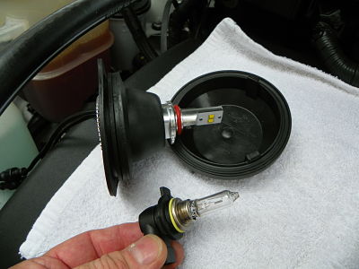

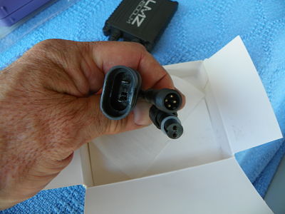

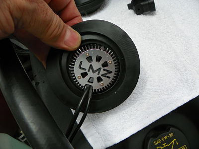

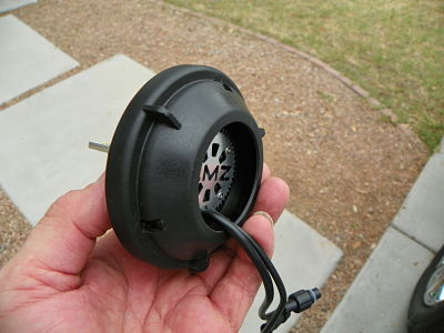

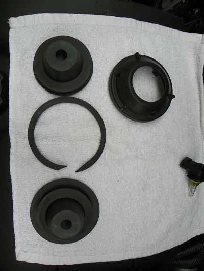

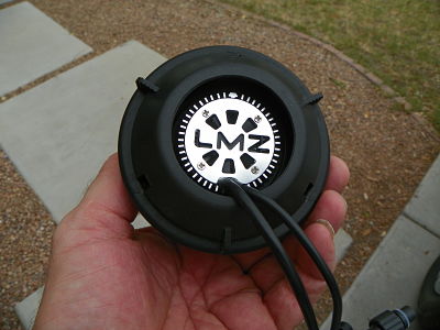

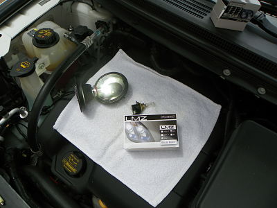

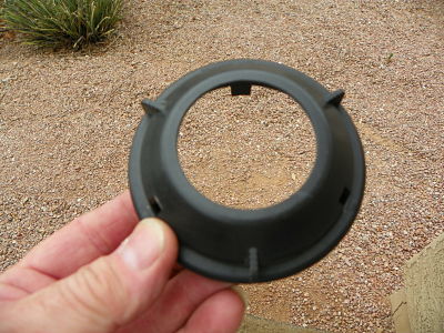

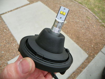

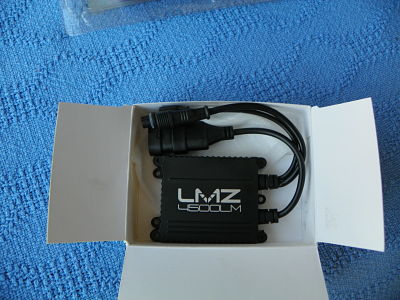

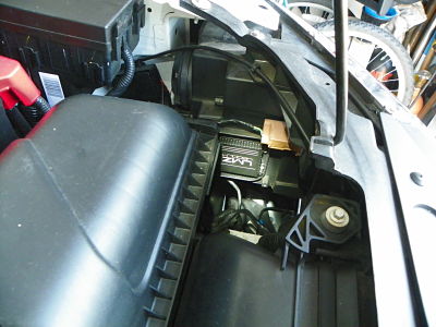

I finally had a couple days off to get them put in. I mounted the controllers with some small stainless screws where the factory ballasts would go. You can see the controllers I used and they have very well made plugs that can only go together one way, and have screw together ends. I used the rubber boots that were listed above. You can see the LED mounted in it with the factory halogen bulb next to it.I found out that they don't fit tight enough to seal the back of the headlight assy. You can see the fan at the back of the LED bulb.
More in next post.
Tarey
Edited by GNERGY

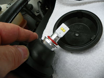

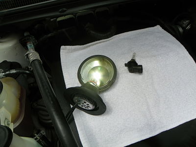

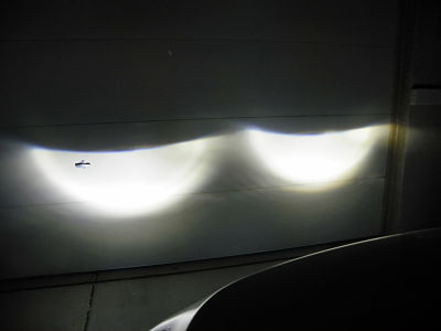

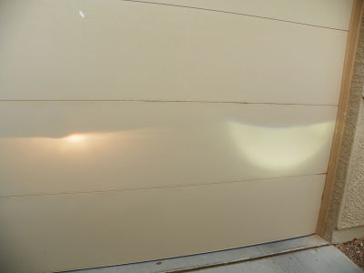

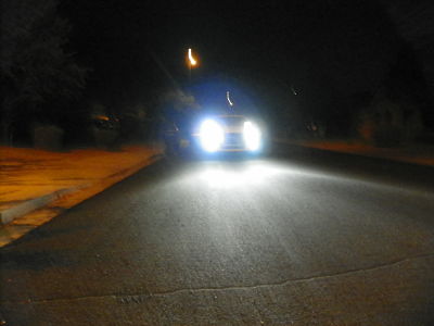

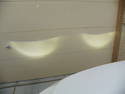

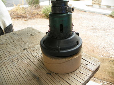

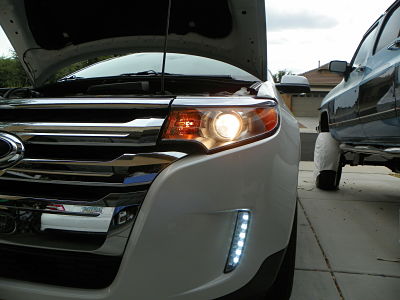

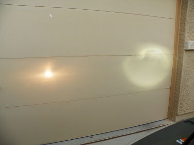

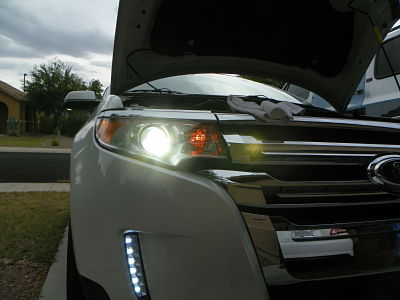

The LED bulbs slide thru the boot and then the collar that secures it to where it attaches to the headlight assy. screws on and is secured with a set screw. They are adjustable for depth and focus ( turning left or right ) The boots didn't fit tight in the back of the headlight assy. so I cut a 1/4 inch off around the outside so it would fit inside the factory dust cap. I used a hole saw to cut a 2 inch hole in the dust cap ( the same size as the back of the heat sink so the fan could keep it cool. You can see the back of the heat sink thru the dust cover. I still need to drill a small hole in the bottom of the dust cap in case any water would get in there to keep the fan from being a propeller. I got a couple pics out of sequence that show the LED's lit before I installed them. The first pic of the front ( drivers side ) still has the factory halogen bulb for comparison and the next pic ( of the passenger side ) shows the LED installed so you can see what it looks like. The next pic shows them lit on my garage door ( during the afternoon ) ( halogen on left and LED on right ) then with high beams on and then with both LEDs lit. Then with the LEDs at night and then from down the street of the front of my edge. I only had a chance to drive it down my street (which has street lights all over the place ) to really evaluate them. I didn't drive farther because it was my only day off and I was enjoying some wine with friends and I don't drink and drive.
Hopefully in the next couple of days I can drive it at night some place where it is really dark and take some pics.
So far I really like the way they look and the color 5000K whiteness that matches my other led DRLs.
