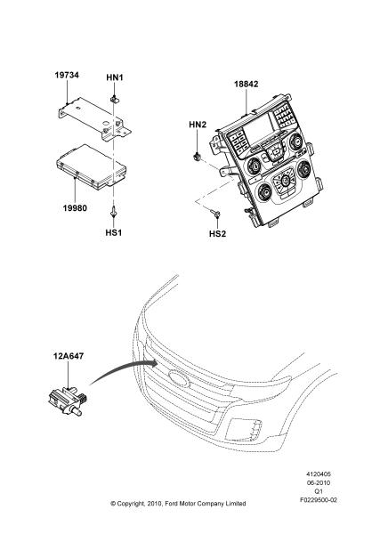

The temp remaining at the 46 degree mark or around there would suggest a bad sensor. I don't know the exact location, but it should be near the front of the car under the hood. May be near the A/C condenser. Part 12A647 in this schematic for a 2013 Edge. Should be a simple plug and play replacement part.

Thanks IS973800. I will order this sensor and see if this resolves both issues. I will also try to change the climate settings from auto to off.. i dont think i've tried that yet.

Im here to unfortunately post a follow up. The Sensor did nothing.. It is doing the same thing.
I also noticed that the Ambient Lighting is also dimming on and off to the same pattern as the air speed and temperature reading.
