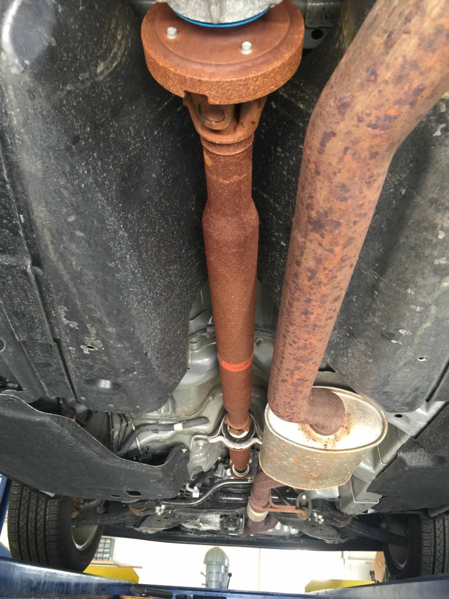

J0J0 Posted April 2, 2015 Report Share Posted April 2, 2015 While under my car doing regular maintenance and inspection, I saw how rusty the driveshaft has become in less than a year of ownership.I know grinding off the surface rust is a no-no because I can offset the balance. IF I spray some rust inhibitor to convert rust as well as prevent future rust from forming and then spray paint it black, do you think it will offset the balance of the driveshaft? Quote Link to comment Share on other sites More sharing options...
rwf78155 Posted April 2, 2015 Report Share Posted April 2, 2015 Get over it....its surface rust ! That drive shaft will last till long after you and I are dead and gone. Quote Link to comment Share on other sites More sharing options...
WWWPerfA_ZN0W Posted April 2, 2015 Report Share Posted April 2, 2015 (edited) Probably not, as long as you spray thin even coats each time, and don't add much mass to the driveshaft. You would want to be careful around any joints/hangers/bearings though, tape the heck out of them to prevent overspray. http://www.ford-trucks.com/forums/1184854-drive-shaft-rust-treatment.html http://www.fordf150.net/forums/viewtopic.php?f=69&t=86041 Edited April 2, 2015 by WWWPerfA_ZN0W Quote Link to comment Share on other sites More sharing options...

ls973800 Posted April 4, 2015 Report Share Posted April 4, 2015 If you are that worried about the drive-shaft, what about the exhaust system? That is looking pretty rusty also. In other words, both are normal. The exhaust system will rust through eventually, but the drive-shaft will remain without getting much worse. Quote Link to comment Share on other sites More sharing options...
macbwt Posted April 4, 2015 Report Share Posted April 4, 2015 Just my view, but there are better things to do than worry about a little rust on a drive shaft. If I worried about rust on my 08 Edge I would be worried to death right now. Quote Link to comment Share on other sites More sharing options...
WWWPerfA_ZN0W Posted April 4, 2015 Report Share Posted April 4, 2015 Still, if you want to fix it, you should know how. Same reason why the subframe on my SHO was painted before being put in. Quote Link to comment Share on other sites More sharing options...
J0J0 Posted April 5, 2015 Author Report Share Posted April 5, 2015 Exhaust will be changed, so I'm not worried about it. The drive shaft won't be changed. I know it's not important to most but for me, it's just an irritant knowing it's there. Since I will be moving to florida and will be very close to the Gulf, rust is an issue that if dealt with now, the car will last longer. At least I don't have to deal with road salt anymore. The car was run through and underbody wash consistently her in NY. Quote Link to comment Share on other sites More sharing options...
