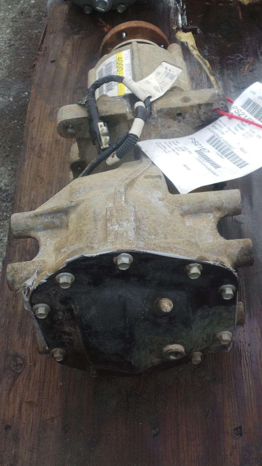

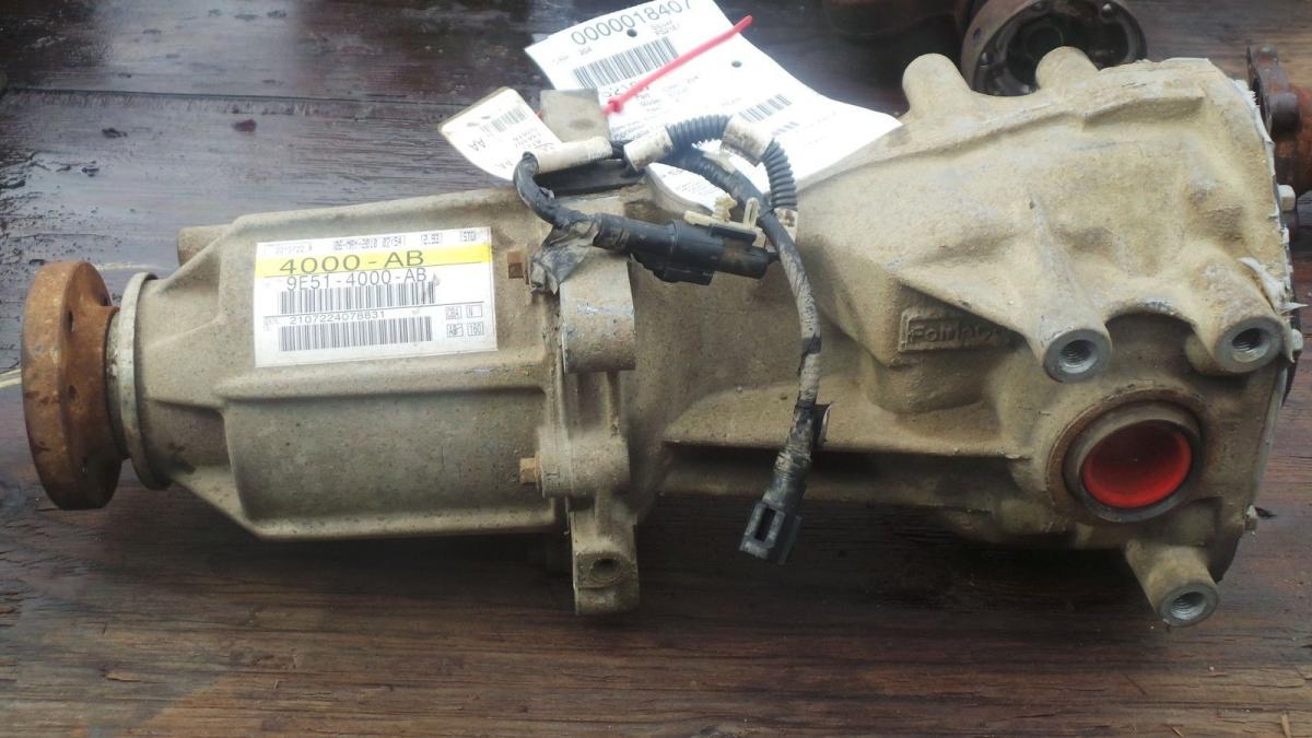

These are pics from the front of the car, right, not the back? That cover looks like it might be for the RDU? PTU fluid has a distinctively nasty smell, not sure about the RDU fluid. I'd tighten the vent back down, tape it up (to seal it), and degrease that area to see what's going on. But you may need to check the fluid/add fluid if it is an ongoing situation.
EDIT: You said you have powertrain warranty remaining? I believe any problems with the RDU should be covered under there.
Pics of the RDU courtesy of EBay

Thanks for your response. That makes more sense. The first and last pictures are taken from the rear and definitely seem to be the RDU. The middle two are taken from the front of the rear driver's side axle (may have the wrong term here, but it's going straight out to the wheel).
The RDU fluid would match with this thread http://www.fordedgeforum.com/topic/17225-2012-rear-differential-leakagain/ and TSB 14-0057 about the RDU vent leaking in cold weather. Still a little concerned about the driver's side axle though, might stop by the dealer later this week. Still have 7year/100k miles extended powertrain warranty and RDU should be covered.
