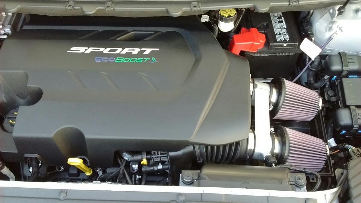

  • I have also fabricated a Duel K&N intake with sensor if anyone wants one . I can make one for your 2015 to 2017 Edge Sport. Contact me for a hook up.
That intake pulls hot under-hood air, and uses oiled filters. Both are No-No's. Bare minimum it needs a plate to separate from the engine heat that at least tries to seal to the hood.
I am very happy with the performance of my intake . The oiled filter is not a problem as I have run one for thousands of miles with not one speck of oil or dirt in the intake runners. No problems with sensors, no problems with oil covering anything. Over oiling a filter can cause problems, but I have never seen what you refer to in thousands of miles of real world driving. As for hot air from under the hood , the filters sit in the bottom of the intake box next to the stock air intake . So they do recieve fresh cold air, they also suck in air from under the hood as you say. But in a turbo car the air is compressed and heats up anyway and then the hot compressed air is sent through a heat exchanger intercooler and the intake charge is then cooled before combustion. I understand what you are saying but this set up works great and IMHO looks great also.
FWIW, the OEM intake is a WARM AIR INTAKE in the 15+ SPORT, This open filter setup only yields slightly higher temps while driving. Of course at idle the temps are higher than normal, but while driving there is barely any difference, I tested this out for almost a month.
As in you ran without any type of separation between the engine, and the filters, like he is? If so, how did you test it? You measure IAT under both circumstances with similar ambient temps and humidity?
I live in Hawaii, we don't have humidity and temp doesn't change that much outside. But yes, ran basically the same concept. Open filter in the bay and through datalogging and my dash mounted SCT X4, no IAT temps really change much and this is while doing 6plus straight hours while driving for Lyft. The OEM intake draws in air from a blocked/sealed off portion from the grille, it does not get direct airflow but simple air that finds it's way into the space.
Nick, thanks for doing real world Data Logging! That is real data!
Well that is REALLY good info. Bad for performance in general, but good for people with open boxes. I guess I can take back the fact that it would be different. It is for a shitty reason though. It is because our stock box and air inlet is crap!
yes the stock setup is utterly horrible. I think fords theory on the edge since room is so tight was that, it doesn't matter it's going through the Intercooler, but man if you were getting the coolest air possible to the IC it's less work!
