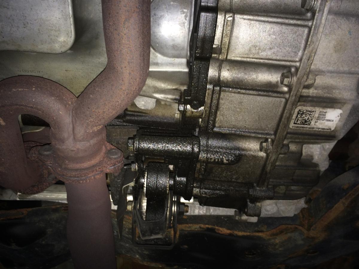

What is leaking in these pictures?
Many of the folks here on the forum are more mechanically inclined than I am. While doing an oil change I noticed the back of the trans on my 98k mile 2007 3.5 AWD looks very wet. The first picture is from the front underside of the car looking rearward and the second picture is a close up of the rear engine/trans mount. I checked the trans fluid after the car had been parked overnight and it is near max on the stick and very red in color. I noticed the car now has a slight vibration. Any idea what this is? It looks like a lot of fluid, is it possibly just condensation from the A/C unit?

It does look like an engine oil leak, like mac said. So try a good High Mileage motor oil. Should state clearly on the label that it has seal swellers. If you like, clean the area first with engine cleaner to observe current behavior. Doesn't look like an old/past issue, but it might be.

Some of that oil must be landing on the exhaust pipe, and with no airflow (i.e. idling), the pipe gets hot enough to burn it off.
If it's labeled as a High Mileage oil, it more than likely has seal conditioners listed on the label, as for Mobil 1:

Switch to a full synth HM oil, that should help. Also, if you have not done the PCV valve/spark plugs yet, now is a good time to do so. If the valve is blocked partially or completely, it will increase backpressure in the engine leading to leaks at the most vulnerable point.

First the oil - Just change the oil at your next interval with a high mileage oil. I used Mobile One, but you can go with your preference.
The smell may be from your PTU? Akirby/WWW? it can drip and cause the burning smell. You may wish to flush the PTU and reintroduce new oil/lube into the PTU.

PTU: This is what I dread being the most. The staining/wetness on the bottom of the car doesnt appear to be brown. Are there any good picture tutorials on how to check or refill the PTU? Looking under the car it looks like the exhaust will make working on the PTU difficult.

PTU: Do you have a garage or a driveway where you can see any leaks from the PTU? You'd definitely need to look closely to see if there are any leaks from the trans-PTU seal or from the PTU vent itself. PTU fluid smells nasty when new, and even worse as it gets used up, so if you see a smear on the PTU (passenger side of the Edge), it's worth the finger touch&smell test.

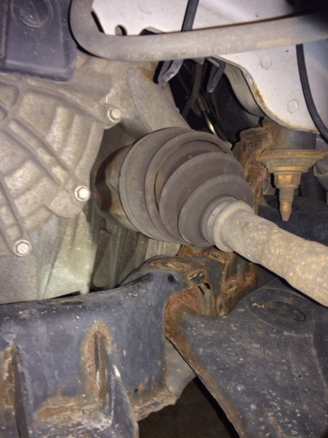

When I hit bumps the front driver wheel will sometimes create a shudder. I removed the wheel and the tie-rod and ball joints look okay. I did notice a leak where the drive side axle inserts into the transmission (see first picture). Could this be the source of the shudder sound whenever hitting a bump?

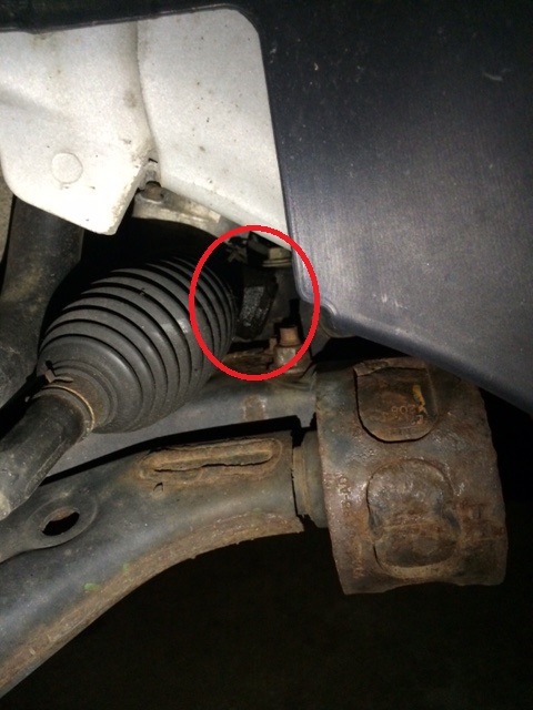

Additionally part of the steering rack looks wet (second picture) but I assume this is from the oil leak mentioned earlier. Finally, I noticed the tires have a rib that extends sideways between the grooves (third picture). The tire appears to have some life left but where this rib occurs the depth is very little. Do most tires have this ribbing? Is it time to replace the tires?

Not sure on the axle leak, possibly a seal issue, possibly an axle issue. That is, the rubber seal could be bad, OR the metal of the axle shaft could be pitted or scored, causing the seal to fail.

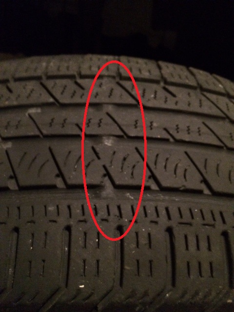

I see cracking in the nontread area of the tire, plus the whitish pastches look like the belts are starting to get exposed, but IDK. Are these tires original to the vehicle? Is there low tread depth remaining? If so, time to look for replacements.
Just a note on the leaks. I know this will be hard to do, but do not concentrate on them. Until you are having to replace fluids due to the leaks the repair costs will far outweigh the benefit. My Orange Crush leaked, had leaks and seeped and I never had to add fluid until the power steering hose failed. Same with the axle seal and oil main seal. I recommend working on your maintenance items, changing fluids, spark plugs and getting the struts replaced. Then re-evaluate and keep driving.
