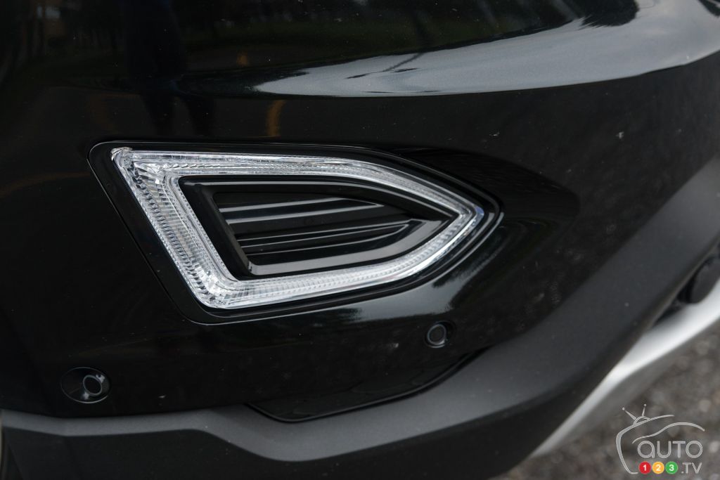

Hey all,
I am wondering if someone installed OEM/after market lights on the front bumper of the 2015 Edge SE model. SE trim doesn't have the lights on it from Factory. I want to know if there is wiring already in-place to hook up those lights or no wiring on the SE trim? Any information would be appreciated.

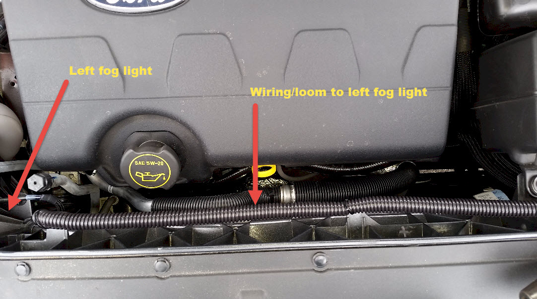

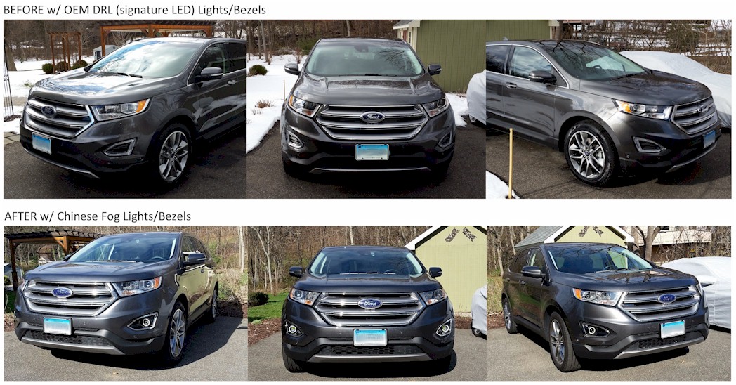

Ok... Replying to my own post about removing the OEM DRL (signature LED) lights/bezels.  Well, after investigating this on my own, I decided to take my 2016 Edge Titanium to a local body shop.  The end result was that they had to remove the whole front fascia (dozens of screws, clips, etc.) to get to the screws and clips that held the OEM bezels in place.  I replaced the OEM bezels with "direct fit" or so they said, Chinese bezels with LED fog lights for about $120.  Warning... they were not a "direct fit," at least not on a 2016 U.S. version Edge.  While they did pretty much fit in the fascia openings, the clips on the Chinese bezels did not line up with the former OEM clip locations.  In additional, we had to "think outside the box" and trim some of the interior plastic to allow for the fog lights to fit properly.  We were able to hold the new bezels in with 3 screws each from the inside.  In the end, as you can see, it worked out and they look great, but it took more work than anticipated.  The body shop guys were great and only charged me $150 to do the work.

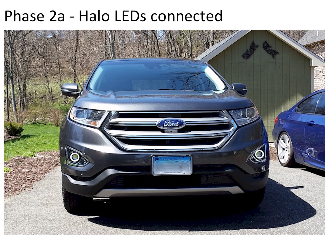

Follow-up to my previous post... Phase 2a - Connecting the halo LEDs on the fog light completed.  Removed the headlights to access the wiring and simply attached the positive and negative wires from the LEDs to the respective wires on the OEM signature light harness and they work!  Phase 2b will be to connect the fog lights, which will require a bit more work.  I purchased a fog light wiring kit with a relay, wired switch, and all the necessary cabling.  I have to find a way through the firewall though.  Any ideas are welcomed!  Another thought would be to find a wiring kit with a remote (wireless) switch, but not sure if one exists.

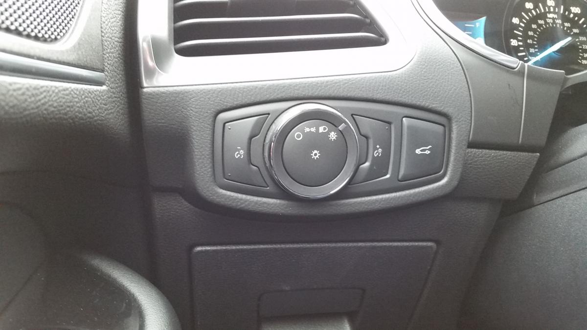

Posted 22 April 2016 - 02:53 PM
Great thought; however, it looks like the ones you linked to are for the Focus/Mustang and the ones in the Edge are different (see photo).  I will check to see if the Chinese Edge OEM controller is available somewhere.  Thanks though!

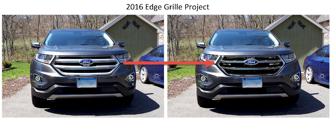

Next project: Change the "brushed aluminum" - looking parts on the grille of my 2016 Edge Titanium to gloss black to match the new chrome/gloss black fog light bezels.  The photo prototype is below.  My plan is to use gloss black automotive vinyl wrap, leaving the chrome parts exposed.  Cost is expected to be around $20.  Will have to evaluate whether I can do it with the grille installed or if I have to remove the grille, which will be more complicated.  Hoping this will give my Edge a more aggressive look, without changing it to the Sport grille ($600+).
