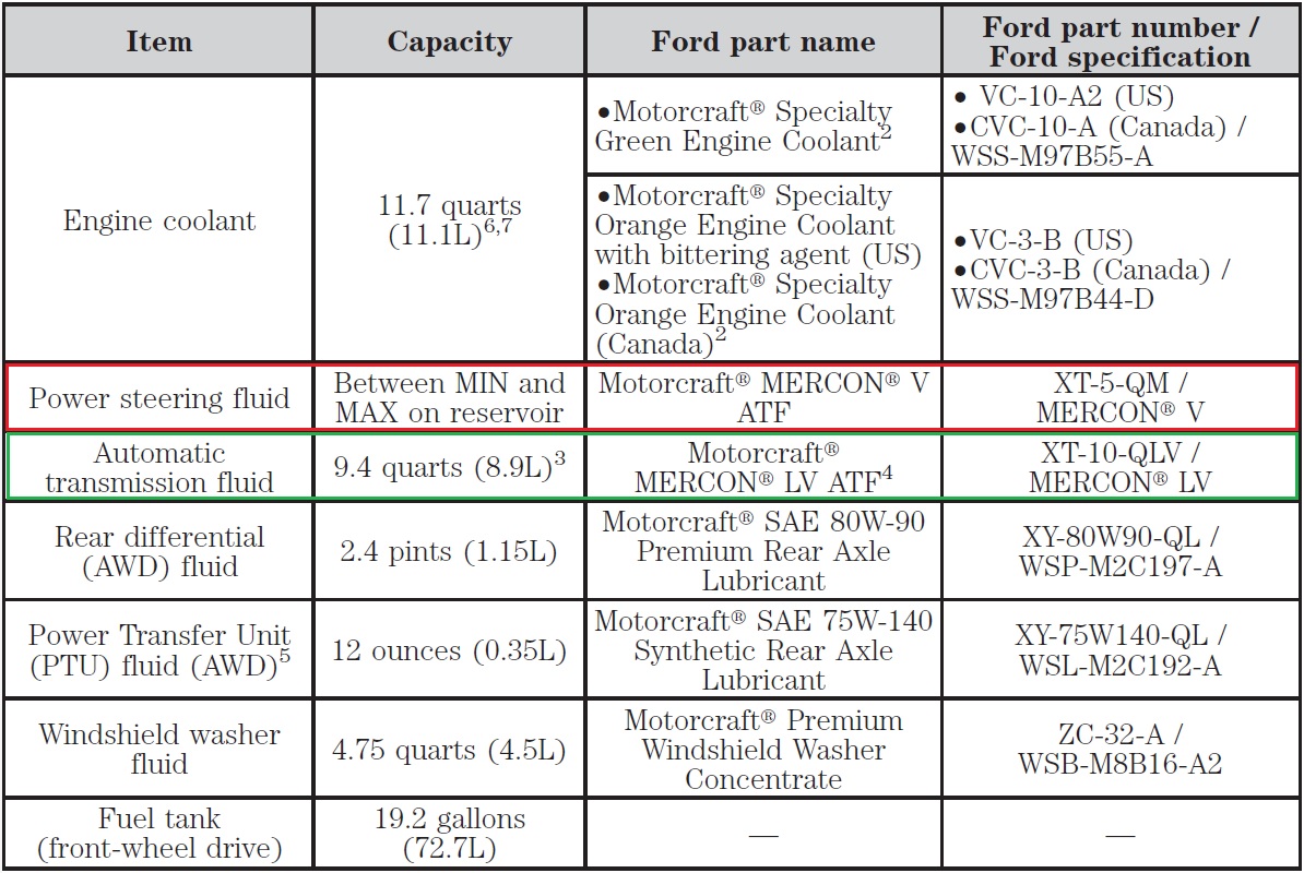

Hate to tell you this, but in 2010, the Edge switched over to using Mercon LV, not Mercon V. For whatever reason, they chose not to wait till 2011 to make this major change. The LV spec fluid is relatively thinner, so basically on V, the trans is "choking" IMHO.
So dump out the mercon V, put in mercon LV and see if that resolves the problem. The POWER STEERING still uses Mercon V, FYI.
