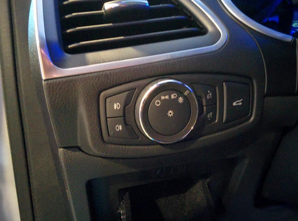

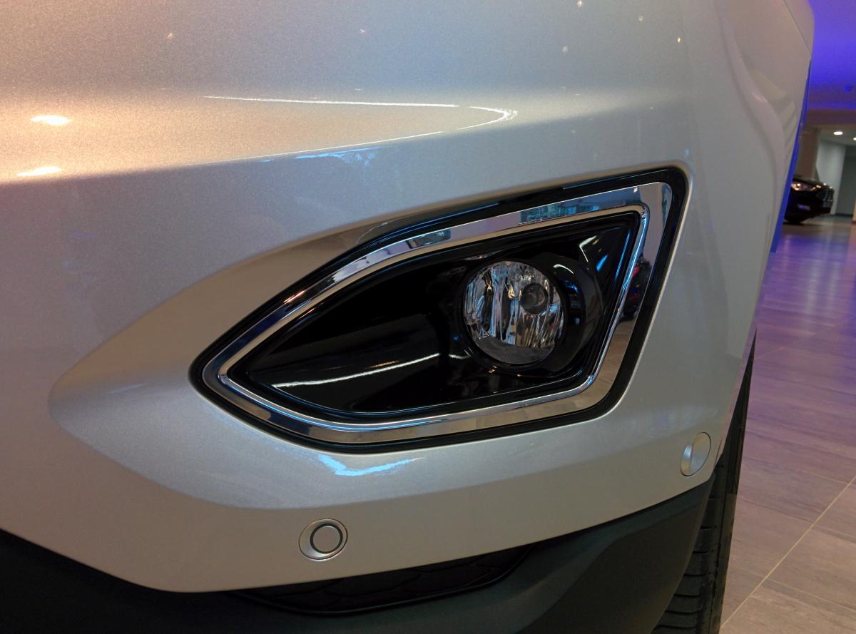

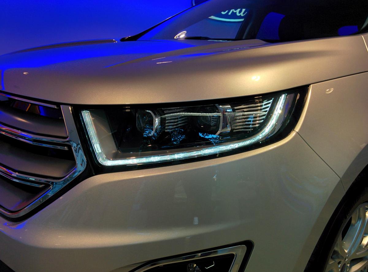

I'm in Barcelona at the moment. I decided to stop by a Ford dealer to see what the euro-edges are like with regards to differences in features or styling.
I noticed that they have standard foglights front and back with the halo around the headlamps rather than down low on the bumper as my Canadian spec 2016 edge titanium.
Here's a pic of the headlight switch assembly that includes the front and rear fogs.
