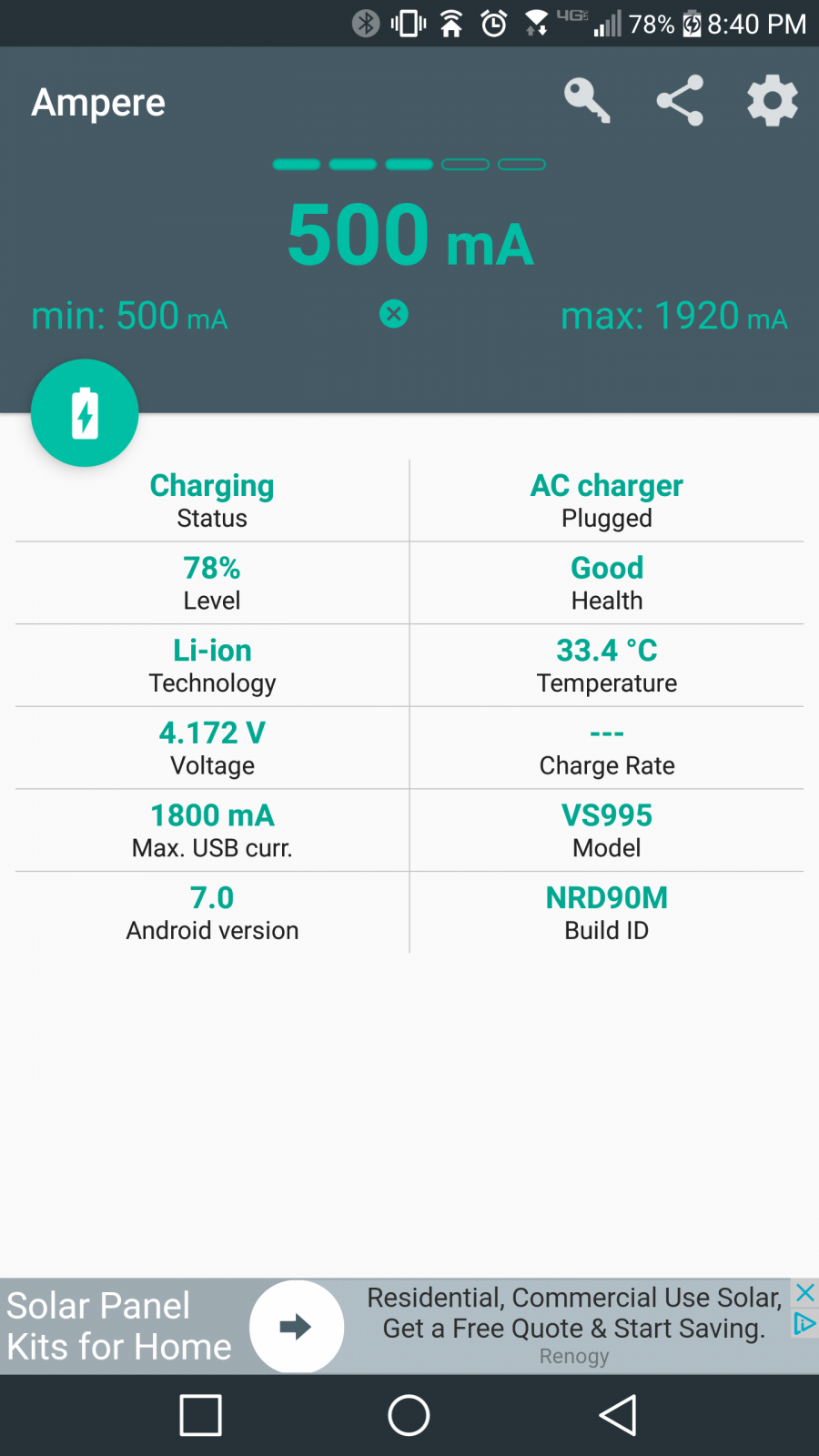

2nd Edit: Lildisco get Ampere to see what your device is charging at. https://play.google.com/store/apps/details?id=com.gombosdev.ampere&hl=en

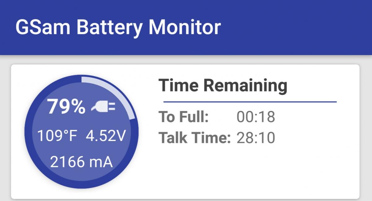

Screen goes black & Says Android Auto in white letters. Assuming that you're interested in this. Using the OEM home charger that came with the phone:
I'm more interested in your discharge rate, also when it goes black and says the letters the screen then after like 10 seconds just shuts off right and the phone sleeps while using AA? That is a pretty high charge rate if accurate though, I hit about 1920mA with the screen off (won't charge that quick with screen on as designed).
Edited by rvcjew
That is a RIDICULOUS discharge rate for the screen not being on. Again, I run 3 relatively power hungry apps almost everyday coming home from work on my iPhone 7, and I will gain 20%+ on my battery in my 30 minutes drive plugged in to the cars hub. Sadly, which TRULY annoys me about iOS, I cannot see discharge. But I use the USB inline power meter, and my phone typically charges at about a 1.6A draw. Sometime higher, but only when the phones battery is really low, say 20% or below. At 1.6A I am running 3 heavy Power apps(Maps, Pandora, and Dash Command), all with the screen lit(I use a ProClip mount). What is running on ya'lls phones to cause that discharge rate?
No, that is the charge rate with screen off. My discharge is normally with screen on at around 150mA with 3 emails and some other push stuff. Also I read Lildiscos charge rate as 3xxx not 2xxx so their charge rate is fine but I'm wondering if aa is not letting their phone go in a low power STATE or if they have some kinda wack add app in the back ground. I agree a car ride may not charge the turbos battery (3900mah) all the way but should not discharge it.
Malcolm
Malcolm
OK, That makes a little more sense. Agree, something is not right. Would love to get an inline meter on his phone and see the real numbers, not what the phone is telling.

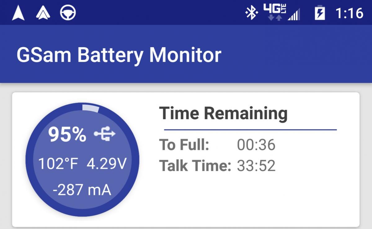

Just did some short errands today, (wife shopping). Getting ready for the return trip home tomorrow. Don't know if these will help. It seems to have kept the phone charged when at 100% and possibly charged it 1-2 % during 10-20 minute drives.
Both USB ports did work for Android Auto as well. Possibly i haven't given it enough time to charge as most of my trips have been under 30 minutes since 2.2 has been installed.
Here's some screen shots
Looks like it's operating properly yeah. I will look at what mine gets next time I use AA.
