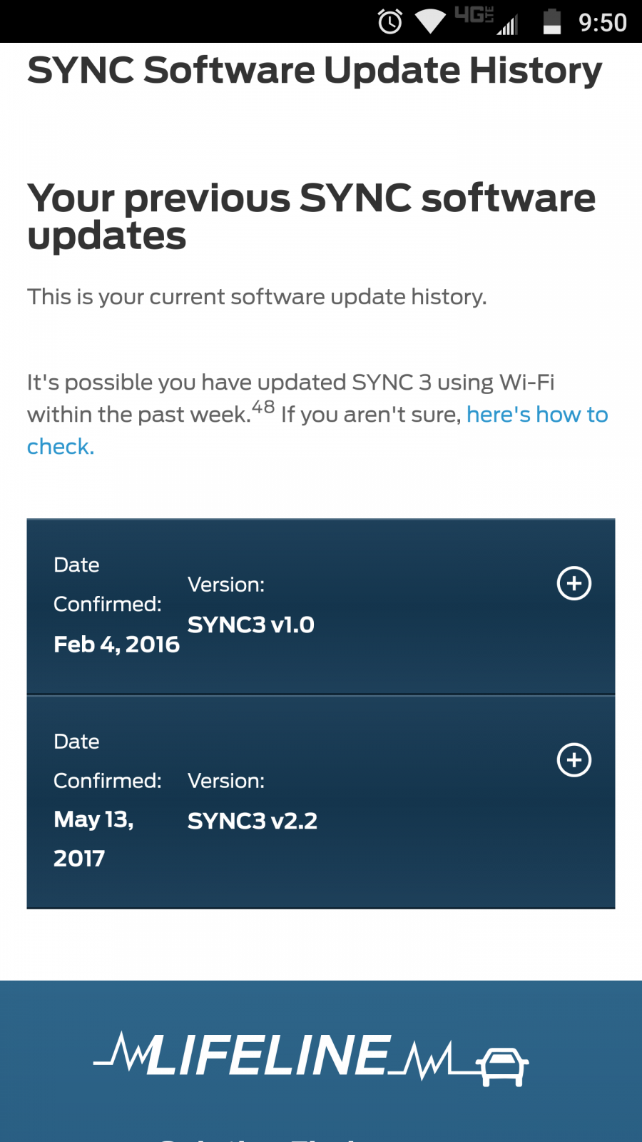

Successfully updated from1.0 to 2,2 with no problems. on the restart I had to finally do a second restart before the maps would load. When I tried to upload the verification file to owner.ford.com I received an error several times and am still waiting for an answer on that. All functions work and Carplay worked fine as soon as I installed the new hub I removed the side trim to allow me to reach the tabs and did the update with minor issues. I didn't need to use the safety string on the connectors, but definitely think it is a good idea to tie them off to prevent loosing them in the console. I'll update if I get an answer on the confirm step. The upload placed the file in a root folder called C:/fakepath which I couldn't find.
