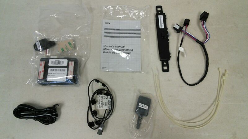

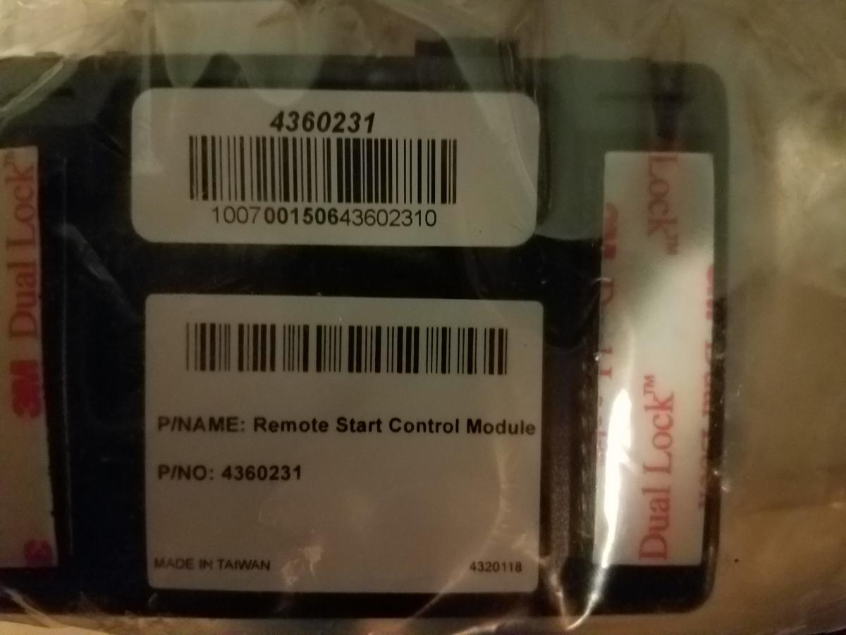

Here's a picture of what I bought. And a picture of the back of the module. I think it is listed as being for a 2011 but I seen on a ford accessories site this part # should fit a 2013 also. Just no vss. I think.Attached File  $_3.JPG   46.59KB   0 downloadsAttached File  20161215_050956.jpg   72.27KB   0 downloads

#14 OFFLINE   candurin
candurin
    Ford Edge Enthusiast
  • Edge Member
  • 1,073 posts
  • Region:Decline
  • Location:Southern NJ
Posted 20 December 2016 - 02:27 PM
It should install the same...
