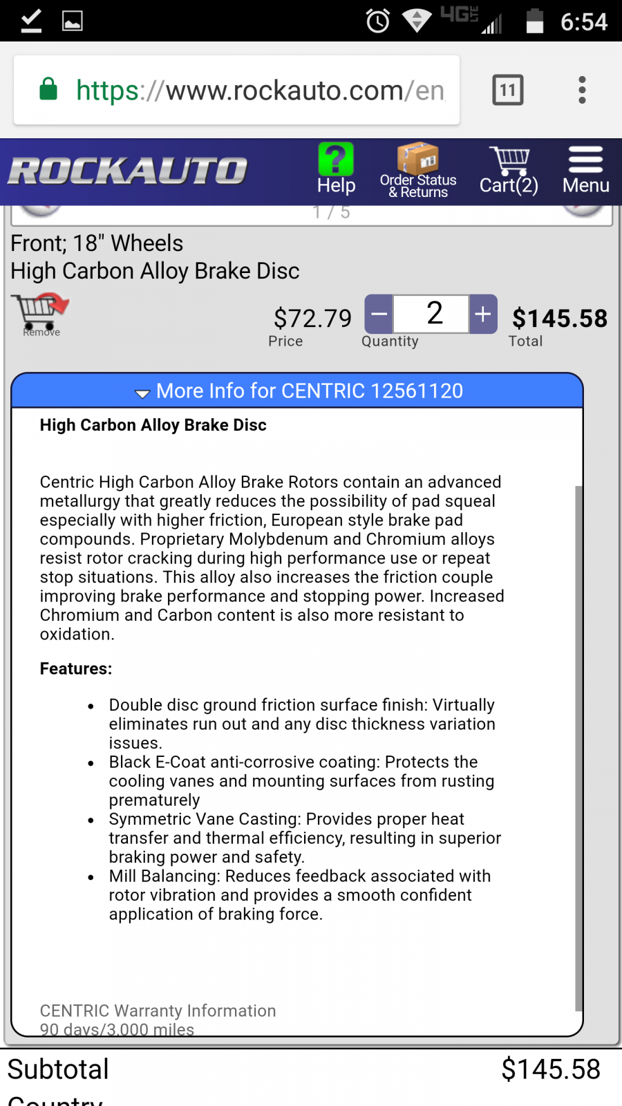

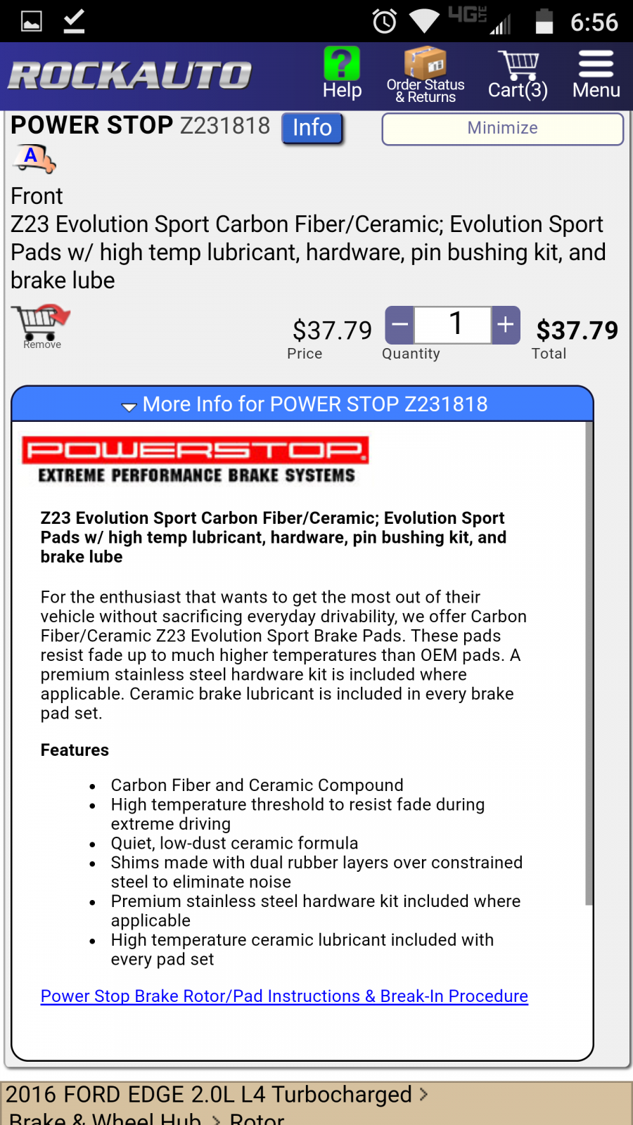

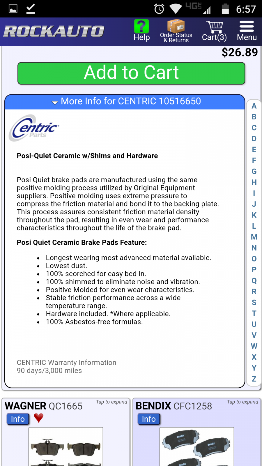

I think that I'm going with Centric Rotors (12561118) for the fronts & Powerstop pads (Z231818) for the fronts as well. Thoughts?
Centric also makes a pad (10516650). Any have any experience with them? Looking for the same, if not better, than OEM
EDIT:
12561118 Is the correct part # for a non Sport Edge. 12561120 'appears' to be for a Edge Sport(Didn't know anybody around to confirm). IF YOU ARE NOT A SPORT, ORDER CENTRIC PART# 12561118

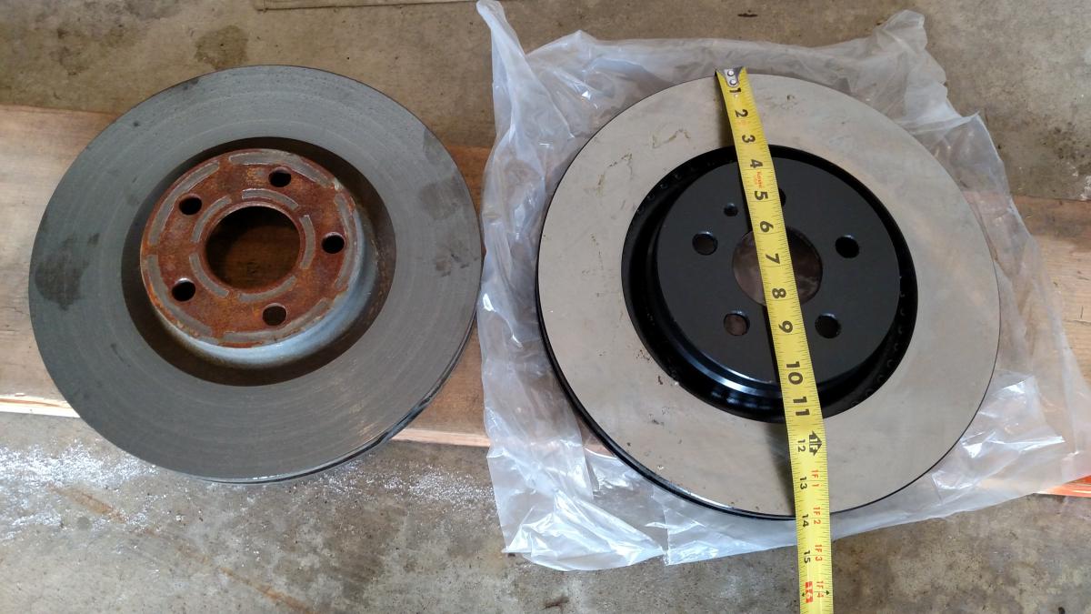

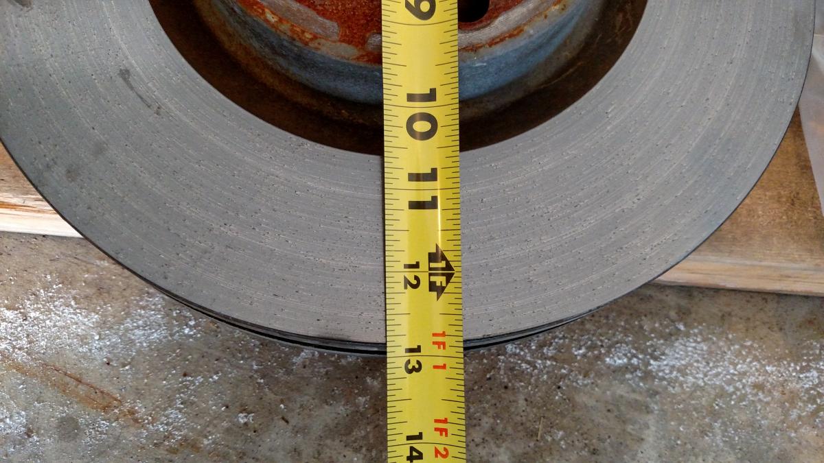

Rotors arrived today, unfortunately, they're too big, even though it says for 18 inch wheels. I quickly ordered Centric 12561118 rotors, they were slightly cheaper than the other ones.
Called a few friends & they said that it shouldn't be an issue to use the new pads on the old, factory rotors. I'm obviously going swap them out whenever the replacement rotors get here & re preform the pad bedding procedure.

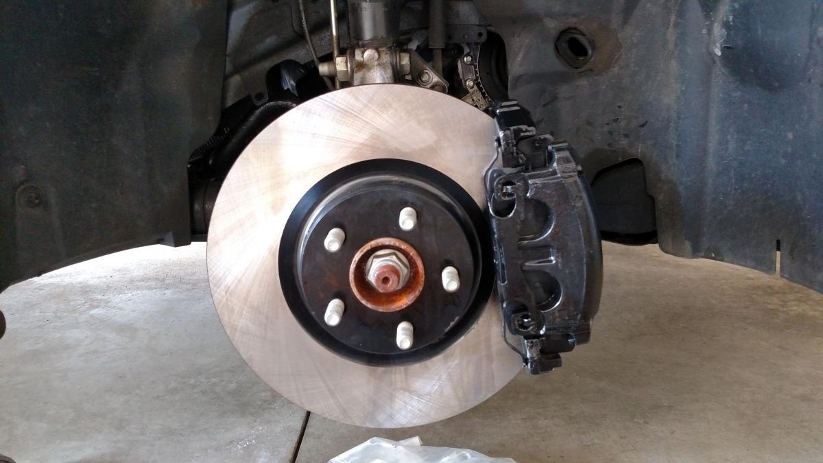

Posted 01 June 2017 - 09:18 PM
Actually, no grabbiness to be had. The pads have performed as good if not better than the oems. There was the occasional grabbiness with all OEM stuff. In 6 days of driving, the wife hasn't said anything about grabbing. The handful of times I've driven it, it seems to brake like a normal vehicle.
The Centric Rotors were delivered today & promptly installed this evening. Cleaned everything up with brake cleaner & bedded the pads. We'll see in the coming weeks if braking has 'improved', but so far, we have far less brake dust

Centric Posi-Quiet pads part #10516650 were installed tonight on the rears. Less than $35 shipped for the pads. Didn't change the rotors, so hopefully won't have any issues later on.
