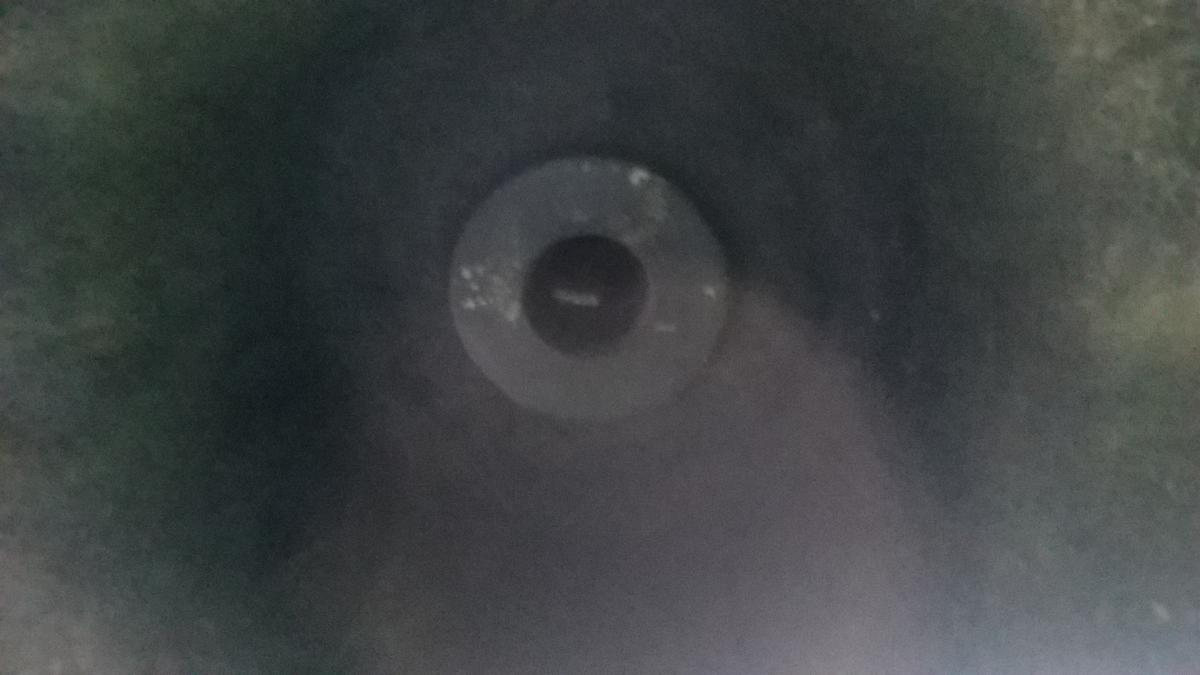

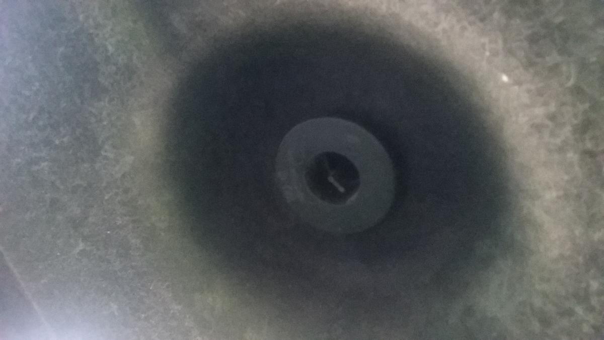

Hi to all,
The noise seems to come from the downside of the car. I have tried even to close the external rear mirrors, nothing changes. At a first inspection down the car, seems that there is a big central cover locked to the car frame using some clips like the one's I attached in the picture. Some of these seems to be loosened. If I move them, they makes a "plastic" sound, like the one I can heard in the car. The cover have a large aperture in the carfront and I supspect that, when the air flow into the cover, this start to move and the plastic clips produce the rattling, higher is the speed more is the noise I can hear.
Does know anyone how to fix those plastic clips ?
Thanks a lot.

Try removing and reattaching them (the center usually either pops out or in to loosen them) or just replace them.  Pretty cheap and easy either way.

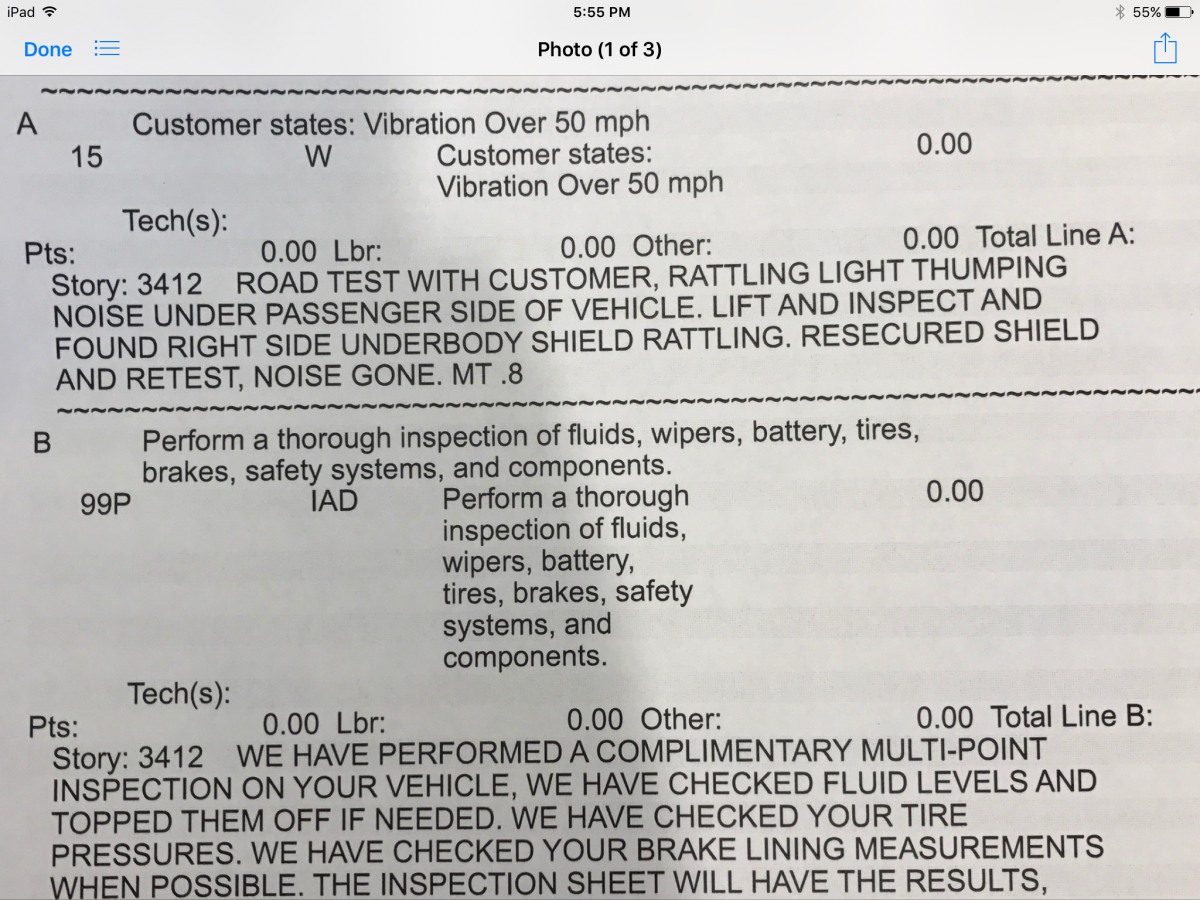

Had that exact noise. Two trips to the dealer and they couldn't find it. Finally on the third visit, they figured it out. Here is the service report. It is loose under body shielding. Noise is gone.

Post #5 shows you the plastic "buttons" underneath the car that rattle at higher speeds (usually 45mph or above)
The quickest way to solve it is to stick something between the button, and the bottom cover. I used a thick tie wrap (zip tie) and cut a small piece and stuck it in there. Then I found a better solution...
An old metal hanger, or some insulated wire (like a 14ga wire from a car stereo. cut a piece about 1" long, and bend it around the "button. It'll fill the small gap, and hold it in place better to stop the rattle.  I may have to get under there and post the video to show what I mean
