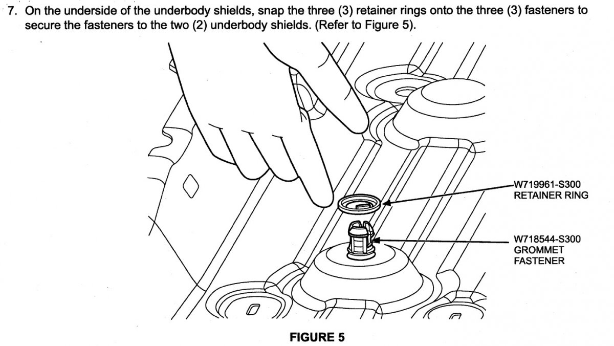

Watched you video - my personal opinion is that the flutter will return pretty early using this method.
On yours the ring is not locked onto the clip that has the foam washer keeping some compression on it, and this can only be done with it completely removed from the vehicle.
The image attached shows the step that is virtually impossible to accomplish without removing the shield from the vehicle.
Edited by 1004ron
From what I could tell by the design of the retainer there really was no way to get it seated any further, and I would have thought that pushing it against the vehicle that the amount of pressure required would lock anything that could potentially be loose. If it does come back I will post and do the repair again, but today there were huge crosswinds and there was no sound to speak of.
My comment is based on how tricky it was to get that Retainer Ring fully seated with the shield off the car - as you say, it may have seated and you'll know some time down the road, but then again I used the same kit on mine and its vibrating again.
