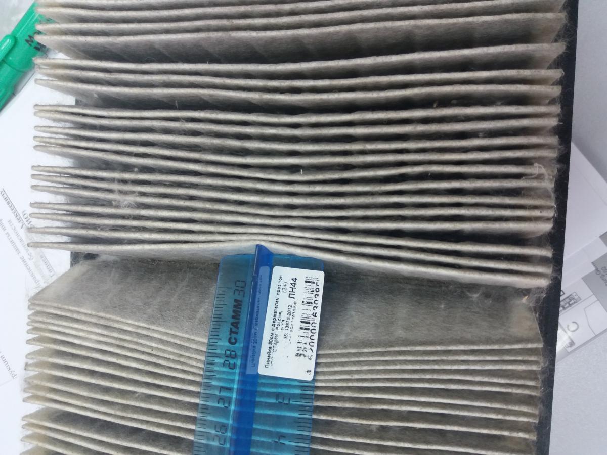

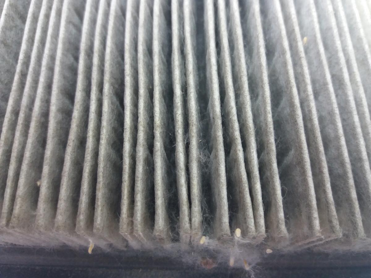

It seems to me, I dealt with a problem. Everything was normalized after changeover of the air filter, it was quite well hammered with poplar down which I already mentioned earlier. a week ago we finished a season of flight of poplar down. Yesterday I replaced the air filter and today of driving gives me confidence to think that everything was normalized. I still will watch several days and if everything is also well I will tell you. But I am very grateful for the given help, it is invaluable information. If everything is also good, I will make survey for prevention of the mass air flow sensor and the sensor of an acceleration under a brake pedal to estimate their condition. I will attach the image of the hammered air filter.
