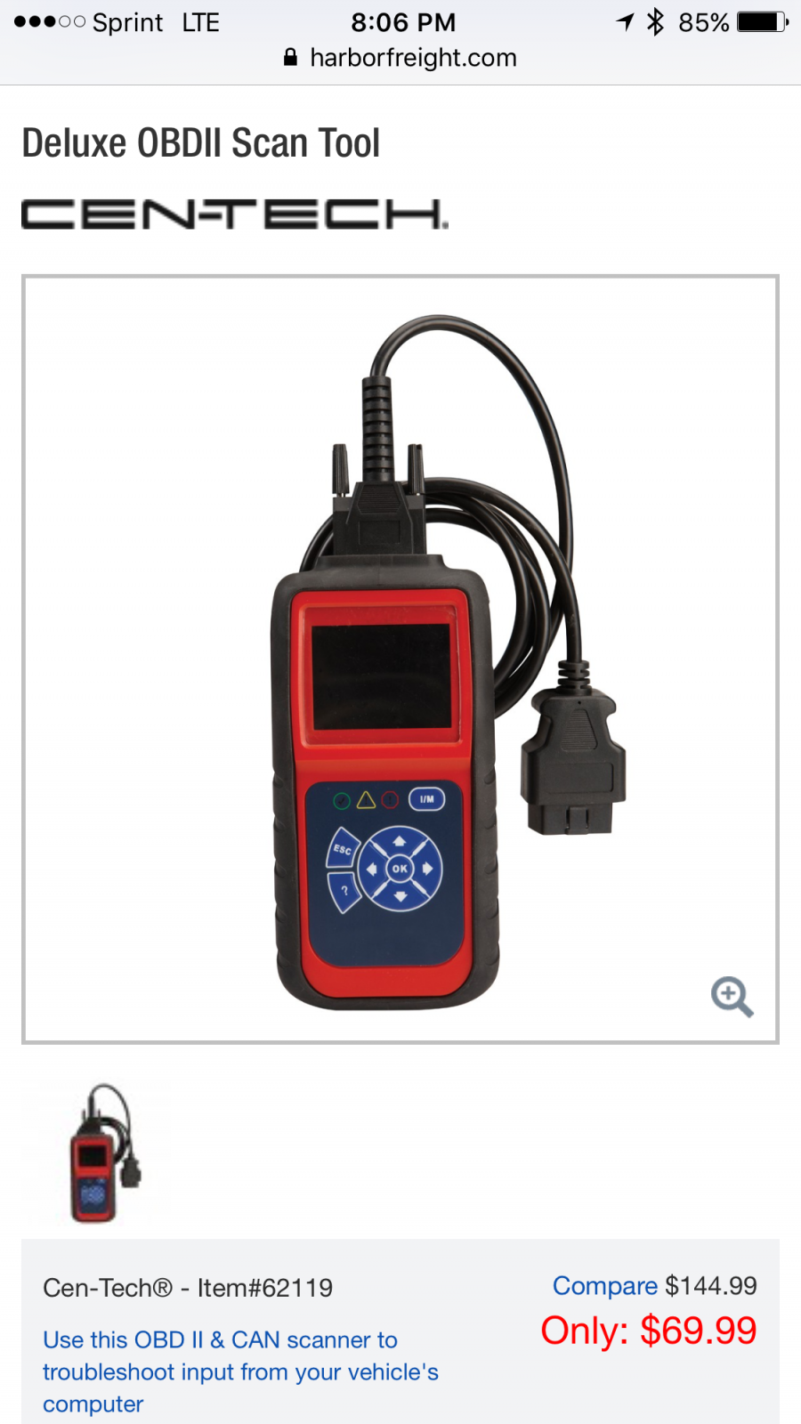

Going to have to have a scanner to get this working maybe even Ford involvement for programing
