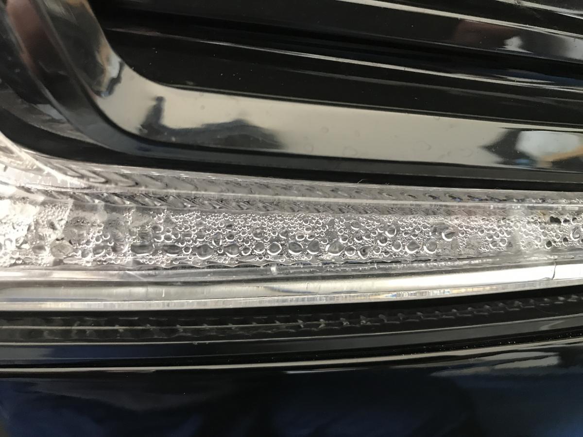

They repainted the complete front bumper and there's no sign of peeling, but there about five very small pock marks in different places on the bumper, and water in the right side DRL.
I'll live with the hardly noticeable blemishes - I don't know how they prepped it, so hoping it doesn't peel again.
I pointed out the water to them and they said it should go away, but if not to return for it to be repaired.
The water is still in the light after a 30 minute drive at 70mph in 90 degF ambient, so not looking like its going anywhere.

Took off work early today to stop in at Ford's Collision Centre for them to "fix" the water in the LED DRL which I was told would take about 30 minutes.
The supervisor takes it around the building and returns with it 10 minutes later only to explain that its a sealed unit and he needs to order a new one, and when it arrives he'll need the vehicle for half a day, so looks like more time off work and a rental car.
Got a call that the LED light arrived and was told that there's no rental car for this time because the job will take only 4 hours.
I can use their shuttle which doesn't go as far as my work, or wait while the job is done - more time off work for me.
Very poor that they called me to collect when they knew there was a defect, instead of keeping the vehicle until it was complete - the water in the sealed LED was not there before they did the bumper work.
Makes you question who did the inspection and why they didn't see it. or did they think I might not be that observant - it didn't take me long to point it out when I collected the vehicle.
The water in the LED and the 5 places where I can see blemishes in the paint will mean a one star review and I'll be looking to get any future work and services done elsewhere.

New light installed in less than an hour while I waited this afternoon.
The supervisor showed me the old light and the seal looked good on it and no sign of damage.
It seems like he was informed of my review, because he was trying to make excuses why he didn't see it prior to calling me to collect.
Edited by 1004ron
More than likely he was being honest and trying to take care of you. As these lights are closed fairly tightly, it would be my guess that a small amount of water was alreay present in the fixture (in liquid form) and turned into a vapor mist when they ran the car through the paint drying booth. The heat from the heat lamps turned the water into vapor and it condensed on the plastic lens, as it was a cooler surface (exposed to the direct outside cooler air).
