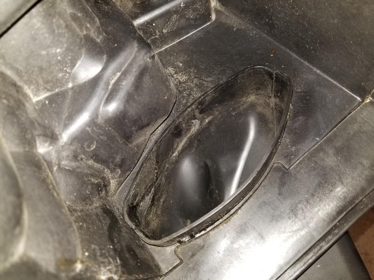

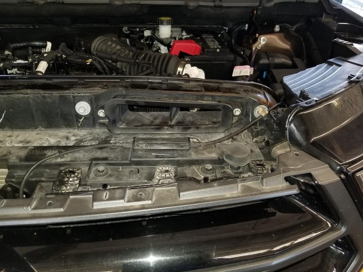

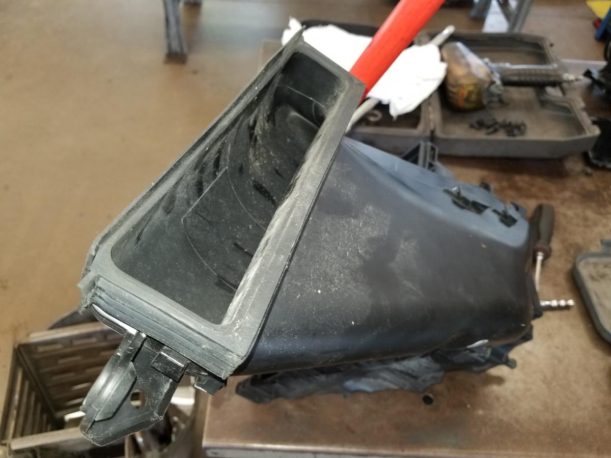

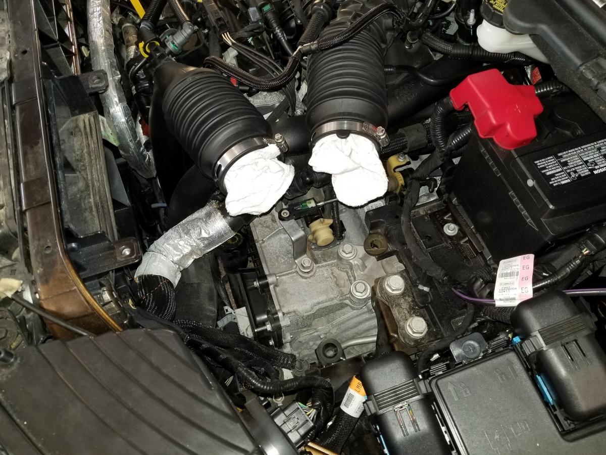

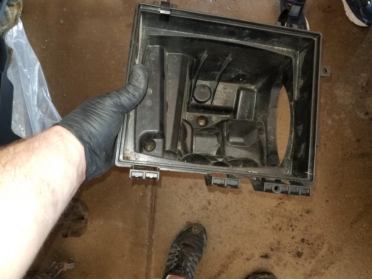

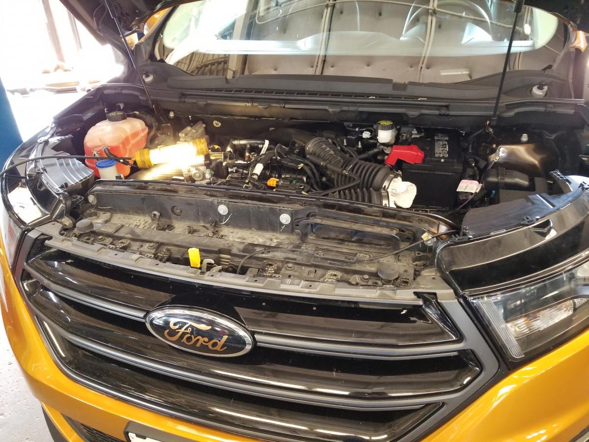

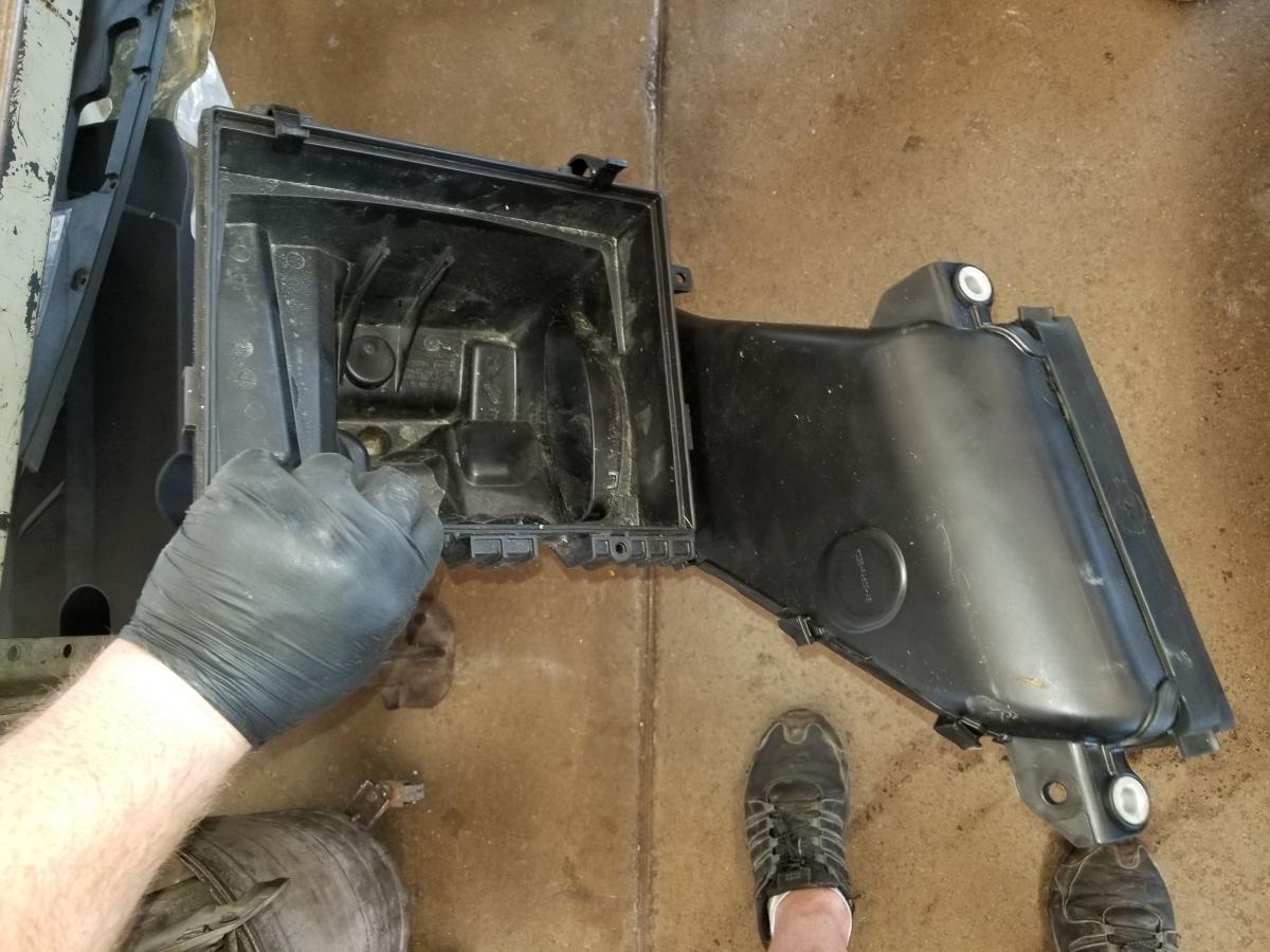

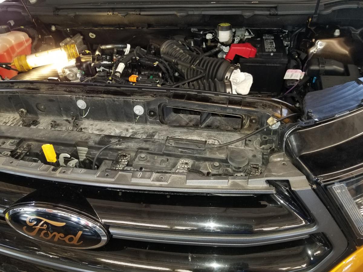

So far we've done an R&D tear down & here R the initial research Pics... :camera:
Note: This is going 2 take some time, if it works at all, so B patient peeps, we do have full time jobs & this isn't it... :salute:

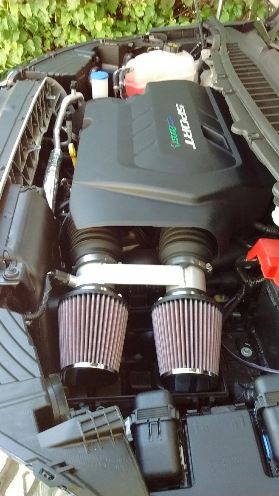

I think you are talking about something like this? post-46130-0-67114700-1506825177_thumb.jpg I built this first before the hack.
Trouble was the under hood air temp is off the chart. It was a big fail and I had to return back to the stock configuration.

Yes that is exactly what I am talking about! Looks great... have you tried it again since the hack or do you think it will need an upgraded FMIC?

Thanks, it may look good but it was a dud, and there is no need to try it again. . What is a FMIC? As for the intake temperature , I have no idea before or after the hack.

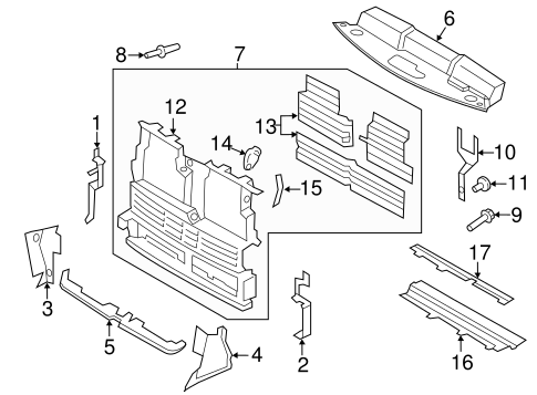

Right, and I was trying to figure out if that cut part was a $30 part or a $300 part lol
The modified part could be the Air Deflector Housing Part # 12, $143 at Tasca ( not sure ). It may not cost that much but replacing it is a big job. The labor will eclipse the cost of the part by far.

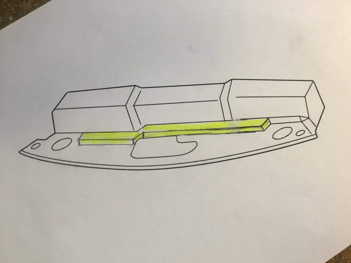

I believe it is possible to increase the air flow from right to left by modifying the Sight Shield. Part# - Ford (FT4Z-16A238-A) $50.97 at Tasca. A side effect of adding space above the radiator besides more air flow from right to left is bit cooler air. My drafting skills are not that good but you should get the idea. The raised area should be almost straight with a slight curve. Not like the drawing. I have not worked out the  exact dimensions of the raised area yet, but have determined that there is some room to do this. Just guessing here around 3/8 inch tall X 1 inch or so wide. Properly done it would complement the mods I have already done. Basically just expand and extend the hump on the drivers side all the way across . See photo on page 1 of this thread named ( Job Done ).
