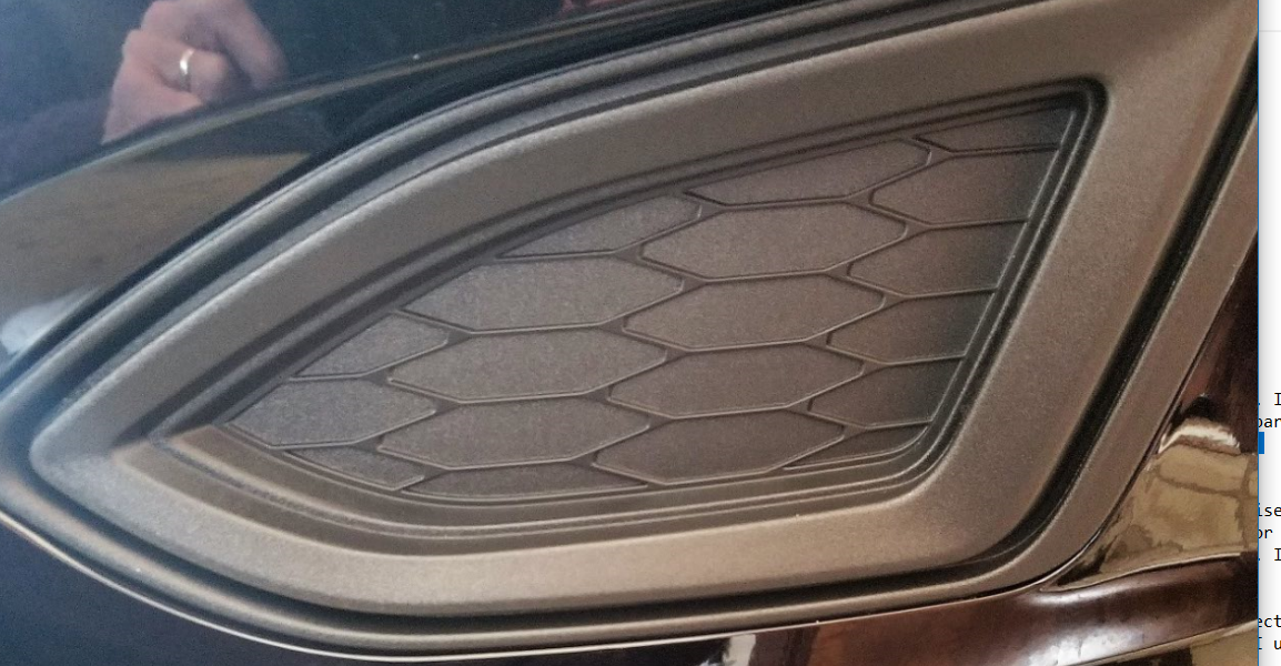

Sichuan Posted December 1, 2017 Report Share Posted December 1, 2017 Changed my DRLs today and they matched up really well. It looks better in person than in the pictures. Hello 15FireSport. What year is your Edge? I have a 2017 Edge SE that did not come equipped with the lights that are just above the front bumper. What are these lights called. I assumed that they were the DRL lights but apparently I am incorrect. My local Ford dealer has informed me that Ford does not provide these bottom located lights as an aftermarket kit or as individual items. Did your Edge come equipped with them? If not, where did you get them? If you installed them after the purchase of your Edge do these bottom lights contain only the LED lamps on the perimeter of the lights or do they also include the round "fog lights". Thank you in advance for your time and any assistance provided. Also, I want to thank anyone else who posts a reply. Quote Link to comment Share on other sites More sharing options...

roots57 Posted December 4, 2017 Report Share Posted December 4, 2017 Hello 15FireSport. What year is your Edge? I have a 2017 Edge SE that did not come equipped with the lights that are just above the front bumper. What are these lights called. I assumed that they were the DRL lights but apparently I am incorrect. My local Ford dealer has informed me that Ford does not provide these bottom located lights as an aftermarket kit or as individual items. Did your Edge come equipped with them? If not, where did you get them? If you installed them after the purchase of your Edge do these bottom lights contain only the LED lamps on the perimeter of the lights or do they also include the round "fog lights". Thank you in advance for your time and any assistance provided. Also, I want to thank anyone else who posts a reply. 2017 Ford Edge DRL.PNG There are aftermarket versions of these lights you can but online, but because your car didn't come with them from the factory, you will need to wire them yourself. The Euro version of the Gen II Edge has an available option for round fog lights inside the LED triangles, there are also aftermarket versions of these that I've seen online. Quote Link to comment Share on other sites More sharing options...
Nick Halstead Posted December 4, 2017 Report Share Posted December 4, 2017 if you buy the cheap foglight shrouds/fogs on ebay/amazon that are all over the place for the Edge, just know, our North American Edge lacks the bracketry inside the bumper and it will be a full custom job. I have only upgraded my turn signals to LED and turned off the hyper blink via Forscan. I see no need to upgrade a bulb I have never turned on. Quote Link to comment Share on other sites More sharing options...
ONEDGE16 Posted December 5, 2017 Report Share Posted December 5, 2017 Hello 15FireSport. What year is your Edge? I have a 2017 Edge SE that did not come equipped with the lights that are just above the front bumper. What are these lights called. I assumed that they were the DRL lights but apparently I am incorrect. My local Ford dealer has informed me that Ford does not provide these bottom located lights as an aftermarket kit or as individual items. Did your Edge come equipped with them? If not, where did you get them? If you installed them after the purchase of your Edge do these bottom lights contain only the LED lamps on the perimeter of the lights or do they also include the round "fog lights". Thank you in advance for your time and any assistance provided. Also, I want to thank anyone else who posts a reply. 2017 Ford Edge DRL.PNG I believe you are looking for the signature LED lights (AKA lamp assembly - side marker) part number FT4Z-13200-F (right) and FT4Z-13200-E (left) Quote Link to comment Share on other sites More sharing options...
