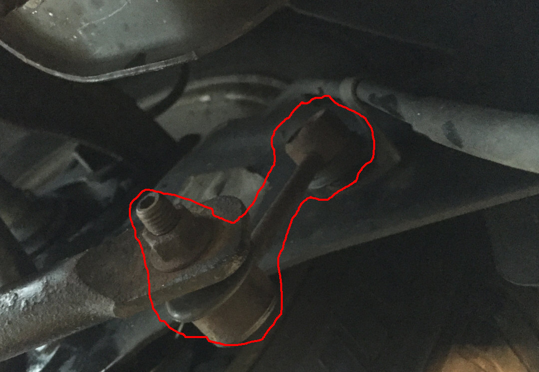

I think MACT gets the prize.  I got under the car again and had a friend bounce on it.  I could confirm it was coming from the back driver's side, but it was really hard to tell exactly what it was.  Finally I started grabbing things and moving them to see if that would identify the culprit.  It did.  MACT is calling it a "Rear Sway Bar Bushing".  RockAuto calls it a "Stablizer Bar Link".  I think they are one and the same.  See attached photo.  When I grab it and move it, that is my squeak.  Unfortunately I saw MACT's video on replacing this.  It looks like a huge pain.  Factor in that I don't have a place to get the Edge up on a hoist, I am thinking this will eventually have to go to my mechanic.  Again, see attached picture.

OK, I have resolved my squeak issue.  As I stated before the culprit was the rear sway bar link on the driver’s side.  As I also mentioned, I watched MACT’s video on replacing his front ones and it did not look like an easy job (he had to cut his out).  It was also mentioned that the rear ones may be easier then what MACT showed on the front ones.
Ok, remember, we are here to help each other and not judge and be critical of the poster….
I did some more googling and came across a YouTube video titled “Redneck Ball Joint Repair”.  Yup….
Basically this guy pokes a small hole in the ball joint rubber boot and fills it full of lithium grease from a spray can.  I have a spray can of lithium grease and I have an ice pick!
I didn’t even have to raise the car up at all.  I just put my shop light under it and crawled under it with my ice pick in one hand and lithium spray can with red extension tube in the other.  I poked the holes in the top and bottom rubber boots, filled them up and I was done.  Maybe 10 minutes total time and $0.00 cost.
I got out from under it and a few bounces on the rear bumper and the squeak was gone!  I then drove about 15 miles towing a trailer going over many bumps.  No squeak.  I got home and bounced the back.  No noise at all.
I realize this is not a permanent fix, however, I am no worse off than I was before.  I will continue to update this post when I detect the squeak returning.
