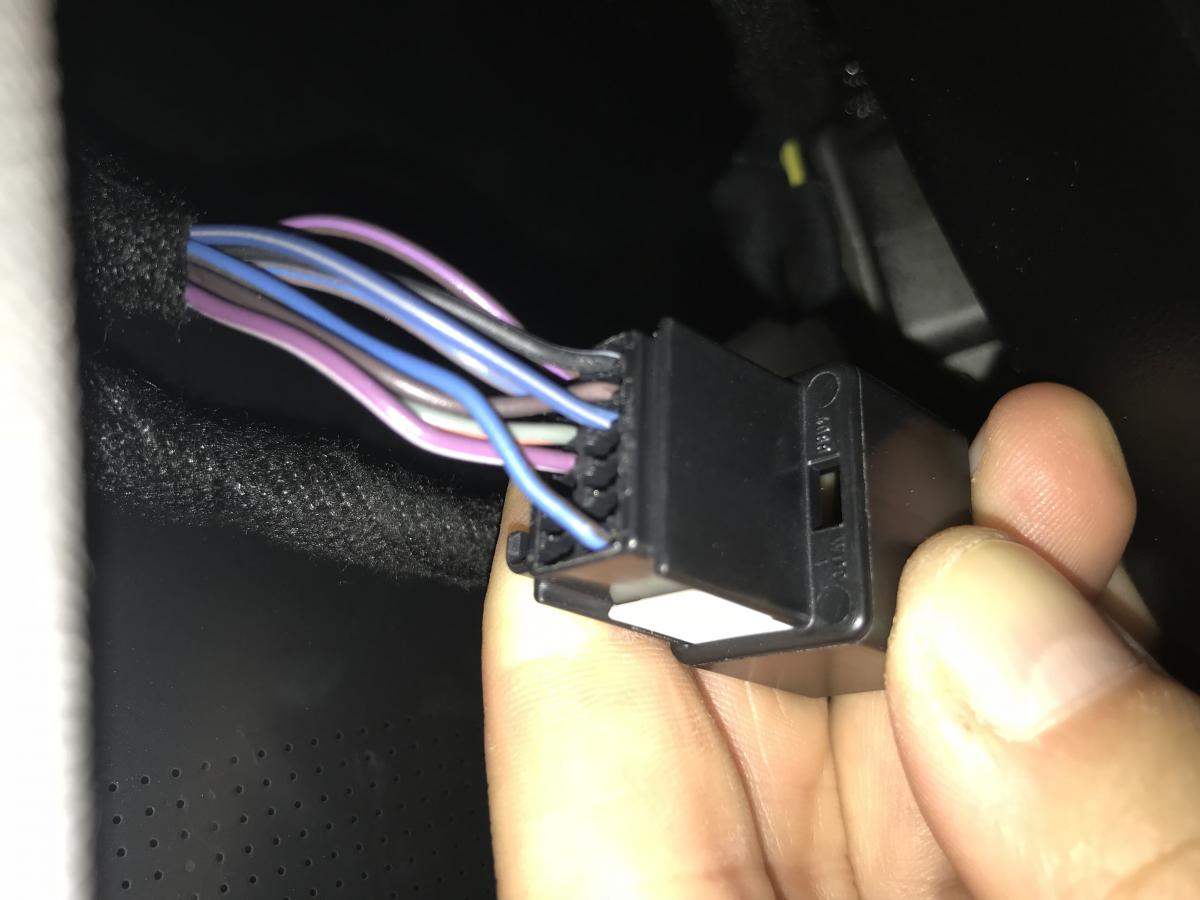

Appears the blue wire is hot. I get 11.60 volts when the car is on and nearly zero when its off. How do I determine the ground? Thinking its probably the black wire with the white strip. Thoughts?
Also, how do you remove the area that houses the sunroof controls/sunglasses holder, etc? Am sure I would find a bolt up in there to ground to if not.
That whole module pulls right off, its snapped in place with clips, just pull it straight down and it will come off. I remember it was a bit more difficult than I had expected, but it came off and snapped back on, no problem.

The wires in that video are not the same colors as mine. So, while I follow what he's doing, it didn't help since I was trying to determine which was hot and ground. I ended up bailing on the mirror tap.
I bought a micro 2 add a circuit. Unfortunately it didn't fit the fuse box. What I mean is this - the black portion of that connector - that holds the two fuses - was too fat to fit in the fuse socket. The fuse was the right size. That black "dongle" was just too fat. I filed it down on both sides and got it to fit, but what a pain.
With that installed, I did the usual snaking of the wire up the pillar, behind the airbag and over by the RVM. Plugged it into my new Uniden R3 and life was good. Very happy with it.
