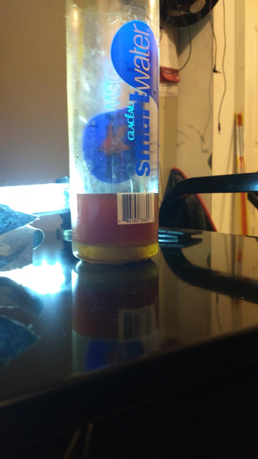

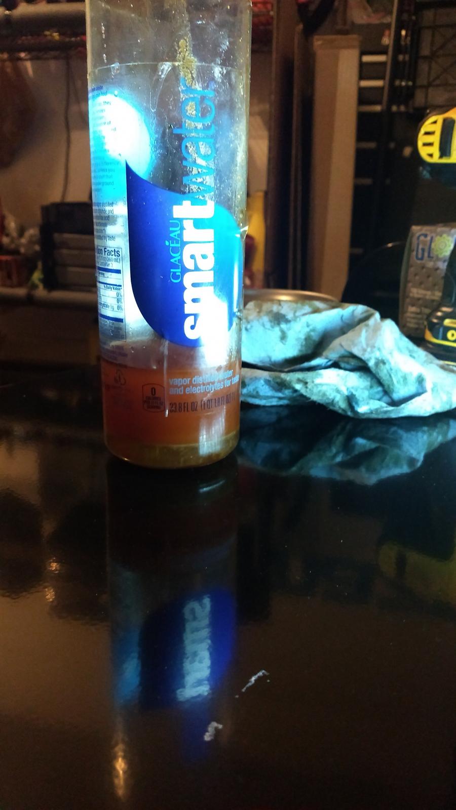

Just a tad below 2100 miles since it was last drained (11/2/17), i decided to drain my Catch Can. I was quite surprised by how much came out. The weather has been in the single digits the last few 2 weeks (some nights/mornings in the negative) & this was the result. Very glad that I have a can to catch this junk, 2.0 Ecoboost:
