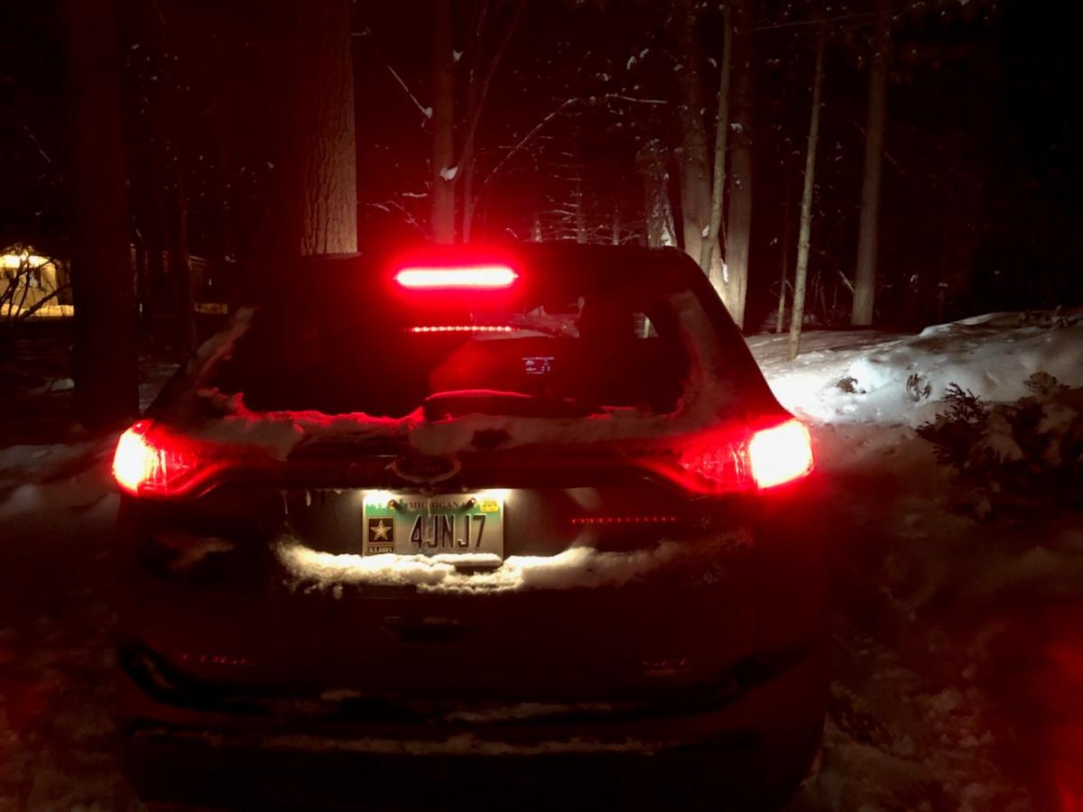

I recently purchased a used 2015 Ford Edge SEL EcoBoost.

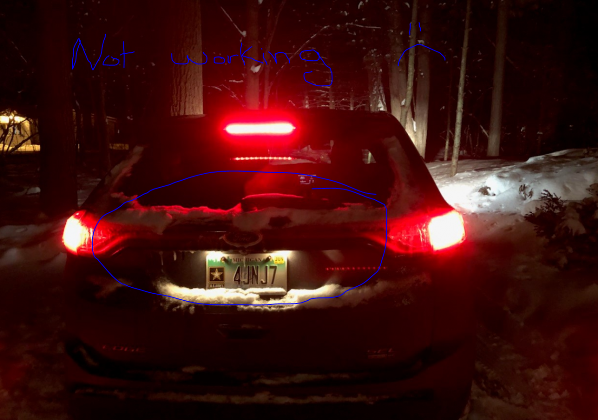

Please see the attached pictures. The rear tail light "bar" does NOT work. It does not work whether I am hitting the brakes or not. Please advise.
Thank you in advance for whatever insight you can spare me!
Grant
Edited by grantcyoung

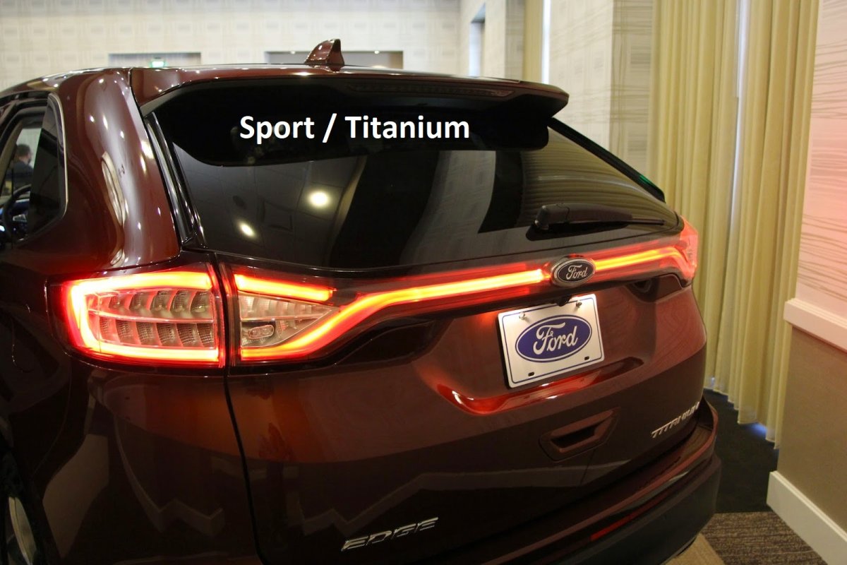

Only the Titanium and Sport models have the light bar that lights up. Both taillights are different too in the way that the upper section lights up in red for the parking and brake lights BUT the lower portion lights up in yellow for the turn signals. On the SEL, the whole taillights light up in red and the turn signal flashes in red, with no center light bar.

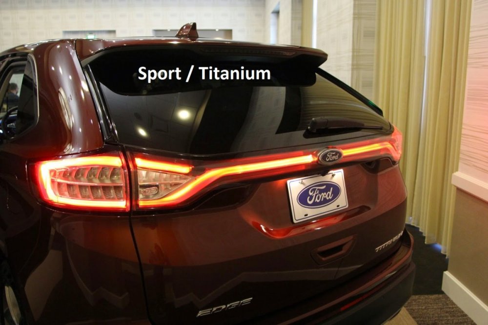

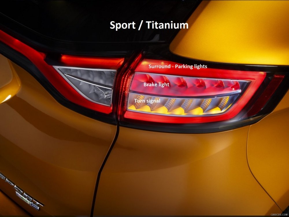

Furthermore, and in the last post in the thread @Gadgetjq linked to, even the taillights on the sides are different. SE/SEL have different lights than Sport/Titanium models as they illuminate differently. If you want a full bar, you'll need all three light assemblies and also programming through ForScan.
In the SE/SEL side taillights, only the middle part illuminates. Low intensity for normal parking light function and full brightness with brakes/signals.
In Sport/Titanium side taillights, the surrounding illuminates as the parking light (completing the middle bar) and middle part is split, top is red for brakes and bottom is amber for signal.
