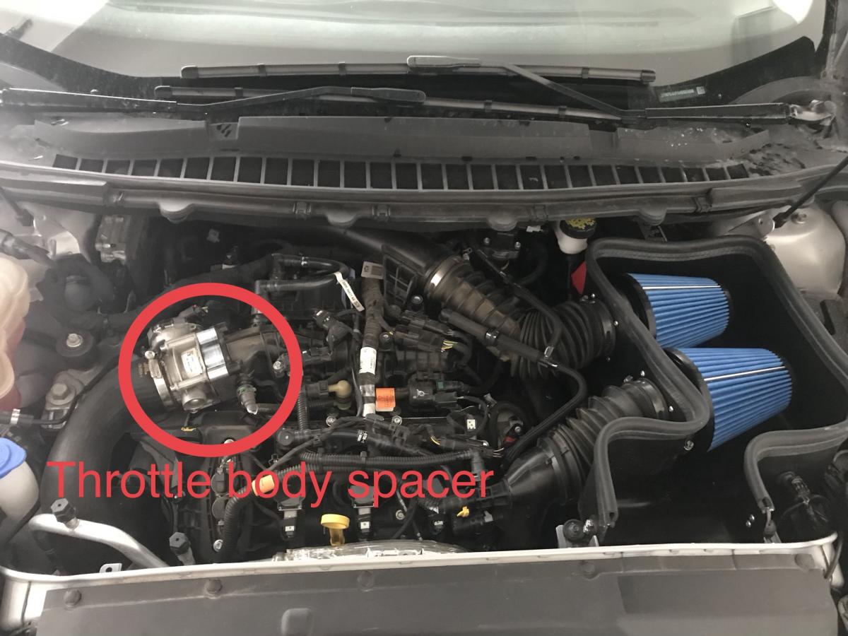

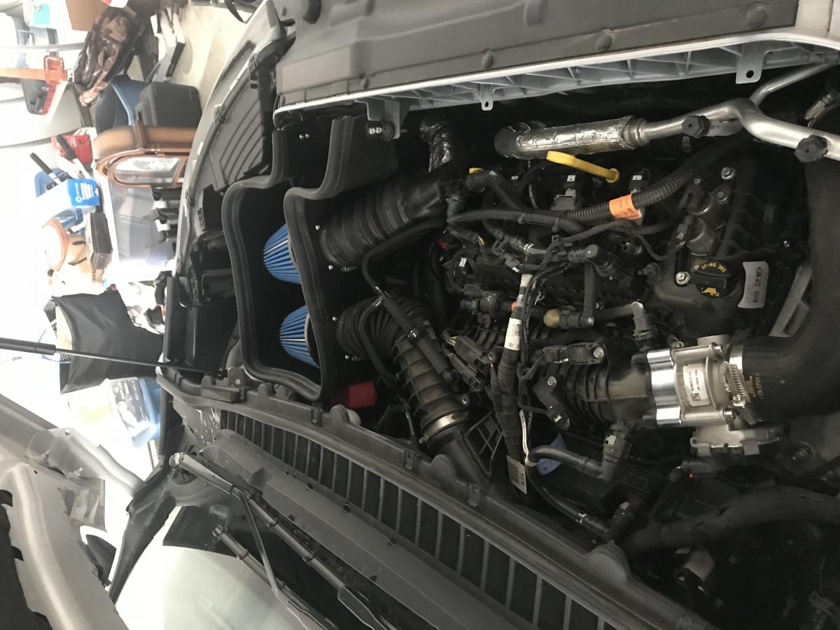

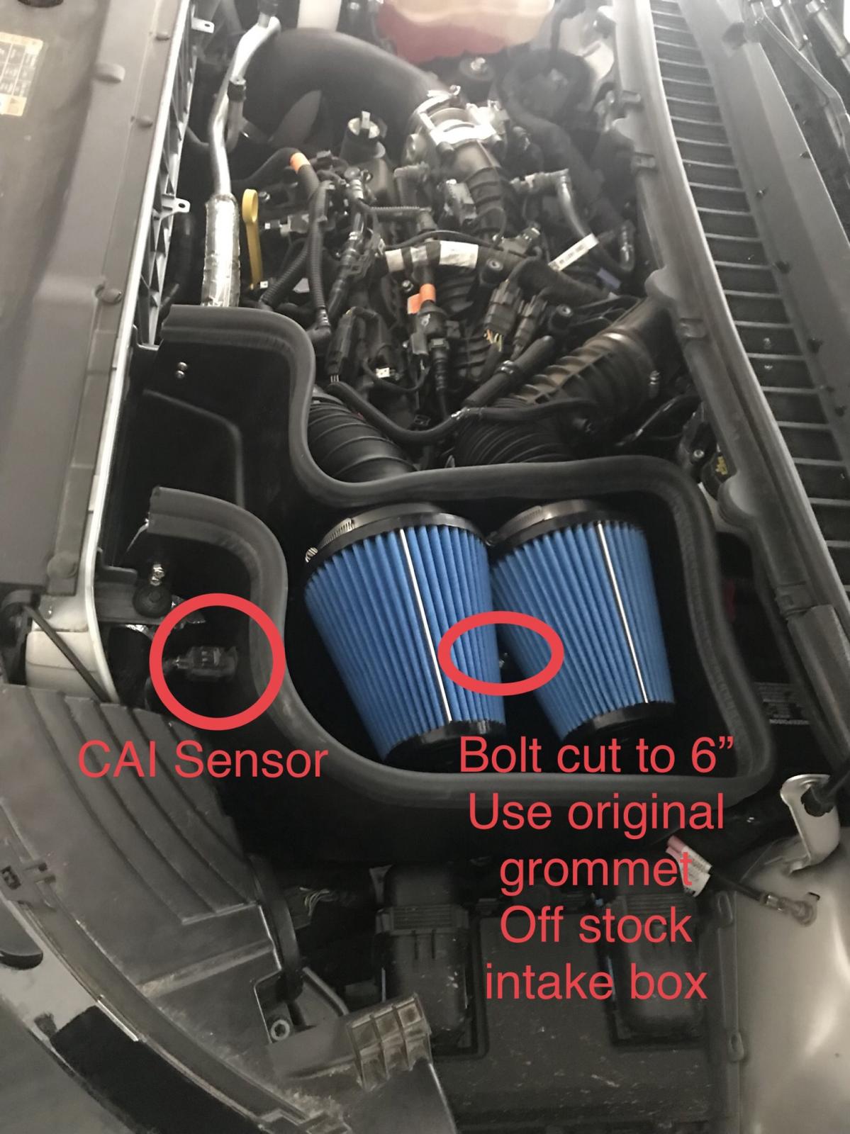

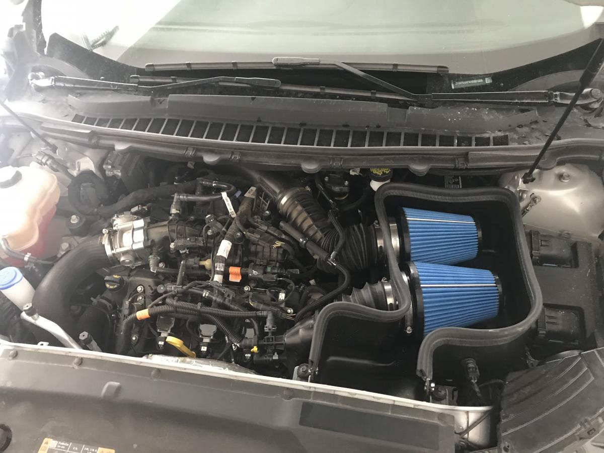

Hey everyone,
Im not too sure if anyone has done this yet. Ive looked to see if anyone has done it yet and havent found anything. I recently purchased the Steeda CAI and throttle body spacer for the Fusion to try it out on my Edge. I just got around to installing it on the Edge, so far I have had it on the vehicle for only a couple days now but I am enjoying it. You will not be able to fit the engine cover back on if you do this without trimming it. I havent modified the engine cover yet but I plan on doing that eventually. No engine codes or anything will be thrown as long as you put your sensor for the intake back in and dont break it(thats probably the hardest part about installing the CAI because of fitting it through the grommet). Steeda provides you with everything besides the bolt that sits down in the grommet under the intake (this helps support the intake and keep it upright on the back end). All I bought to make this work was a piece of 1/4 all thread, I cut it to 6 and thats the bolt I replaced in the kit that Steeda sent me to support the CAI. Also, you need to use the grommet piece off the stock intake box. Anyways, here are some pictures of it.

There have been a few guys on here that have made their own and it looks very similar to that steeda product you have there. They have all since removed them because it just doesn't work. The temps under the hood on these edges are insane, and if that design doesn't seal to the hood, you'll be running into the same issue.
