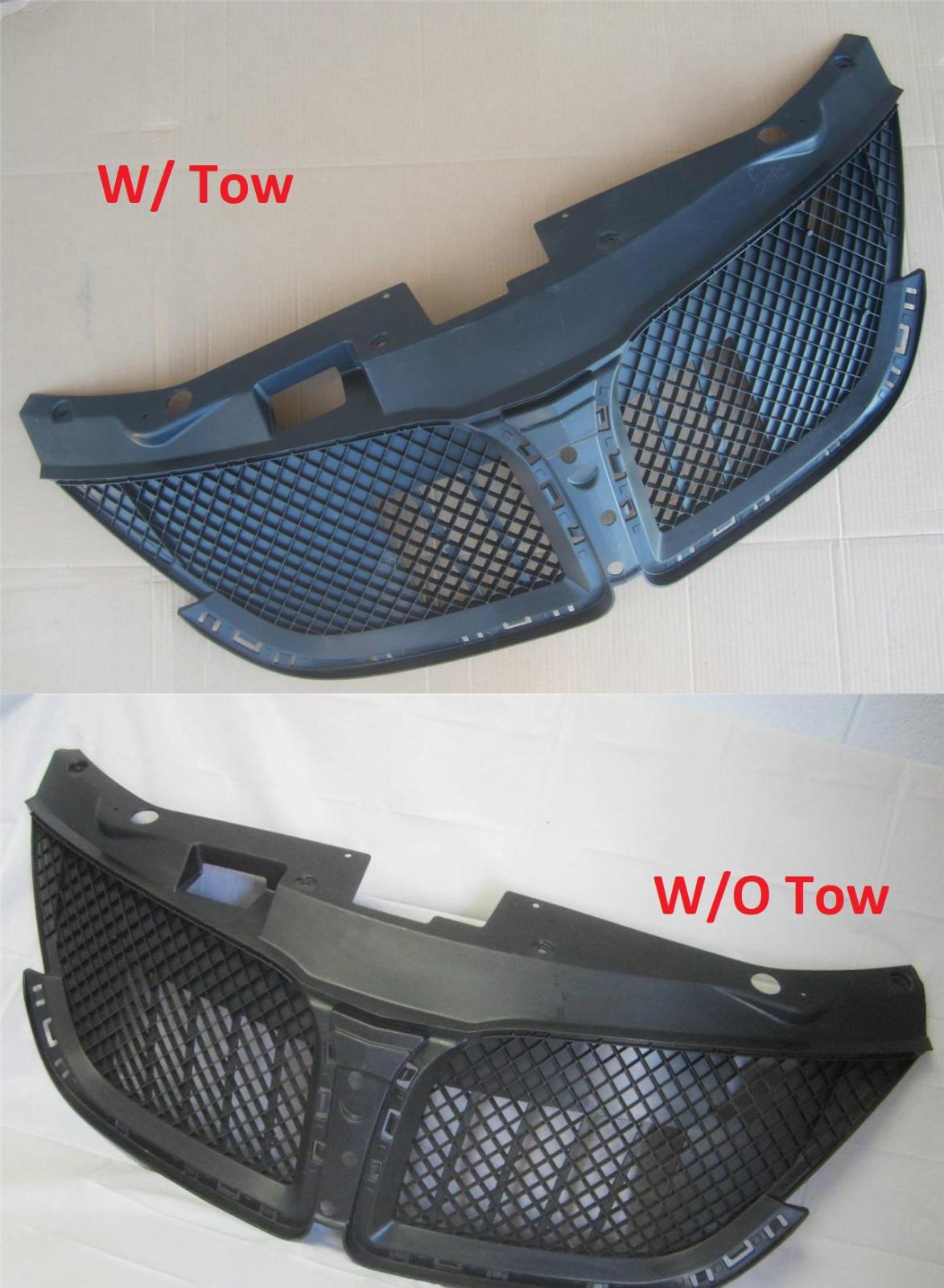

The attached image shows the difference in the grille reinforcement for the 2011-2015 Lincoln MKX differs based on the Tow Package availability. You can see how with the Tow Package the reinforcement has 5 slots for air flow to the radiator per side, while without the Tow Package it only has 3 per side. This was not mentioned in any Tow Guide as a difference. I mean to show this as an example of changes that are not apparent between vehicles factory equipped with Tow Packages compared to those without the Tow Package.

Well there you go. Frontal area for cooling, radiator and fans (at least).

Not the frontal area of what you’re towing, the frontal area of the vehicle that’s available to feed the cooling system. Reference the grille reinforcement that Omar posted.

I should not have used that term. I was simply referring to the amount of air made available to the cooling system - it’s different with and without the tow package as evidenced by the different grille reinforcements.
Simply put the tow package allows more air into the larger radiator and fans. If not then the larger radiator and fans wouldn’t do any good.
akirby, the Grille reinforcements I posted were only for the MKX. The Edge (2011-2014) have only 1 part number, so it would seem they are the same whether Tow Package equipped or not. But your point still stands that there might be more to a factory Tow Package than what is listed in the Towing Guide and it is not a simple difference.
