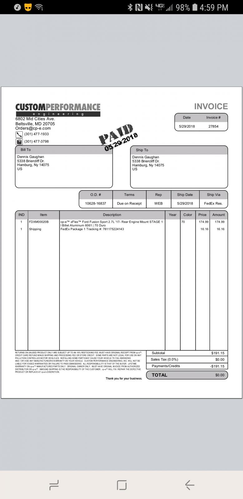

The cp-e rear motor mount that is listed is the 70 durometer version, not 60. You need to call and ask specifically for 60 I guess.
Absolutely Incorrect...
FACT: SpecialK & I were the ones who worked directly with CPe on site to R&D the RMM of which the final Duro choice was 60.
Update (05/31/2018):
Just spoke with our Engineer POC at CPe and identified it to be a Web page authoring error, cut & paste from the Fusion page, however they are going to rectify the Info and I verified that it hasn't changed from the 60 Duro we finalized it at... :hat_tip:

Well their order invoice also lists the part as 70 durometers

I figured out what happened, the link on this forum post leads to the fusion's 70 durometer mount, whereas when you go to the link in the cpe mount specific forum post it brings you to the choice of either the fusion or edge's respective mounts. So I ordered the fusion's mount by mistake.
