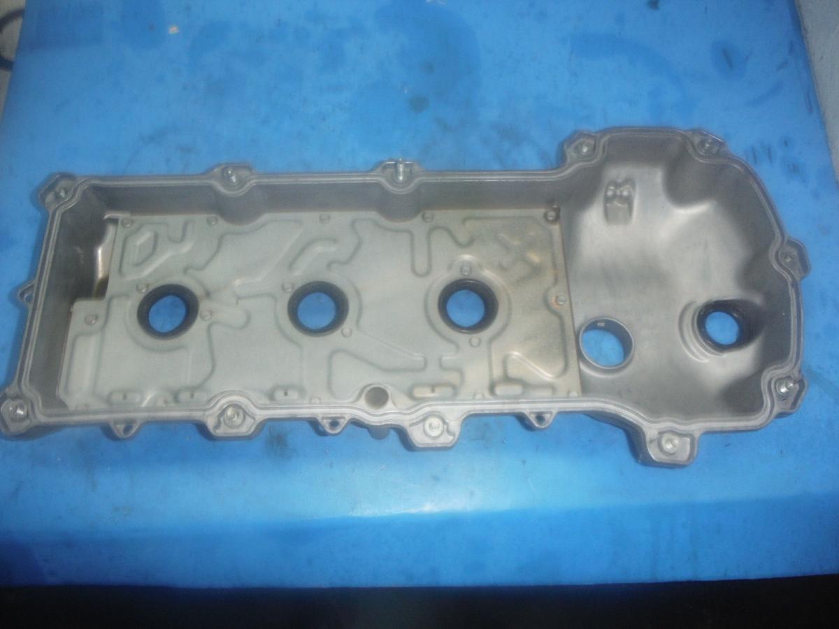

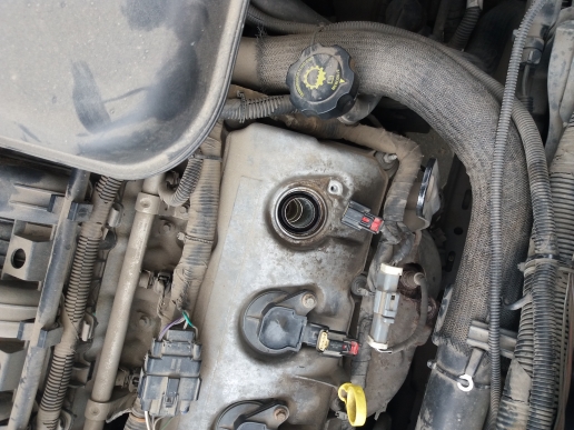

WWWPerfA_ZN0W Posted June 17, 2018 Report Share Posted June 17, 2018 Over a quart in 5,000 miles, that is not normal with ANY quality oil - conventional, synblend or full synthetic, for these engines. Have you pulled the COPs and plugs? More than likely it is a valve cover gasket or a spark plug tube seal leak. Surprised there is no misfire issue. Have you checked codes? Any leaks from Bank 1 (firewall side)? 1 Quote Link to comment Share on other sites More sharing options...
enigma-2 Posted June 18, 2018 Report Share Posted June 18, 2018 Hi Edward, this site has an article and pictures describing the spark plug seals and offer more info on their replacment. It's on a 2009 Ford Flex, but same 3.5L engine. https://www.fordflex.net/forums/viewtopic.php?t=7809 2 Quote Link to comment Share on other sites More sharing options...

WWWPerfA_ZN0W Posted June 18, 2018 Report Share Posted June 18, 2018 I suppose you could get a probe to examine the rear valve cover (bank 1) without removing the intake manifold, to look for similar oil leak issues, but it would be easier to take the manifold off since you need to check the spark plugs to give you a comparison with spark plugs from bank 2. But it looks like no leaks on bank 1 from your video. Most likely you would get an oil smell in the cabin if there were a leak on bank 1, unless it is slow enough. Will check the logs soon. 1 Quote Link to comment Share on other sites More sharing options...
EDST777 Posted June 18, 2018 Author Report Share Posted June 18, 2018 I suppose you could get a probe to examine the rear valve cover (bank 1) without removing the intake manifold, to look for similar oil leak issues, but it would be easier to take the manifold off since you need to check the spark plugs to give you a comparison with spark plugs from bank 2. But it looks like no leaks on bank 1 from your video. Most likely you would get an oil smell in the cabin if there were a leak on bank 1, unless it is slow enough. Will check the logs soon. Thanks for your professional help. I will check Bank2 plugs, I incline also now to opinion that the problem in Bank2, and most likely with COP because spots of oil are localized around them in Bank2, the second possible cause can be laying of a valvate cover of Bank2. A key for plugs I will take plugs and to investigate them, also I will take COP for studying of a state. But I have no mistakes, it is possible because of weak process of leak. Any your councils are very important for me. Thanks. Quote Link to comment Share on other sites More sharing options...
EDST777 Posted June 18, 2018 Author Report Share Posted June 18, 2018 (edited) Hi Edward, this site has an article and pictures describing the spark plug seals and offer more info on their replacment. It's on a 2009 Ford Flex, but same 3.5L engine. https://www.fordflex.net/forums/viewtopic.php?t=7809 Thanks, is very valuable information, I study it, I think it is really applicable for me. P.s It is strange to be told about the image plug tube seals there but there are no images. . Edited June 18, 2018 by EDST777 Quote Link to comment Share on other sites More sharing options...

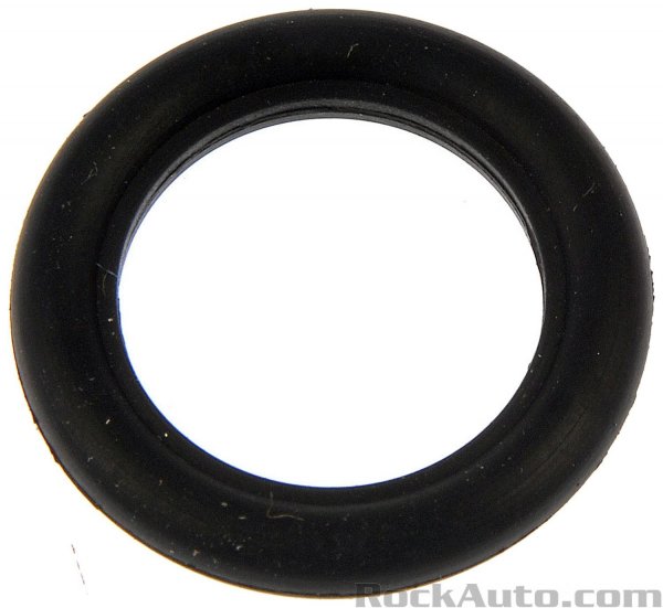

EDST777 Posted June 18, 2018 Author Report Share Posted June 18, 2018 (edited) probably this consolidation in a valve cover DORMAN 097146 {#0971461, 971461, F75Z6734AA} Rubber Gasket; Rubber; Size; M14, 1/2"; Inside Dia: 12.75mm; Outside Dia.: 19.38mm; Thickness: 2.67mm 7T4Z12025A Edited June 18, 2018 by EDST777 1 Quote Link to comment Share on other sites More sharing options...
WWWPerfA_ZN0W Posted June 18, 2018 Report Share Posted June 18, 2018 5 7T4Z-6584-A Valve Cover Gasket EDGE, MKX; LEFT $14.58 $10.06 5 7T4Z-6584-B Valve Cover Gasket EDGE, MKX; RIGHT $14.53 $10.03 LEFT is bank 1 RIGHT is bank 2. The FelPro kit looks like it includes everything for both banks, including valve cover gaskets, bolt grommets, spark plug tube seals and VCT solenoid seals. https://www.rockauto.com/en/moreinfo.php?pk=4890087&cc=1434490&jsn=10698 1 Quote Link to comment Share on other sites More sharing options...

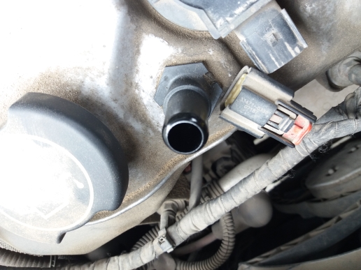

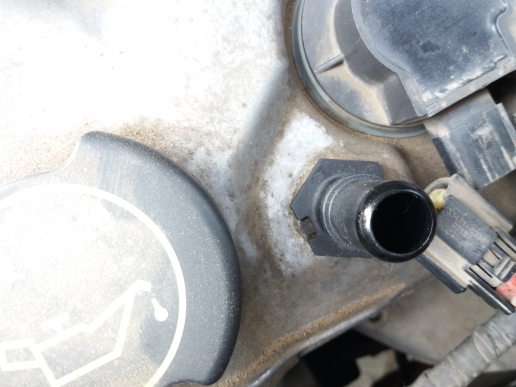

EDST777 Posted June 19, 2018 Author Report Share Posted June 19, 2018 (edited) LEFT is bank 1 RIGHT is bank 2. The FelPro kit looks like it includes everything for both banks, including valve cover gaskets, bolt grommets, spark plug tube seals and VCT solenoid seals. https://www.rockauto.com/en/moreinfo.php?pk=4890087&cc=1434490&jsn=10698 Only VICTOR REINZ VS50490 and KNECHT/MAHLE VS50490 what of these producers to prefer is available to me? Thanks. p.s: I think also to replace the PCV valve, it can't give such problems? or the problem would be on two parts of Bank1 and Bank2? Edited June 19, 2018 by EDST777 Quote Link to comment Share on other sites More sharing options...
WWWPerfA_ZN0W Posted June 19, 2018 Report Share Posted June 19, 2018 Both brands are top quality, I have a slight preference for Victor Reinz, but really Mahle should work work well too. Could be that the PCV valve is causing a problem. If it is clogged/not functioning properly, it can cause buildup of pressure inside the crankcase/engine and cause seals to leak. So well worth replacing for peace of mind. 1 Quote Link to comment Share on other sites More sharing options...

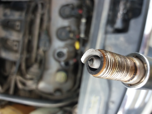

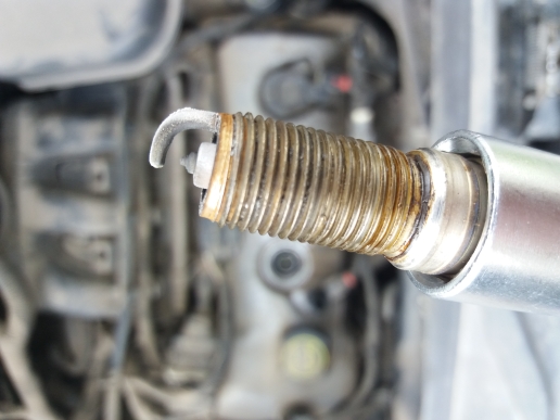

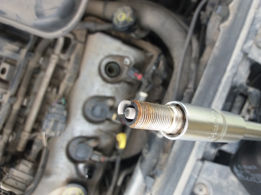

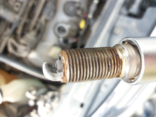

EDST777 Posted June 28, 2018 Author Report Share Posted June 28, 2018 (edited) so friends I have unscrewed all three plugs of Bank2, I haven't found anything bad on plugs, there are no soot traces, there are no oil traces, there is no blue color. But that concerns me, it is a gap of plugs, it is much more of fact that it is specified in the guide to service which specifies 1, 61 mm a maximum. My valid size nearly 2 millimeters, at the same time isn't present any problems, the engine works without hindrances, steadily and doesn't shiver. It isn't sure, but these plugs in a new state had a gap more than 1, 61 millimeter. In the management old data are really specified? Edited June 28, 2018 by EDST777 Quote Link to comment Share on other sites More sharing options...
WWWPerfA_ZN0W Posted June 28, 2018 Report Share Posted June 28, 2018 The plugs look ok-ish to me. But the gap growth is rather quick for only 53000 kms on them. I would say in your case, change them every 50000 kms to be safe. One possibility for the oil spots is the Engine Oil Pressure switch. More typically happens on 2011-14, but does sometimes happen in 2007-10 MYs. It is on the engine block to the left and above the oil filter, close to the alternator/generator. Tight spot, inspect carefully. If it is leaking, it is possible that oil has deposited on the valve cover from there. You are sure the oil filter is not double-gasketed, right? Sometimes the oil filter leaves the gasket behind. The leak would be quite severe tho, so I don't think that is the case. 1 Quote Link to comment Share on other sites More sharing options...
