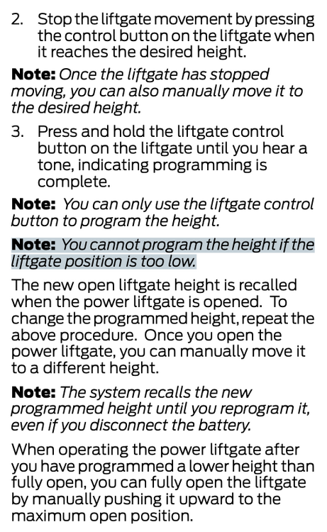

Can't remember if the 09 had the option (check your owner's manual) but on later models you can put the liftgate where you want it and hold the push button for a few seconds and it would remember that opening height.

I did check the manual but it doesn't mention this procedure.

The adjustable height liftagate feature was only added in the 2015+ Edge. Prior models had a fixed height liftgate,
