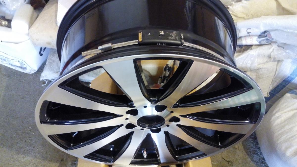

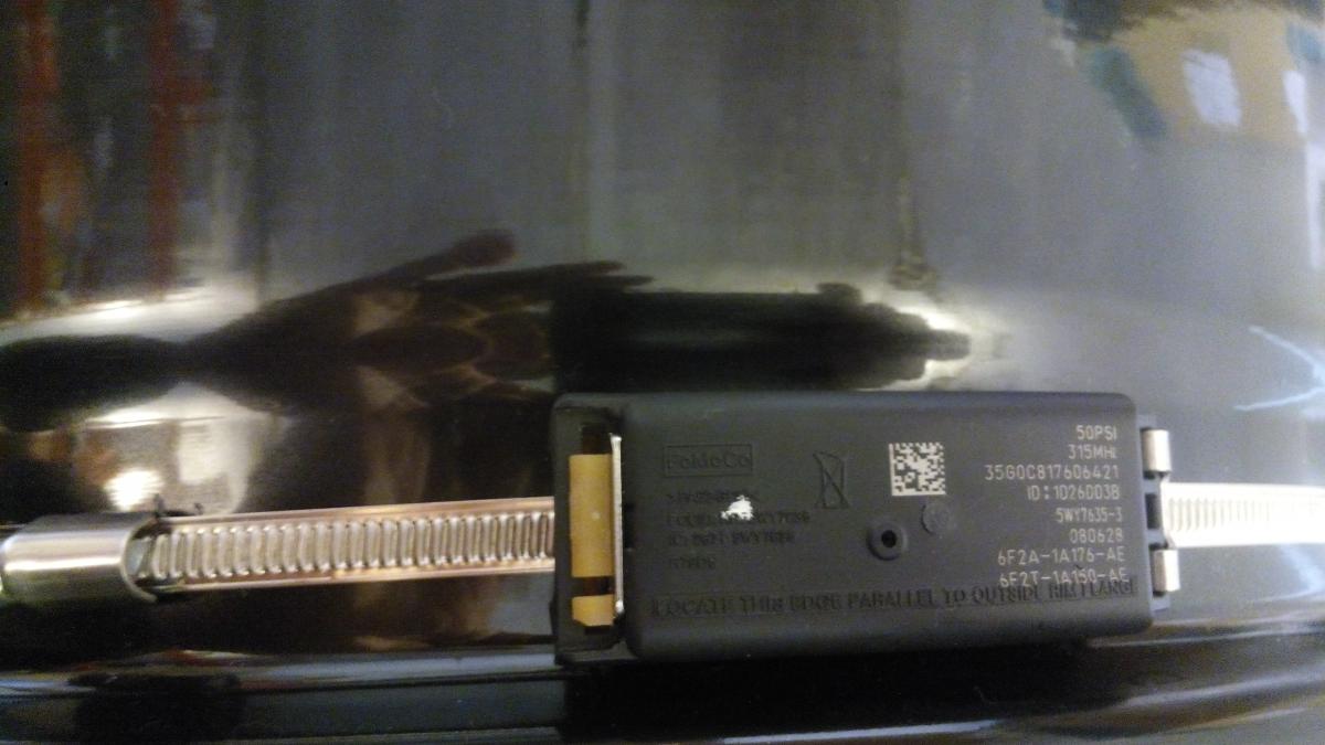

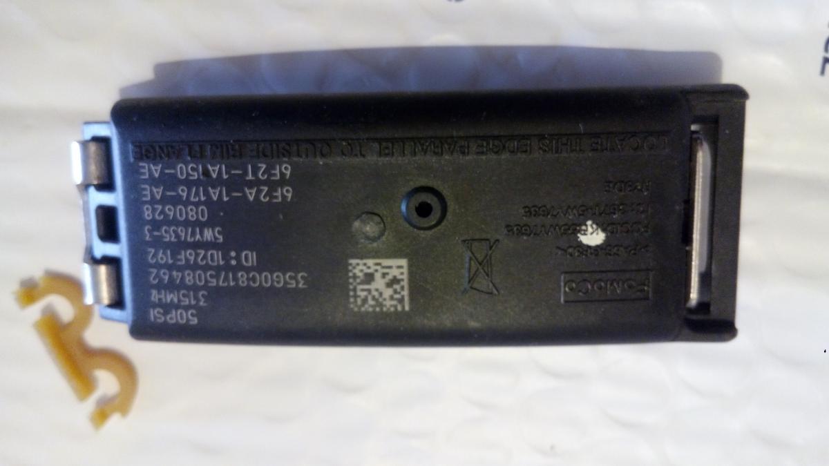

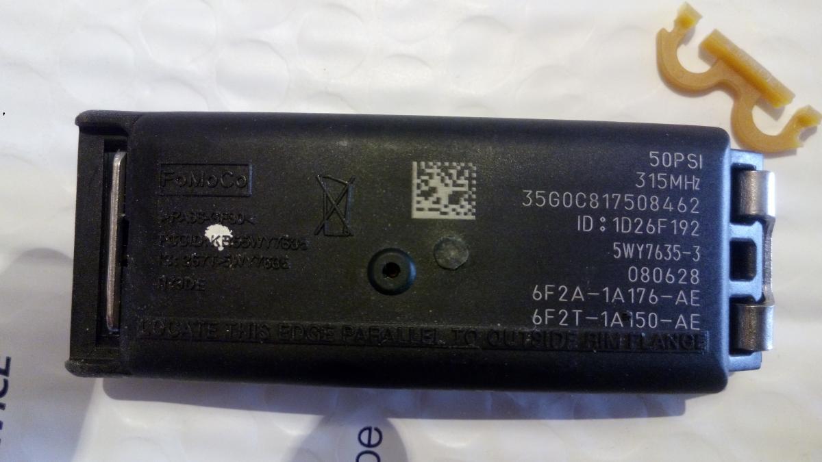

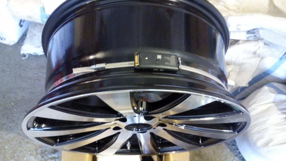

Hi. Help.I own Ford EDGE of 2008 Limited. A week ago I changed wheels with winter for the summer. Before this changeover, for some days I shone a text " tire pressure sensor fault ", pressure was in norm, every other day she went out. I didn't clarify the reason. After changeover of wheels on summer, (in them I beforehand installed new sensors which bought on ebay, original, the seller reported that batteries new), installed on new disks according to the instruction on band. After changeover three days everything was in norm, but for the fourth day the error " tire pressure sensor fault " again shone. Pressure in buses in norm of 2.4 atmospheres. I will be grateful for any councils. Thanks.
Edited by EDST777
Or maybe the vehicle sensor is bad.
Perhaps, but the seller claimed that sensors are checked also the new. Five days after mounting of buses weren't errors.
I bought here http://www.ebay.com/itm/BRAND-NEW-SINGLE-1-Ford-OEM-TPMS-SENSOR-BLACK-w-OEM-BAND-/121621904960?hash=item1c513afe40&vxp=mtr , rather reliable seller. It is declared by the seller:
*BRAND NEW* SINGLE (1) Ford OEM TPMS Sensor BLACK with OEM BAND
You're bidding on a *BRAND NEW* SINGLE (1) Ford OEM TPMS Sensor BLACK with Factory BAND. Brand New - Sensor has been tested and guaranteed to work. Factory OEM Mounting Band and Cradle are also included. Sensor Part # - 6F2A-1A176-AE, Band Part # -6L2A-1A177-AC. Please contact your local dealership for the proper application for your vehicle.
Edited by EDST777
