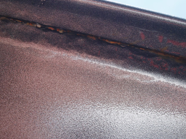

Im in the chicago area and was changing the oil on it and something caught my eye...Yes im in a salt city in the winter , and an avid washer, but i noticed the build up of salt just under the front hood lip..still apparent in may...washed it all away and waxed like a dog but notice some bubblin on the underseam...My note to all Edge owners is if u live where u have salt in the winter, its a hot spot for cancer to start...Maybe im the only one but I thought Id give a shout out to fellow Edgers!!! Mom always said wash behind the ears, I say wash under the hood!! Be good or try to be, EdgeDog

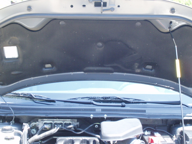

Here comes the rain....!!! i think i did this right in sending pix , but , here comes the cancer i talked about last year...yet it is small bubbling but I feel all that might be in the salt zone should know about it...upper right , when hood is open is one pic, right above the hood arm holder and lower left........its april and was a warm winter and not much salt...I opened her up today and both rubber weather strips were loaded with dried salt...so i did some scrubbin, waxin, etc...

post-7676-0-86168900-1414959850_thumb.jpg Update!!! ok 3 years later and this is what I have as far as the cancer slowly grows...FYI , I put a bra on it, which helped out with the rocks and such as I do tons of highway and only had on knick in 5 years ...dont know if that mattered but I clean it every month and wax it out...
