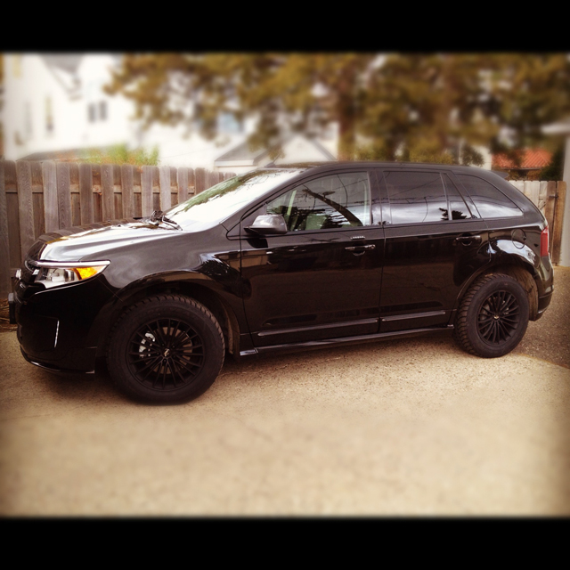

I got mine from TireRack - great service, fast delivery, good price.
18" x 8" wheels
245/60R18 Goodyear Ultra Grip Ice tires
TPMS
I wasn't sure about the wheels until I installed them but to be honest, I kind of like the blacked out look. (loosecannon - what do you think?)
On a slightly different note, I also purchased the TPMS tool for $45 and never actually used it. I was waiting for the tire indicator to come on but so far, nothing.
The OEM wheels are stored about 60' away from the garage so I can't believe that the system is detecting them and I've taken it on a couple of 2 day trips away from home, so I'm not convinced that the system is actually working.
I actually dropped the pressure in one of the tires down to about 20lbs or so and then drove it around a couple of blocks to see if it would trigger. I didn't want to to put any real mileage on it when it was under-inflated so I inflated everything back to the correct pressure and have been driving it like that ever since. Either way, no TPMS indicator after about a month of having them on.

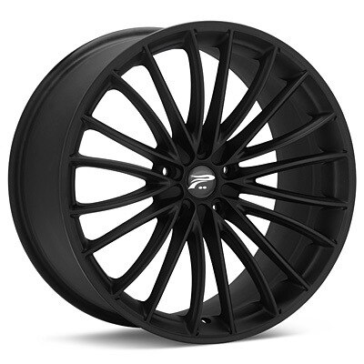

These are my 18" winters, with the P245/60R/18 Blizzak DM-V1 as well. It was between these and the Monarch's Dr.Edge picked up. I liked the polished lip.
Re: Centric Rings - Some will say you don't NEED them. Most people go with non centric steel wheels w/ no rings for winter, but you're unlikely to get them centered perfectly without the rings, which will result in the vibrations you're experiencing. Now you don't know if its a centering issue, or a balance issue. You'll get mixed comments some installers won't even put them on without rings, other say they are not important. For $10 in plastic, I say get them, if you can get the info on the rims to pick up the right size. I was the one that helped Tire Rack get the right hub size on the rim below and on the 2011 Sport, they had both details wrong in the system and sent me 3 sets of rings until I had the right ones.
