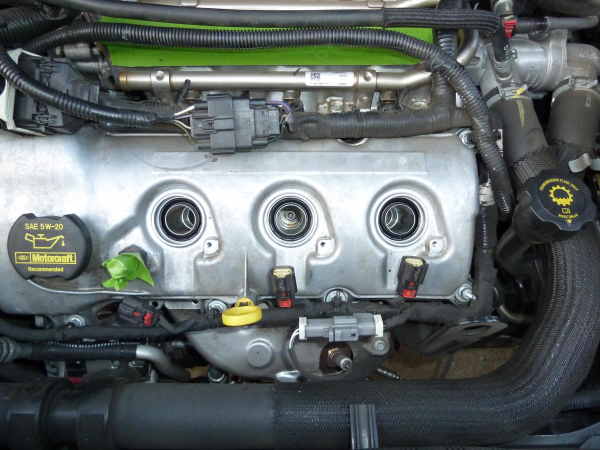

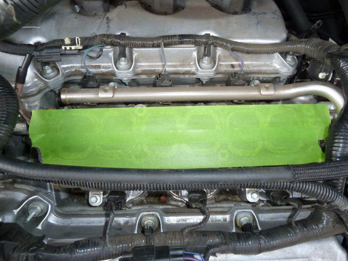

Plugs replaced with the help of this post. I left the connection to the MAF in place, disconnected the intake hose between the MAF and throttle body. I left the PCV tube attached to the intake hose and set both aside.
Ā
Some additional notes:
Ā
The connector to the TB works the same way that the Spark plug connectors do. Slide the red tab in the direction that you want to pull apart the connection. Pinch the plastic tab beneath to release the plug and simultaneously pull apart the connection.
Ā
The coolant tubing running over the upper manifold releases easily. The wire loom is taped to some keepers that insert themselves into the upper manifold. The keepers are difficult to pry off without damaging them. It is easier to cut the tape wrap and pull the loom away from the keepers. This is shown but not described in the write up. This is also a tattle tale for spark plug replacement, if the wiring has not been tampered with, chances are that the stock plugs remain. The upper intake cannot be removed without unclipping these wires from the keepers.
Ā
After the intake manifold bolts are removed, gently rock the manifold loose. Lift the manifold and rotate it counterclockwise around the purge valve mounted near the TB.
Ā
I recommend that the intake openings be covered to prevent debris, or worse, from accidentally falling into the cylinders. I used frog tape for this purpose, same for the PCV connections.
Ā
The rubber spark plug boots are designed to keep debris out of the park plug cavities, but I blew them out with compressed air before removing the spark plugs. I also examined them before I removed the plugs for valve cover leak issues. Oil in a spark plug journal indicates valve cover gasket failure.

Use a wire tie to re-attach the wire loom to the keepers.
