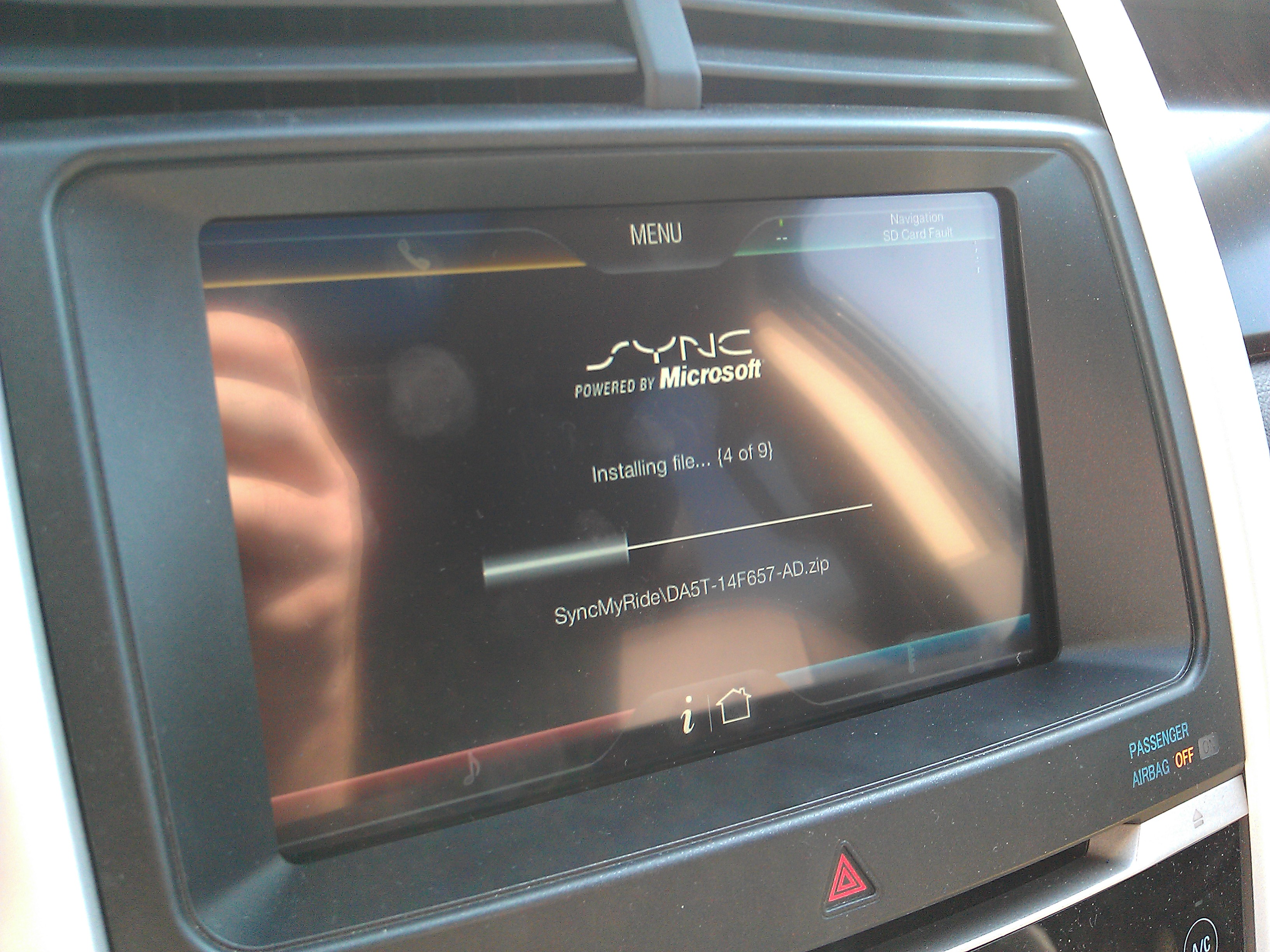

So... I just downloaded and started the upgrade from 2.11 and it's been stuck on installing file 4 of 9 for about 2 hours now. The file in question is DA5T-14657-AD.ZIP
I tried turning the car off and switching usb ports so we'll see how that goes. Maybe I'll try a different usb stick also but if anyone has any advice, I would be very grateful for it.

Someone did a master reset and then were able to correctly download the files
Sounds like a plan but I'm having issues getting to the Master Reset using the Touch screen. It's stuck on the installing file and if I hit the back or any other buttons it takes me right back to the installing file screen.
I just pulled the battery and now I got a blank screen, (abet, not entirely blank) it's looks like the upgrade screen overlay without any progress or text. Any suggestions? I'm starting to think I'm hosed here.... :(
