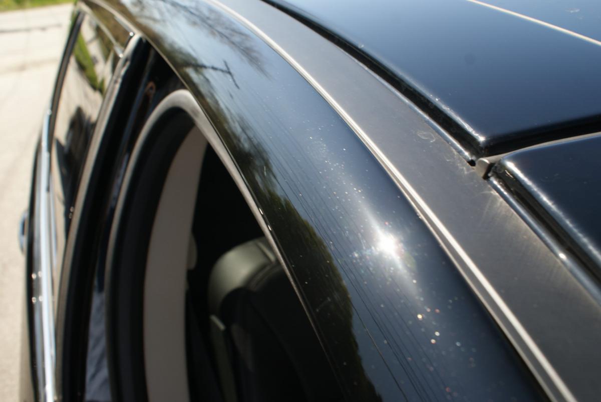

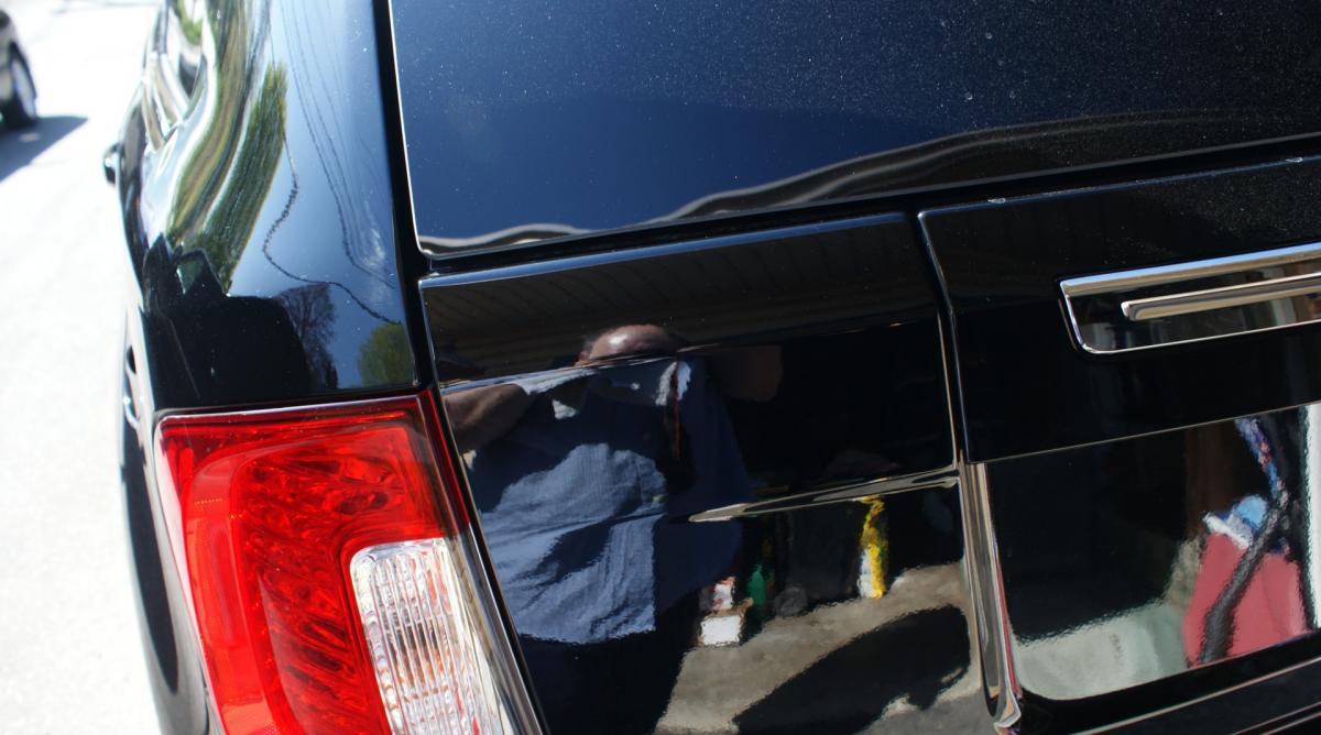

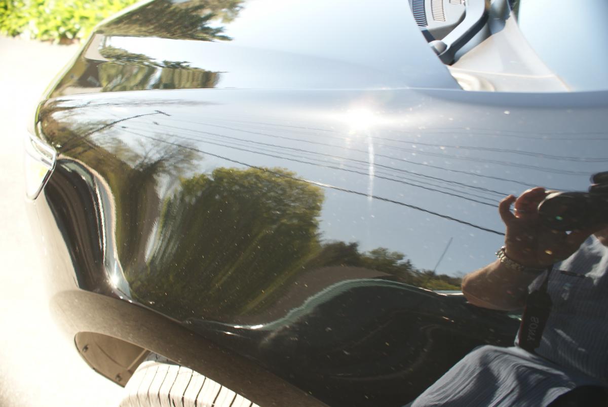

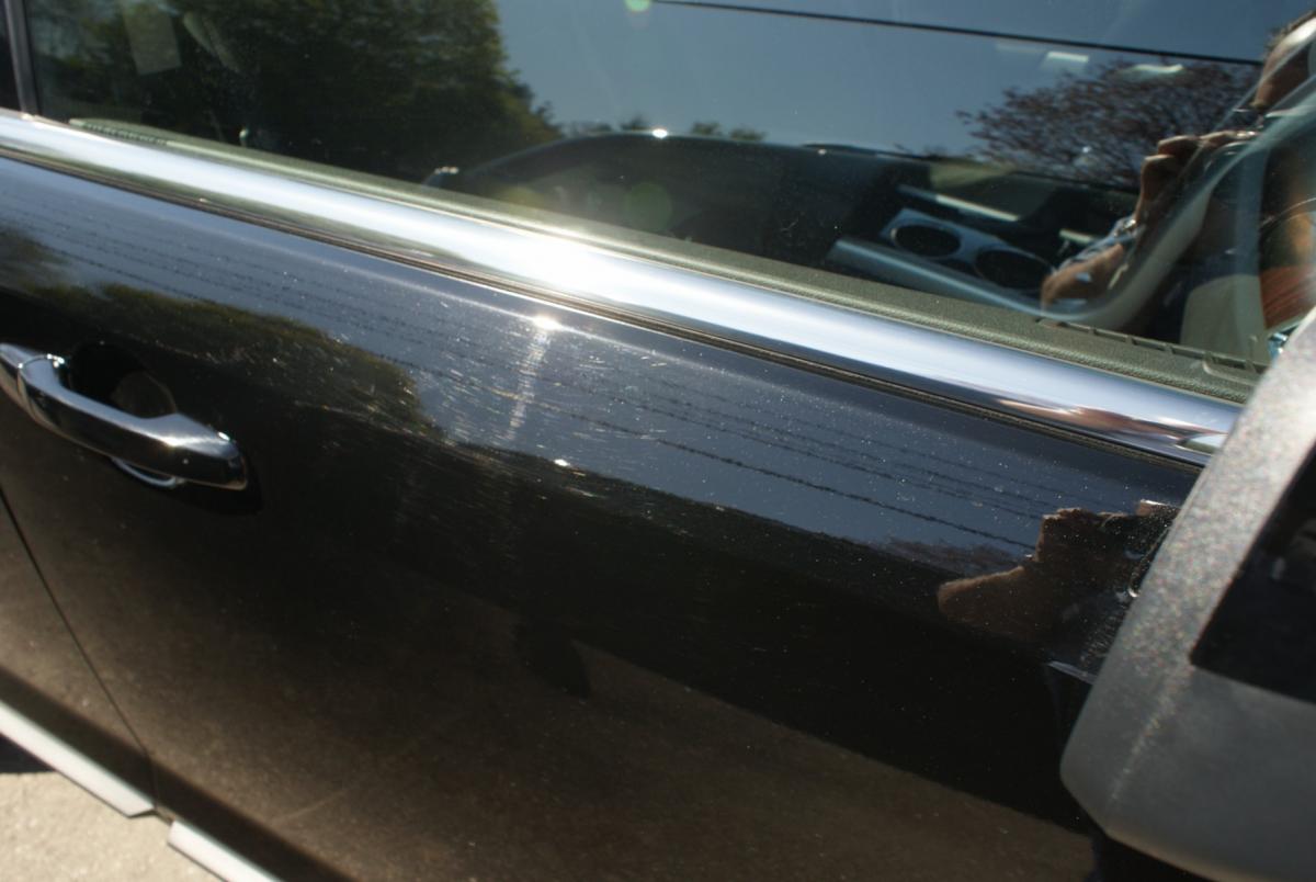

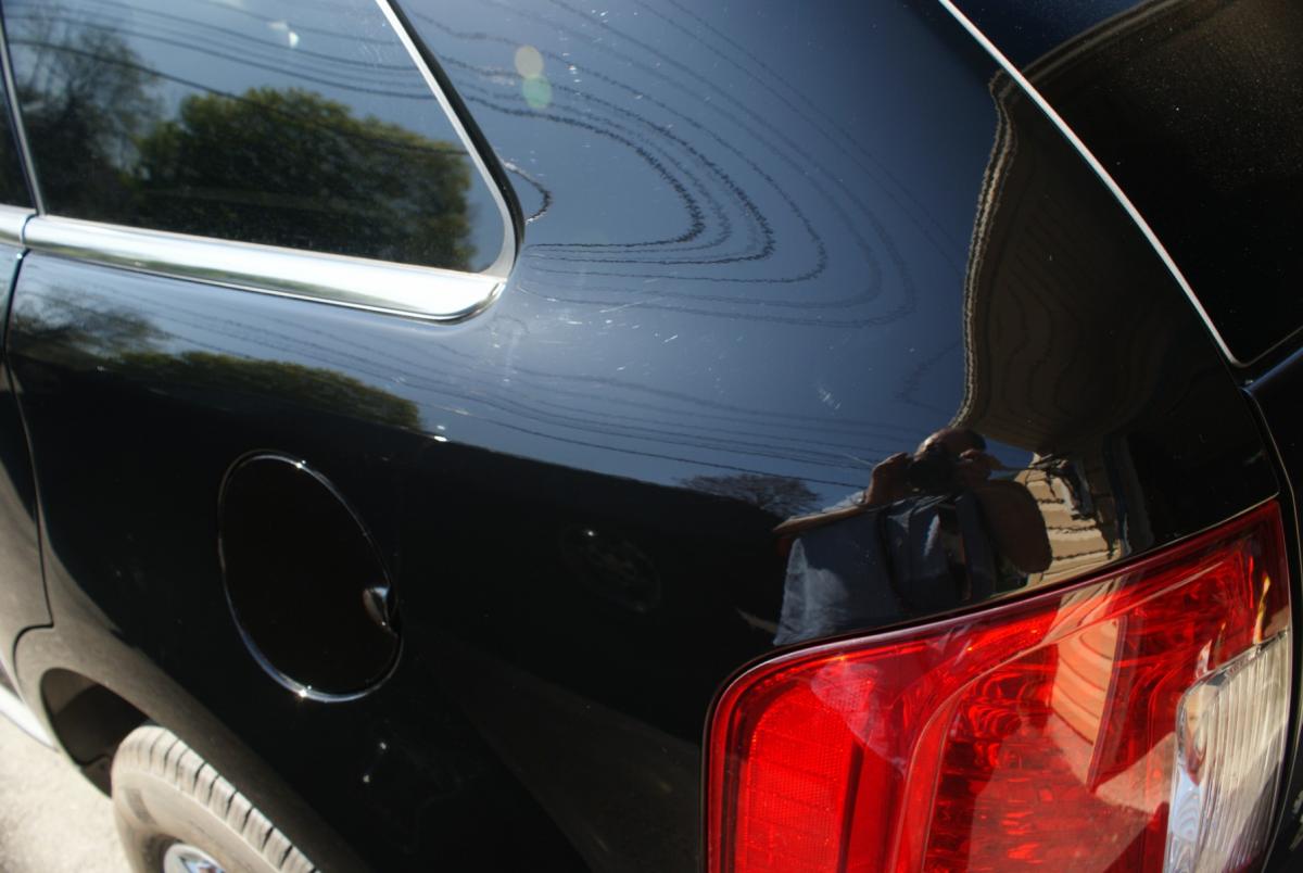

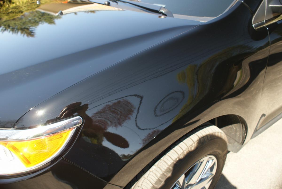

The UA ebony is basic black with no metallic at all (like Tuxedo black) at least i thought. But the darn car has the following:
Black front bumper, Mirrors, Rear quarters and rear end (no metallic at all). A hint of metallic in the hood (just a touch) more on the right, and the fenders have much more metallic that fades down the side to the black quarters. The Right
I looked over every inch to see if any paint work had been done and the car is flawless. There is not a nick, scratch, dust particle it is perfect.
passenger side has metallic on the windshield pillar and fades to the read quarter above the windows.
On the drivers side the pillar is very faint and from the top of the drivers window back, there is no metallic.
Every panel has the factory VIN on it, there is not any sign that it has been repainted. The jams are all UA no metallic Black. Under the hood, the uncleared inner fenders appear to have Metallic as well.
Could this be a FORD screw up. If Tuxedo Black metallic was a 100 (for the quantity of Metallic) The body would be the following Hood 10, Passenger Fender 20, Passenger front door 15, Passenger Rear Door a 10, Rear Quarter a Zero, Drivers fender is a 17, drivers door a 12, drivers rear a 5 and quarter a Zero. Front Bumper Zero.

Are you sure it's not just rail dust/contamination? If not then it's covered by the factory warranty.

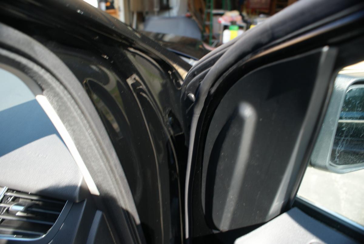

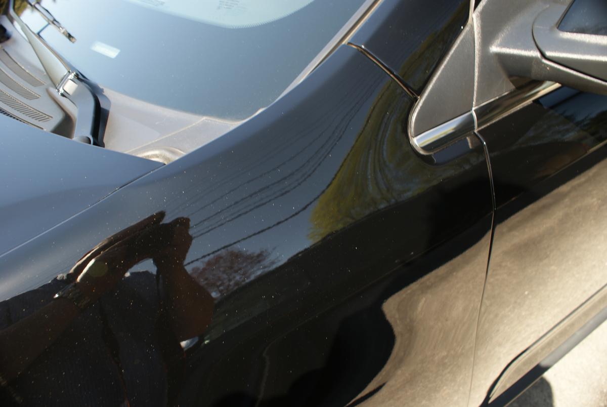

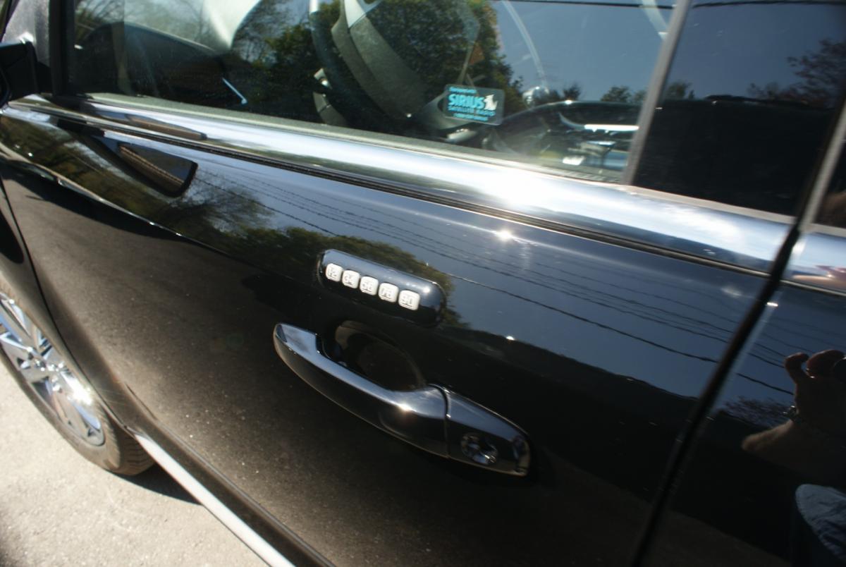

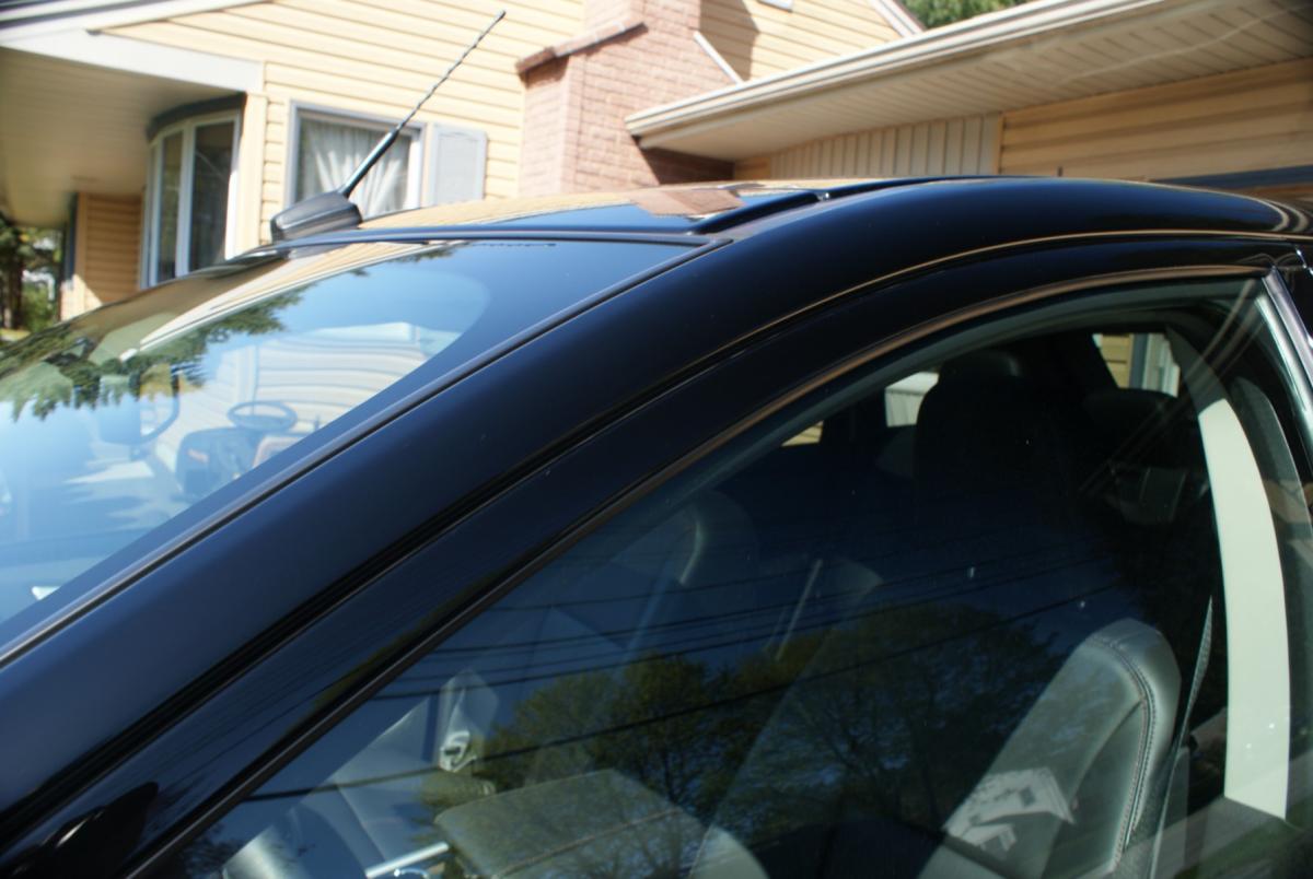

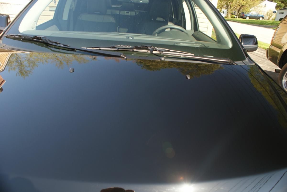

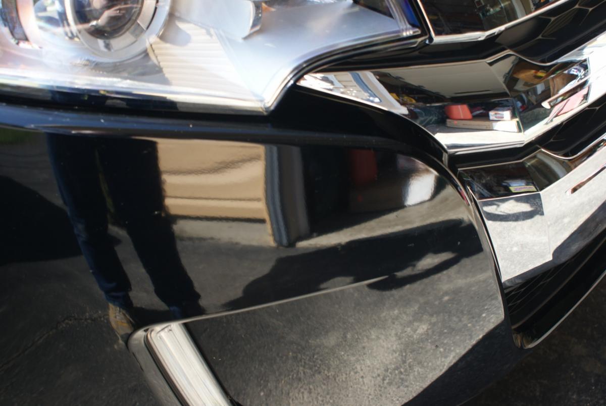

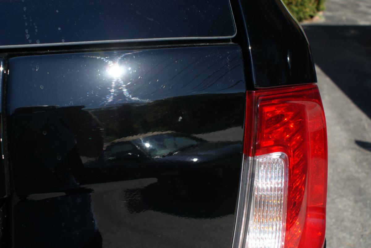

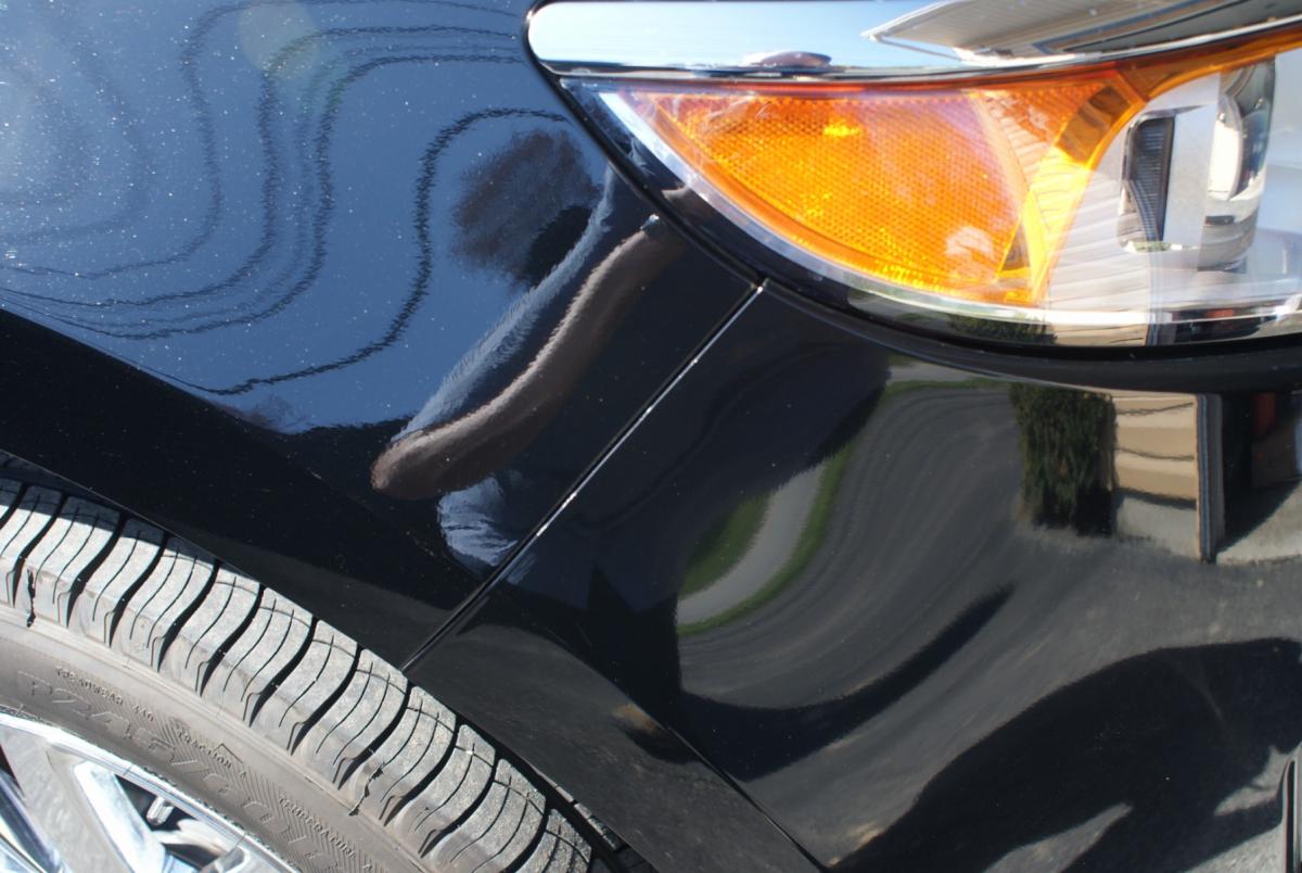

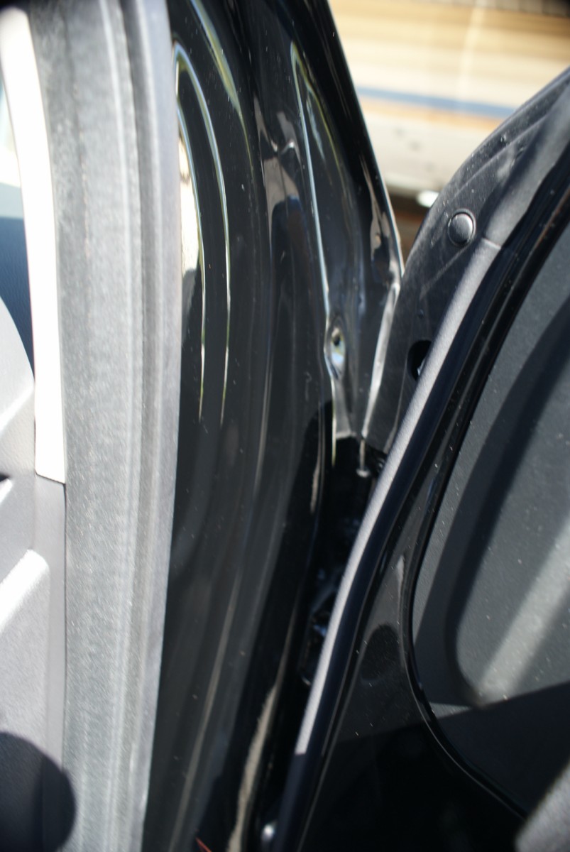

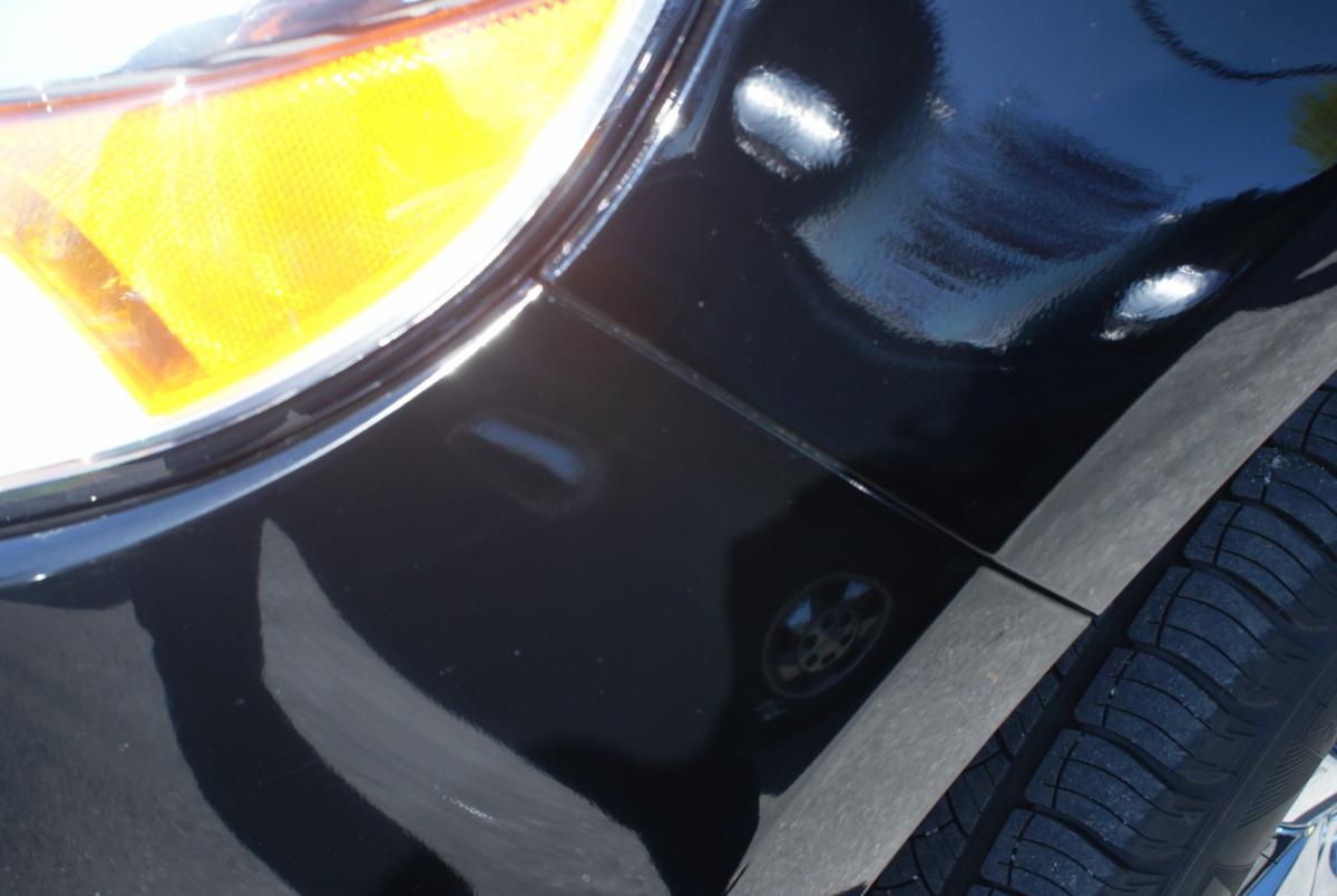

Here are Photos. Wow, they came out great. What is wrong! I cannot imagine having a touch up done to this car. Every panel has a different level of Metallic in it!
Absolutely Metallic in the paint. No rail dust.
Wow. Contact Ford. I'm sure they'll want to see that

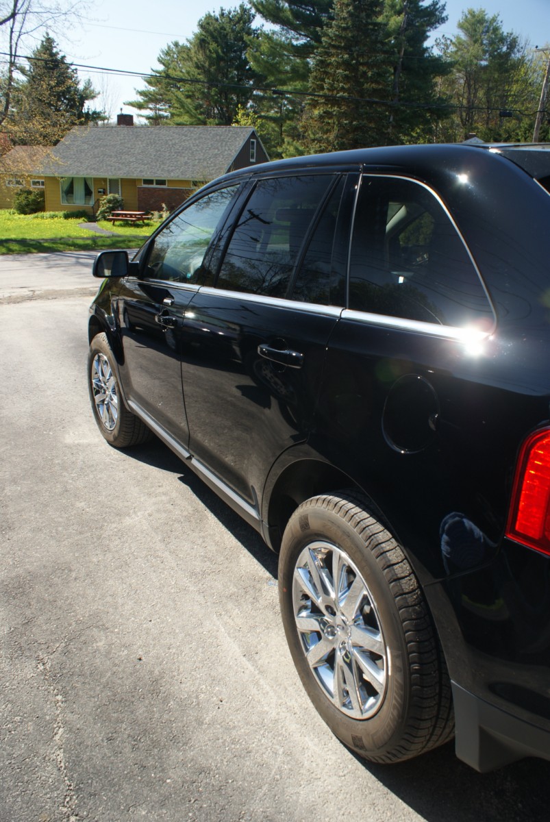

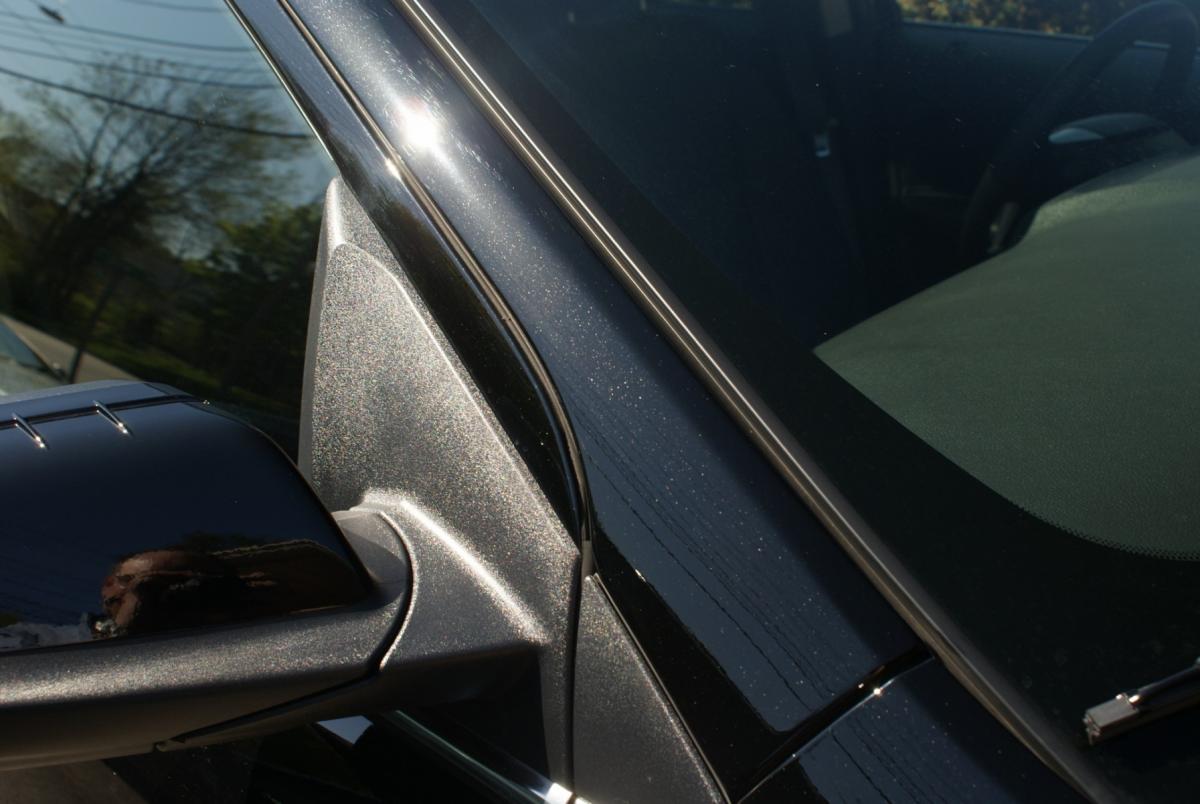

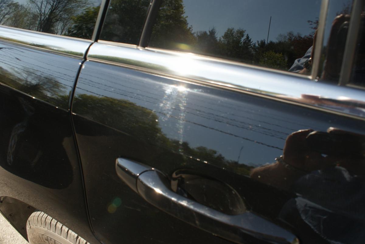

Sorry they lost some detail when I reduced them in size. Here are a couple of Hi Res photos.
I have to say, what a great car. Driving it today I was amazed. The active cruise control is absolutely amazing. The Mytouch worked flawlessly. The Stereo is the best I have ever heard in a car. I loved it. I would buy one for myself soon I think. I have contacted Ford. We'll see if they reply. Maybe a Friday or Monday car?
I'm pretty good at spotting refinish work. Based on the pictures, I sure would like to see this in person. It looks pretty odd to me. I hope Ford helps you out on this.
Could just be me or the lighting but that doesn't look like Tuxedo Black to me - it looks like contamination. Have you compared it to a Tuxedo Black and Ebony vehicle side by side?
I agree. The metallic in Tuxedo Black is way finer and more uniform. Here's a picture from another of my threads, showing my point.
All I see is contamination and orange peel.
yes. I took it and put it right beside a tuxedo black yesterday and a UA black too. the tuxedo has about 70-80% more metallic in it than the front. 100% more than the back. I too know refinish work. I cannot find any evidence of it. I am calling the dealer shortly.
I must say I like the color. the little bit of metallic sets the black off nicely. It can never be matched though. any touch ups would be metallicless look bad.
My parents do not care, but I know it will get a ding or too over it's life. Thanks for all the comments.
It looks like UA black that got some tuxedo black contamination at the factory. Interested to hear what Ford says.
Its on the way to the dealer now. They want to see it.
Dealer is going right to ford. Body shop was stumpted.
We have a case number from Ford. A factory rep will look at the car soon.
