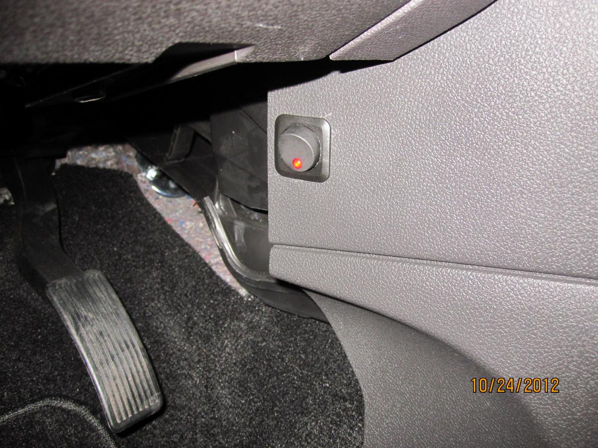

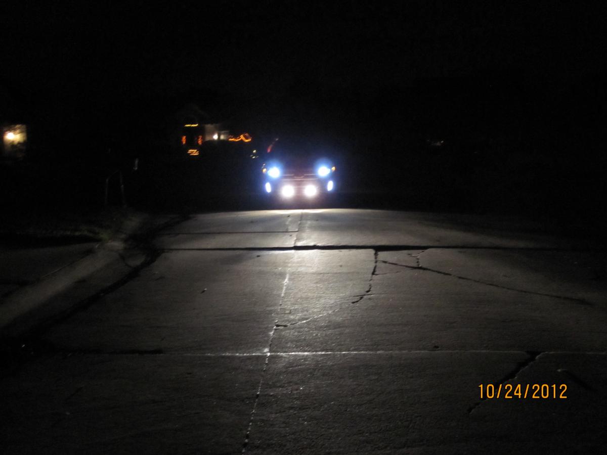

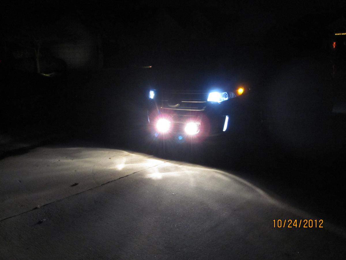

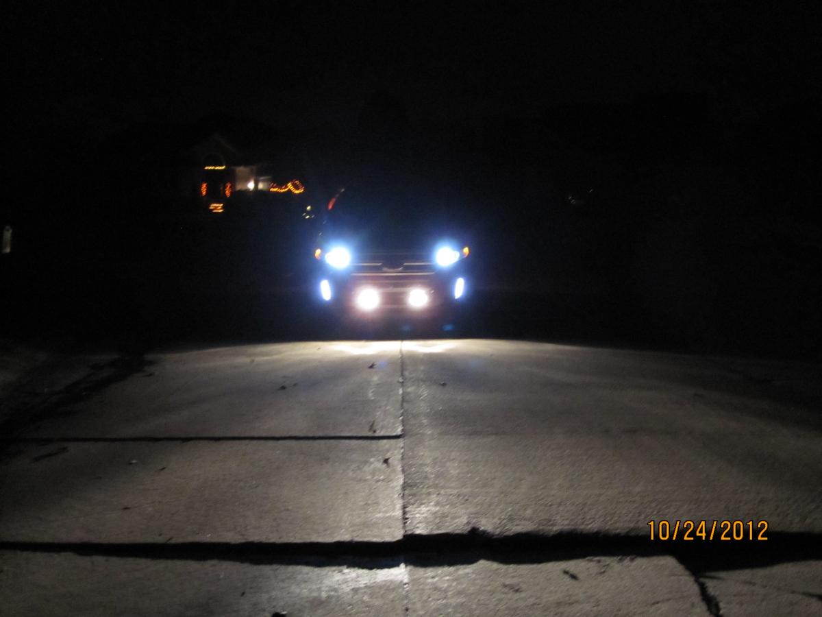

Actually, I used a dremal and cut out part of the grill so lamps would sit back further in the facia too protect them from carwashes and and look more OEM.
Drilled hole through grill and facia and bolted supplied bracket through both. Not sure about shake yet since not completly wired, but seems secure.
Will update with pics when complete.
post-19901-0-49233000-1351122398_thumb.jpgpost-19901-0-49233000-1351122398_thumb.jpgpost-19901-0-36396700-1351122434_thumb.jpgpost-19901-0-10147600-1351122466_thumb.jpgpost-19901-0-40126700-1351122573_thumb.jpgpost-19901-0-12518500-1351122602_thumb.jpgpost-19901-0-89477700-1351122631_thumb.jpgpost-19901-0-37080300-1351122666_thumb.jpgpost-19901-0-06757400-1351122701_thumb.jpgpost-19901-0-12168600-1351122741_thumb.jpgpost-19901-0-81215600-1351122830_thumb.jpgpost-19901-0-77950100-1351122865_thumb.jpg OK, here are a bunch of pics. Fogs are not aimed 100% yet. You can see that the factory HIDs do a good job in lighting up the road and fogs don't add much, if anything. With fogs on, it is a wider beam, and since foggs are supposed to stand alone so you don't get glare reflection. I think they will work good in fog,snow and heavy rain. I have not had the oppurtunity to test in any of those conditions and really don't look forward to it. You can see that I have HIDs, brightlites eyebrowe lights and led parking/turn signal lights that gives the intense white light. The fogs are halogen 55 watt. I did not use the switch that came with the kit because of placement clearance issues, bought of the shelf switch at Rallies and bent prongs almost 90deg. Any questions let me know!
FISHX65, no shake!
Edited by mtbalser

Even if the fogs don't add any light, they look pretty darn good! Great pics. Did you tap into the existing lighting circuit, and how did you route the wiring?
