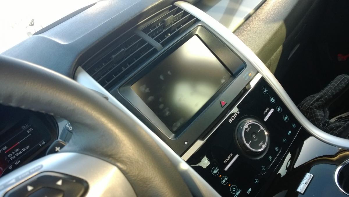

How often does it happen to you that you take off and just when you enter the HWY, you realize the screen in the console is off... ?
Is there any way to turn it back ON while driving if this happens? The only way I know is to pull over and stop/start the car, which is not always possible if you have just jumped on a highway...
And of course it is impossible to repro at dealer... Any ideas how to deal with it?
Don't recall that problem. It sounds like you have a bad APIM. Does it start with the vehicle, then disappear or does it just never come on at all?
APIM? hmm... It just does not start with the vehicle (the screen remains black). Stop/Start brings it back - I am running keyless, so I actually need to perform full stop in order to shutdown the ignition. And it happens once a week... rarely enough so I cannot show it at service, but I will mention it during the upcoming servicing appointment.
