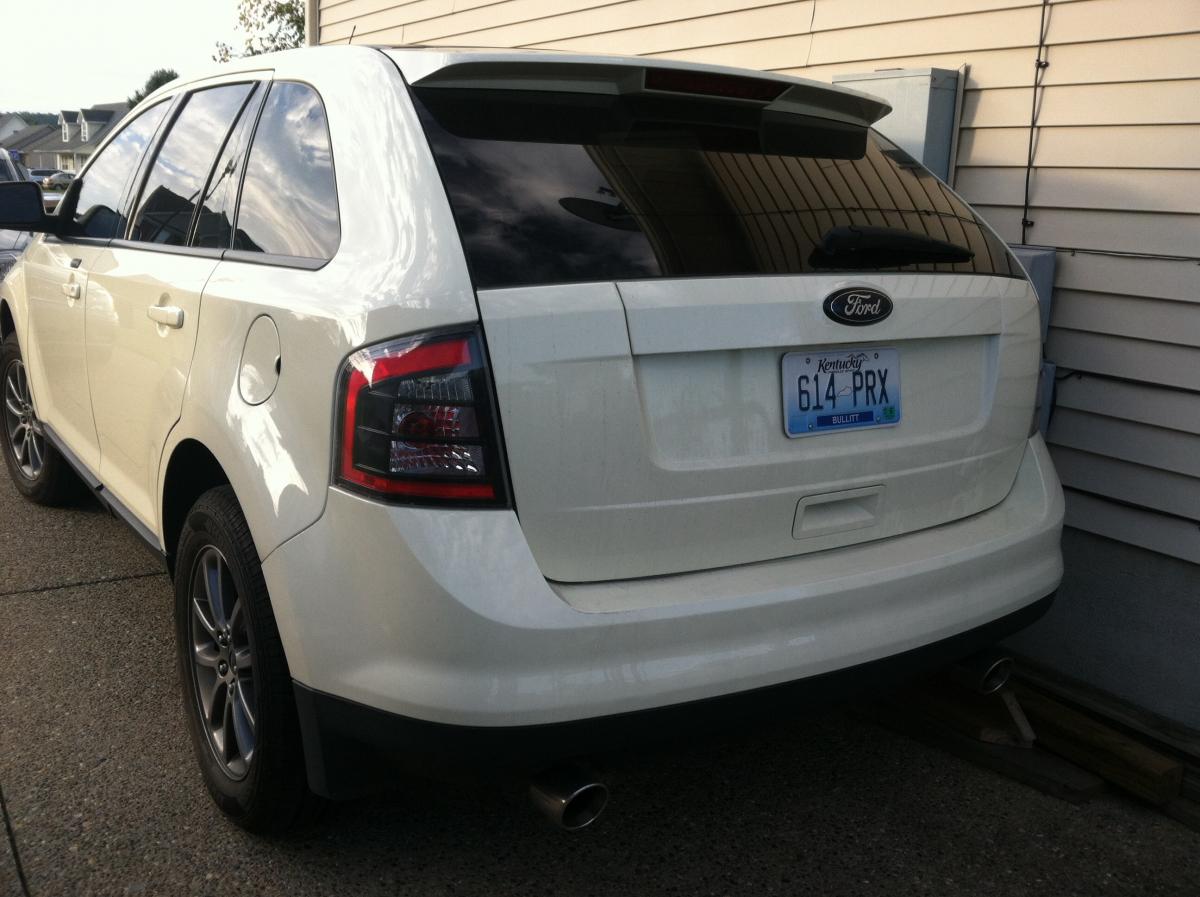

Pictures as requested
Dont do 320 degrees for 15-20 min or you will warp the F%$k out of the plastic like i did. Now I have to live with it for as long as I own the Edge. FML

Just lean from my mistakes and you are golden!!!!
