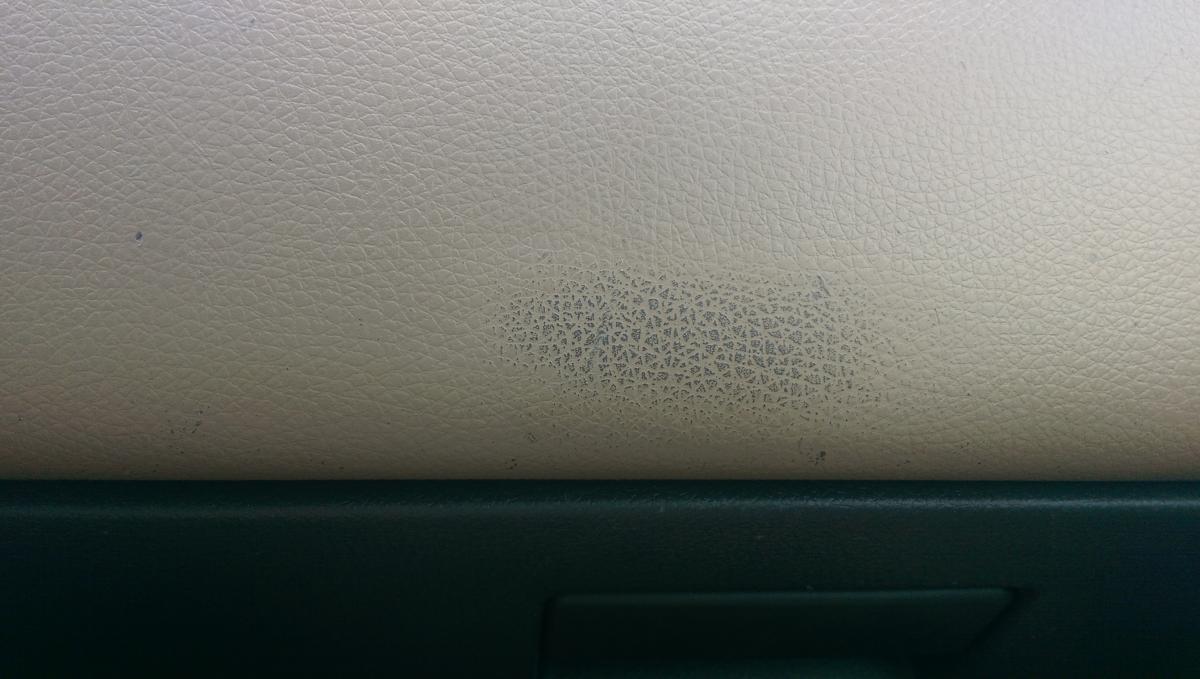

iCanSeeYou Report post Posted August 6, 2014 My passengers are really "edgy", and got my panel scraped from tan to grey in some time. Wondering if theres anything i can do at this point. See attachment. Thanks! Share this post Link to post Share on other sites
akirby Report post Posted August 6, 2014 It has to be repainted. A good detailed can usually do it or you can find DIY kits. Share this post Link to post Share on other sites
iCanSeeYou Report post Posted August 7, 2014 Where should i look for the DIY kits? i'D rather do it myself than overpay Share this post Link to post Share on other sites
akirby Report post Posted August 7, 2014 Google - where else? Share this post Link to post Share on other sites
WWWPerfA_ZN0W Report post Posted August 7, 2014 Is it really scraped, or is there jeans color stuck on there? If it needs repainting, I believe DupliColor & Krylon make paint for plastics, should have a close color match. Basics are the same: lightly sand with a fine grit sandpaper, lay down a coat or two of primer & adhesion promoter, then paint. Some products may allow you to go straight to paint, but even so, you should clean the surface thoroughly with soap & water/isopropyl alcohol first. HTH. Share this post Link to post Share on other sites
CinnamonEdge Report post Posted August 7, 2014 (edited) You need COLORBOND. Ive used it on vinyl and leather and its amazing. It dries in 15 minutes. I did my leather steering wheel and leather driverseat in my Escape and it held up better than the factory leather. Had it for 4 years and it showed now wear and tear. They match your interior colors using a color chart on their site. I will post pictures when I get a chance and good luck. http://www.colorbondpaint.com/ Edited August 7, 2014 by CinnamonEdge 2 Share this post Link to post Share on other sites
iCanSeeYou Report post Posted August 9, 2014 Thank You all for the replies. I tried looking around for the correct coulor, and even consulted with some painters, and all od them suggested repainting it all, and if offered to just cover the peace and do it, refused since they're not sure if they can match the color. And when asked for prep'ing repainting price, i decided to stick with it untill i find an edge thats up for parrts with its airbag still inplace. Share this post Link to post Share on other sites
CinnamonEdge Report post Posted August 9, 2014 Im telling you that Colorbond product is amazing and is a perfect match. It is not paint but a dye coating and will last and look as good as factory. Share this post Link to post Share on other sites
iCanSeeYou Report post Posted August 9, 2014 (edited) Uhh, you think preping the panel part and only doing it will not mismatch other side of the panel? -Edit- Okay i looked further into them, and decided to give it a shot later on. But what kind of coulor am looking at? Camel, light tan, praire tan? Edited August 9, 2014 by iCanSeeYou Share this post Link to post Share on other sites
PaulSchott Report post Posted August 23, 2014 Thanks Cinnamon Edge, I just ordered from Colorbond today. My interior is the same as icanseeyou's and has the same problem. The color is Camel. I'll let you know how the color matches. I want to do a blend on the dash and completely do the console armrest. I'' try to post before and after pictures Thanks Paul Share this post Link to post Share on other sites
CinnamonEdge Report post Posted August 25, 2014 It is amazing stuff and very durable. Cant wait to hear how it worked out for you. Share this post Link to post Share on other sites
PaulSchott Report post Posted August 31, 2014 The spray is a nice product but it doesn't really match the camel color properly. It is too yellow. if I get a chance i'll post pictures. I did the armrest and it really looks out of place. I might just go with the contrasting brown color on the dash for the arm rest and call it custom. lol Share this post Link to post Share on other sites
PaulSchott Report post Posted September 26, 2014 Hi guys, Just want to let you know my Ford dealer screwed up when he told me the color was Camel. The color is really Medium Light Stone. The new order I placed came in today and I used it to fix my armrest, dashboard in a couple of places, drivers side door panel near the top where it was starting to fade and my steering wheel which was starting to look really skanky. This is a fantastic product. I didn't paint the entire panels, I just masked off any contrasting panels and did a blend spray in very light applications at first and then a little heavier in the areas that needed fixing sort of what you do when you blend the body panel next to the one your painting. the sheen is perfect and blended in without a trace. Verrrrrry happy fellow here. I should have known better than to believe the Ford guy who just came outside, looked at it and said Camel. Oh well, all is well that ends well. A very special thanks to CinnamonEdge for the product recommendation. :) Share this post Link to post Share on other sites

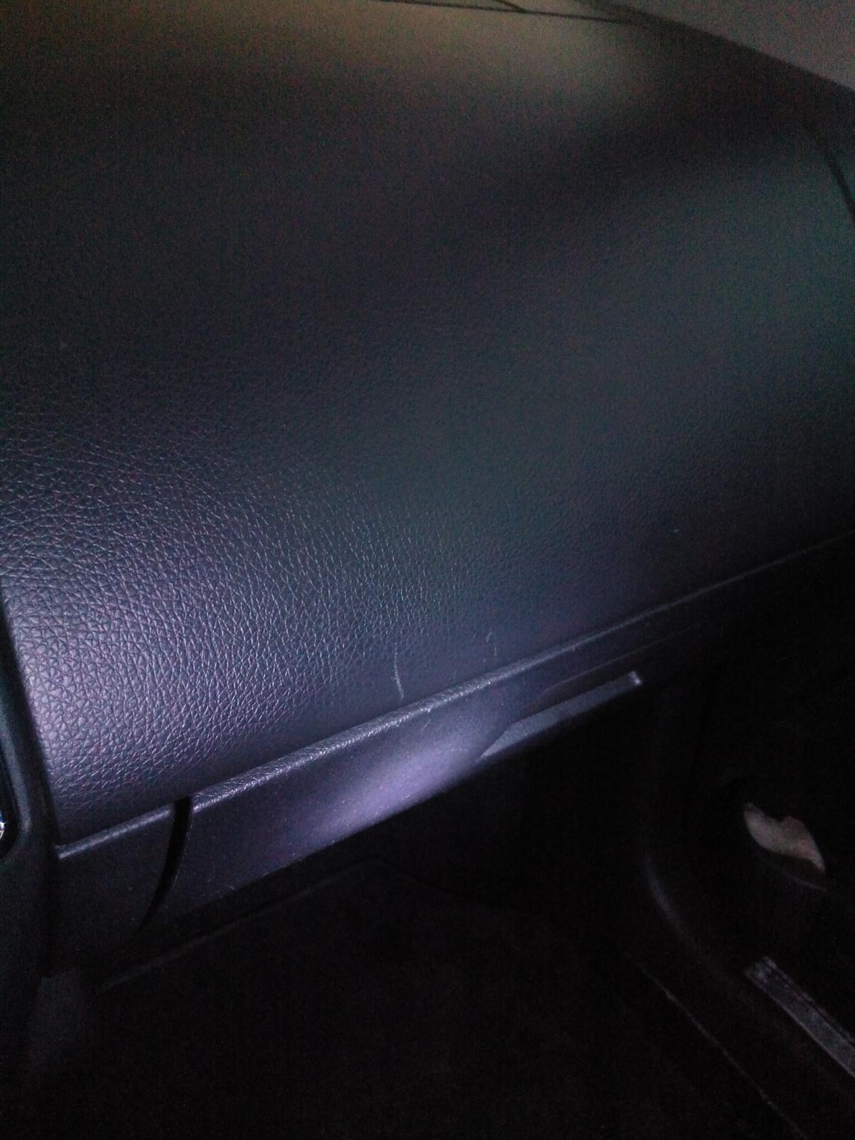

EDST777 Report post Posted January 2, 2015 (edited) Hello! Happy New Year!) I have the same problem (I attached images of a door and a torpedo). With what paint I can paint, options? I am afraid that it will be difficult for me to ship the specified paints! I live in the Urals. I wish to correct it beautifully. My prospects?) .Thanks. Edited January 2, 2015 by EDST777 Share this post Link to post Share on other sites
wannabang Report post Posted January 2, 2015 I have a couple similar areas where scratches lead to discoloration, and while I'd like to make the scratches go away, it'd be easier to just hide it with the same color. Share this post Link to post Share on other sites
PaulSchott Report post Posted January 3, 2015 Get the correct color and buy the touchup from colorbond. You won't believe how good it is. Share this post Link to post Share on other sites
