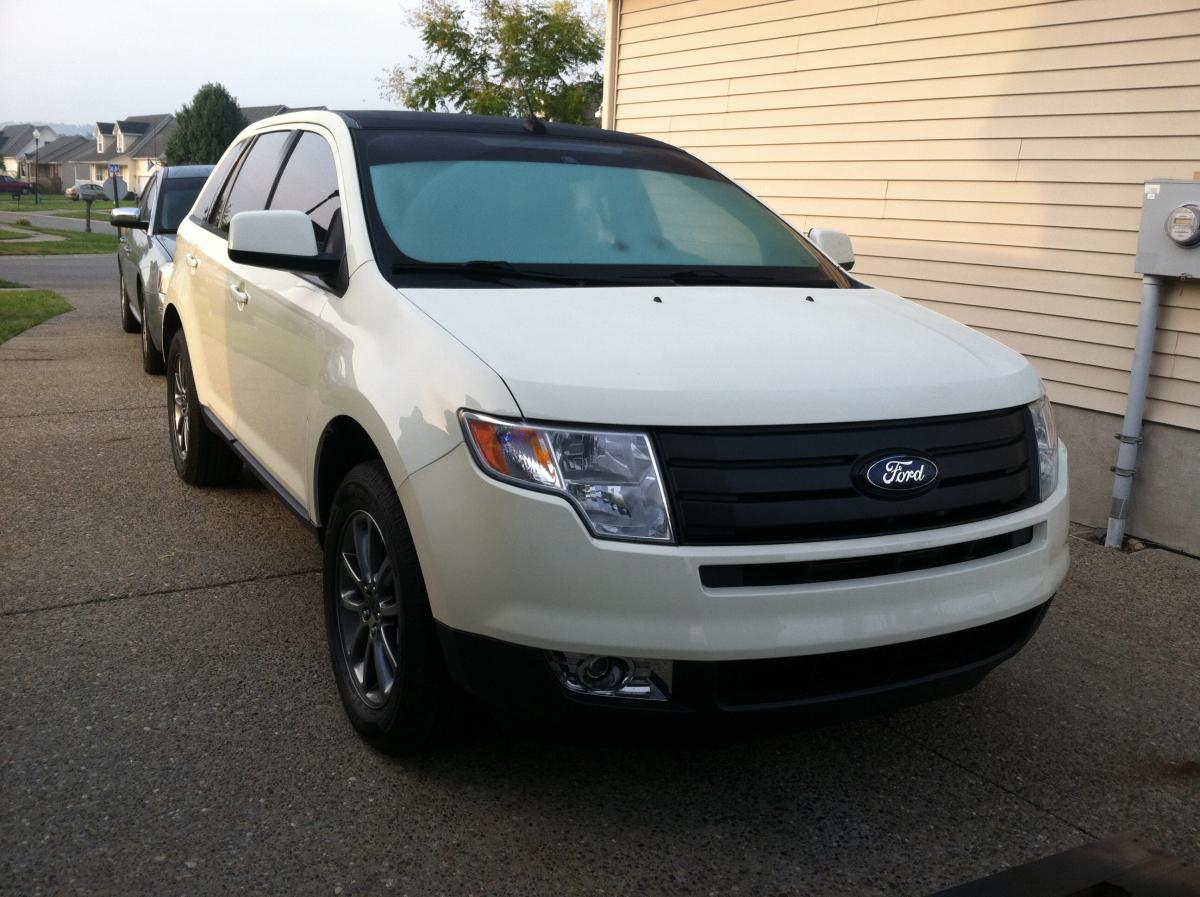

I plastidipped my grille in August I believe, and it's held up the whole time. (my avatar)
