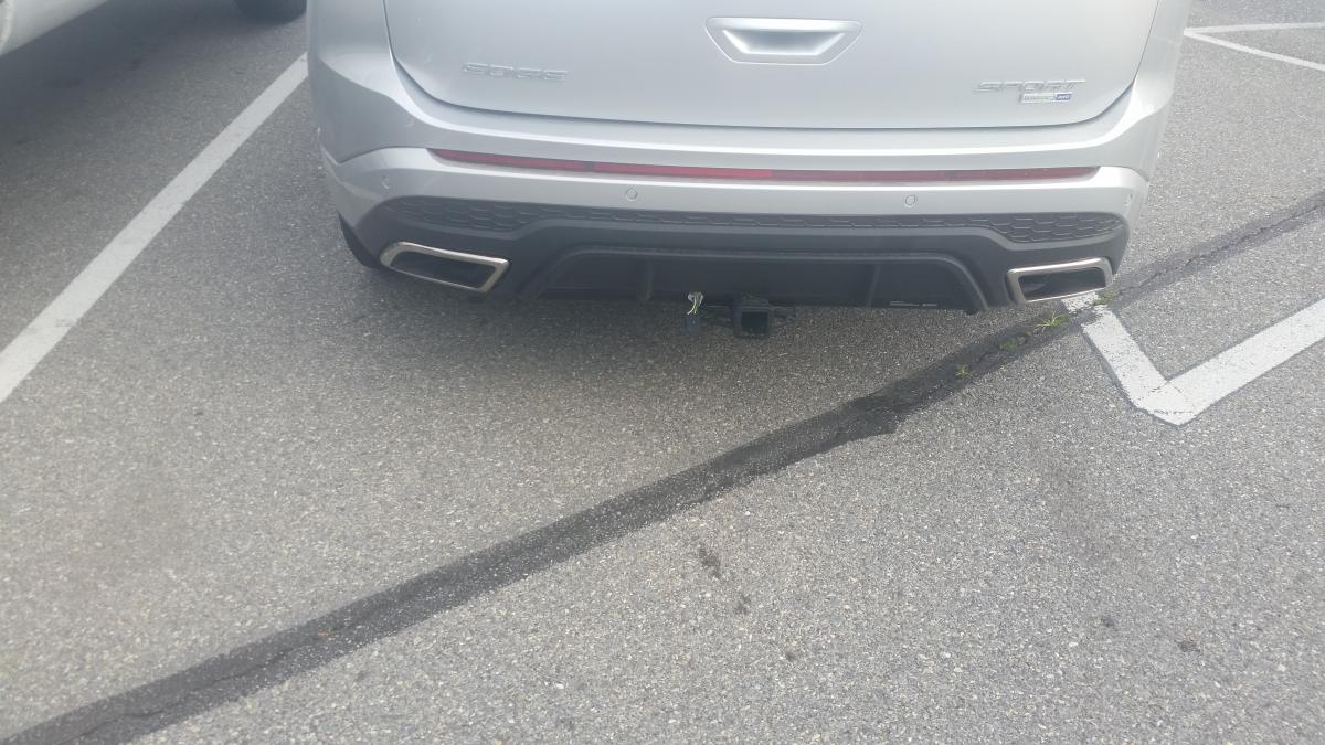

Natem91 can you get a part number. And is there anyway you can take a couple more pics from further away?\

The part number on invoice is 13224hc. I paid 170 at curt it shows 260. Hope these pics are what u wanted to see. There is no cutting on my plastics

Looks reasonable to me for a vehicle that Ford doesn't sell with a hitch option.

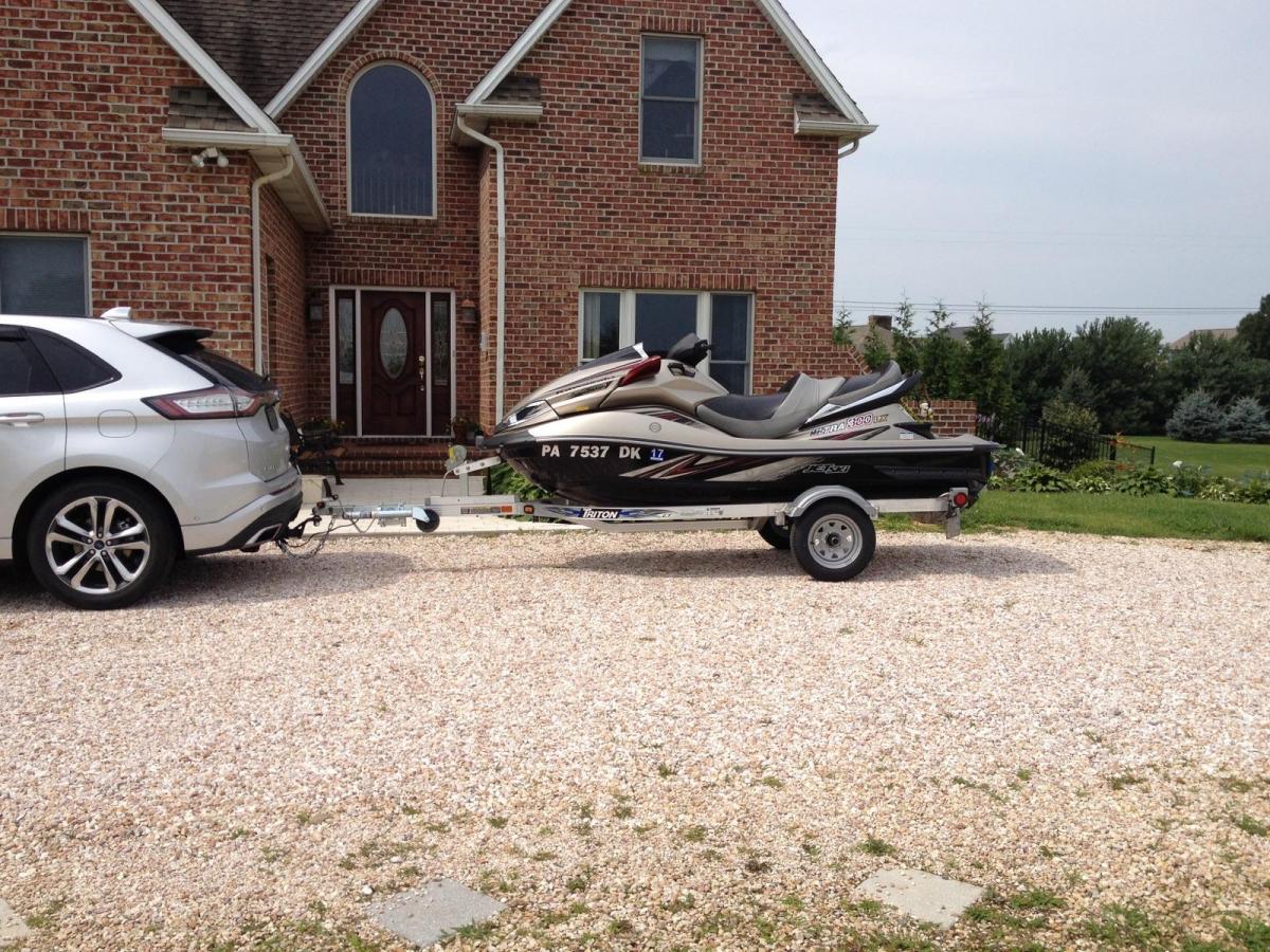

What will you be towing? I feel like its going to be super low to the ground and the trailer will be on a downward slant.
Thanks. Same here. If I get my truck done in time I will be going to PA next weekend with the ski. Lake Wally
And I have the hitch insert I can flip to add some height

Natem91, did they had to run wiring to the hood of the car for the harness? Or was the wiring already there from the factory?
It looks pretty good.
You could maybe try to cover up the wiring harness cables with electric tape.
I an not sure on the wiring, but I will crawl under and let u know. I will post pics tomorrow of it hooked to the ski, it isn't too low, it is perfect
Pulled with it today and no issues. I found sport mode does work best.

Did you have a chance to look at the wiring harness? Is it plug and play or from the front?
It went up into the taillight assembly, so I assume it is plug and play

Yes, got the hitch and harness from curt. The part numbers are 13224 for the hitch, and 56272 for the harness. Was $200 shipped (Canadian). Pretty good deal!
I was thinking about going with the hidden hitch but it actually looks like the curt is covered more.
