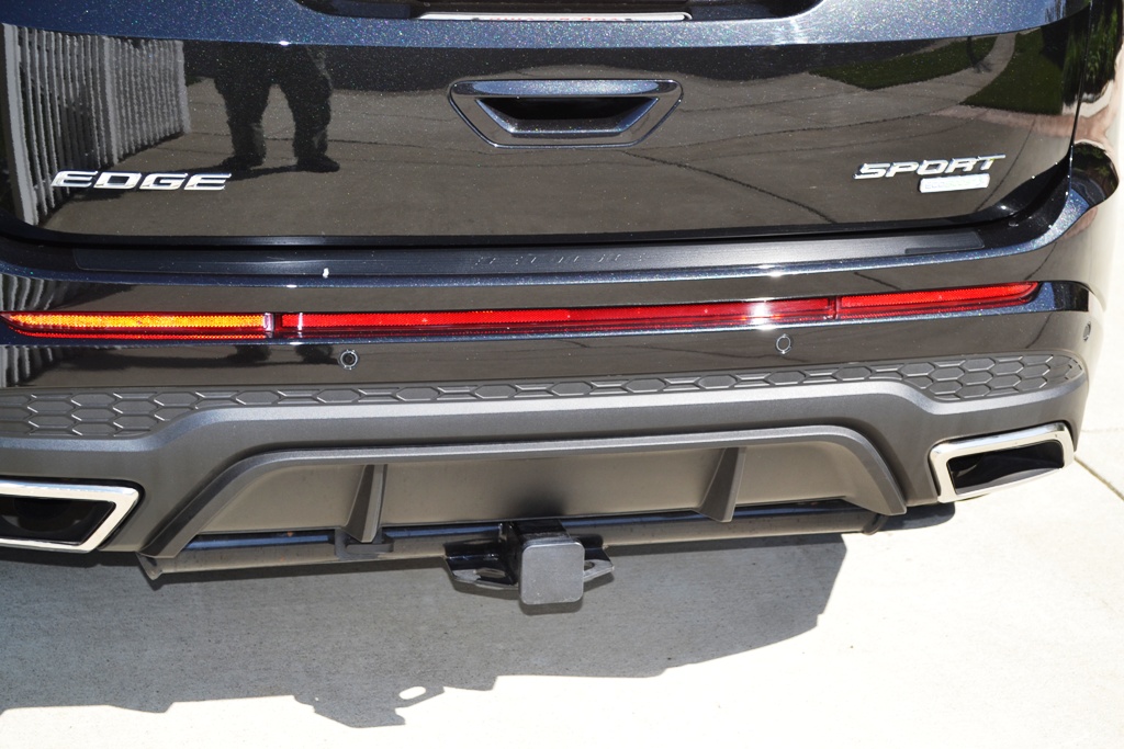

As I stated in my earlier posts, I had installed the Curt Class III hitch. It has the round-tube construction, and, while it does show a bit below the Sport's rear valence, I don't think it looks bad at all, considering how big and beefy the unit seemed to be. I now also have my wiring terminated in a standard 4-prong female connector unit, mounted in a special bracket to the left of the receiver. (Although my earlier post showed the connector hanging down, it's because that first photo was taken just after I had finished the hitch installation itself. The next day, I installed the connector bracket, so that it was all clean and properly-done). No "dangling wires" here for me, either!

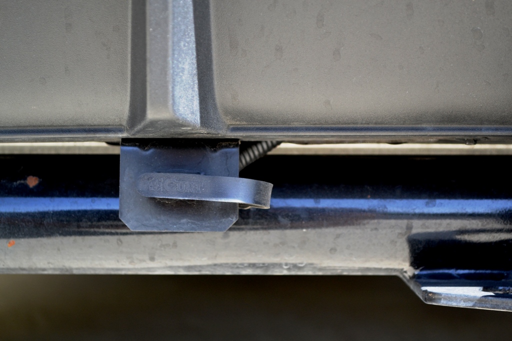

To answer "Pi"'s questions, the wiring connector that came with my Curt wiring kit included a standard 4-wire "flat" connector. The connector simply snaps-in to the U-Haul "4-Flat Bracket" (their part number 13302, at $3.95 each) that I found at my local U-Haul accessories store. I first mounted the bracket to the underside of my rear valence, by drilling two 3/16" holes and using a couple of 3/16" rivets to permanently mount the bracket into place.
Ā
See the photos below, to (a) see the mounting bracket installation, and the overall hitch and connector installation.
Ā
Ā
Ā
Now that is visually pleasing. Thank you for posting the info and pics.
