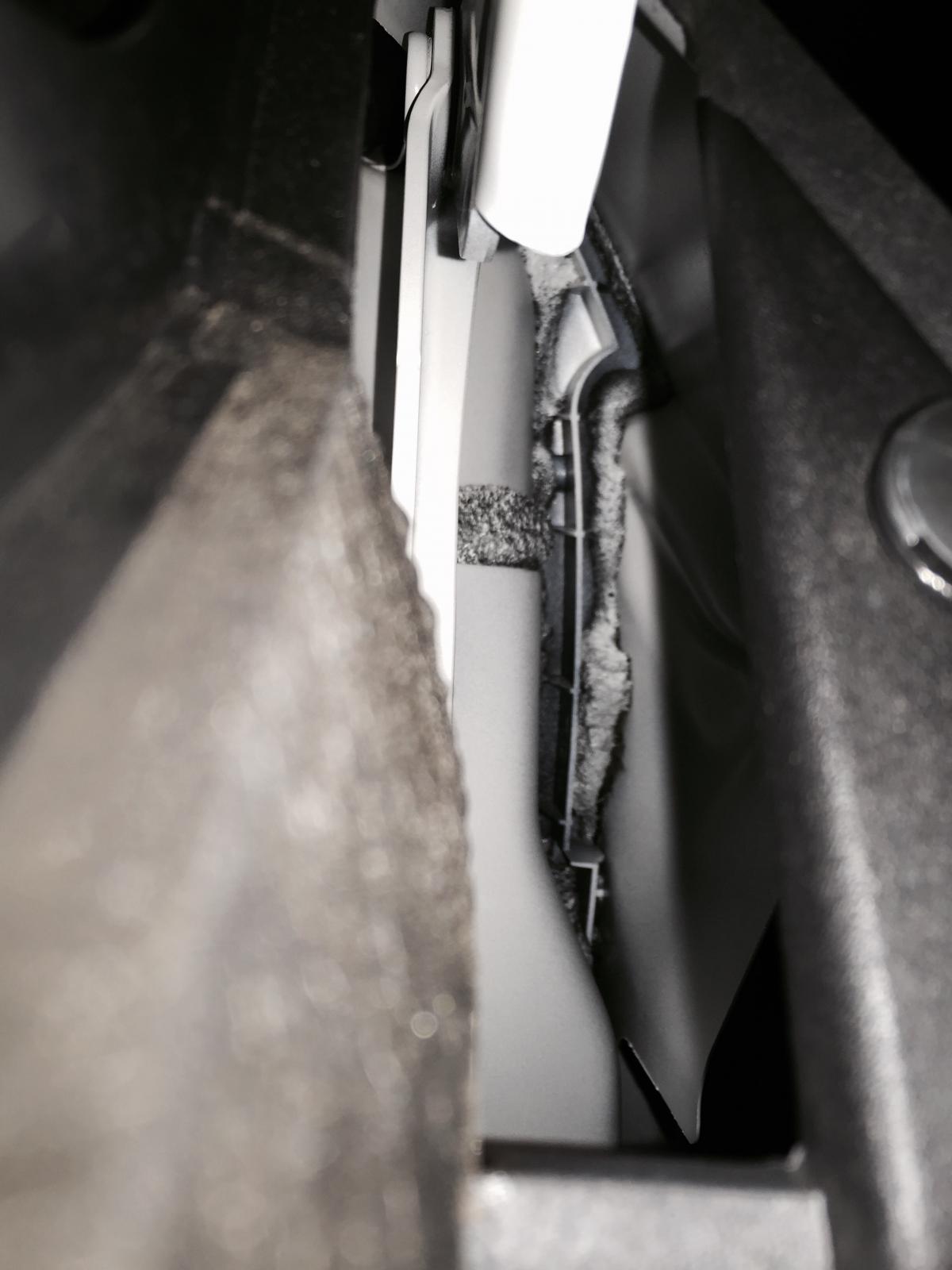

Can you take a pic of your seal as I did with my car. I'd like to see what is coming out of the factory now.
WingNut, attached is a photo I took tonight of the sealant that is applied to the A pillar. There was a good rain here today and my edge is still dry, so appears the initial wet carpet I experienced picking the edge up from the dealer was from the door being opened during a heavy rain. (Knock on wood). I am attaching the pic of my edge with sealant compared to the photo you originally posted.

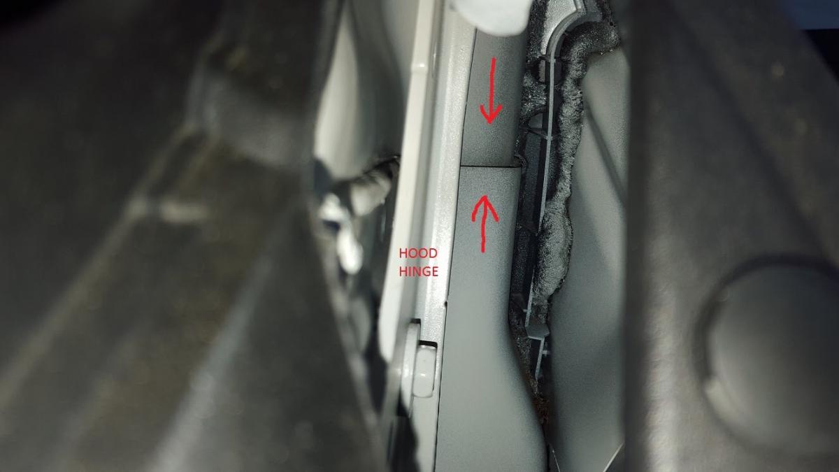

I asked from where came the problem, the hood hinge.
