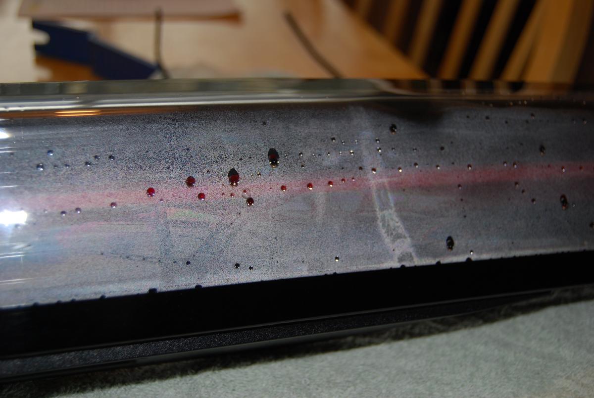

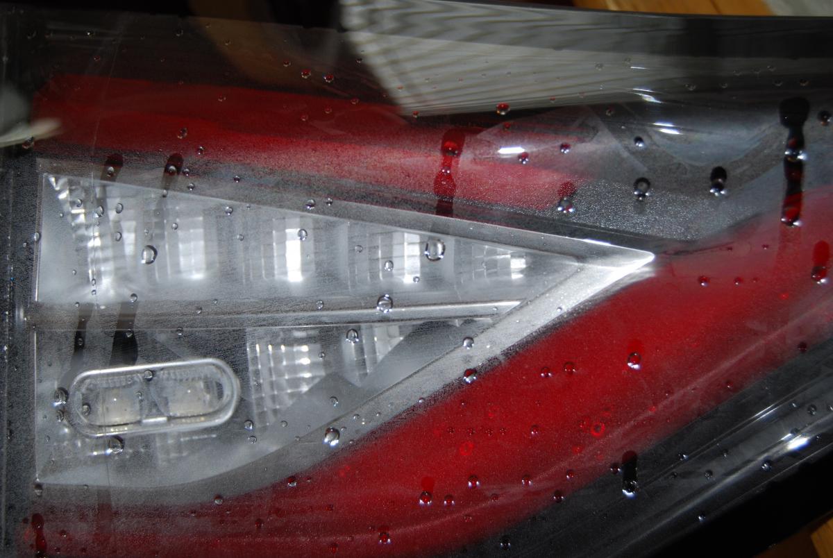

I have the same problem. I thought I could remove it and dry it out, but it's a one piece sealed unit. Can't remove a bulb to open and dry it out. Can't see where water can get in. Tried a vacuum and air compressor, but couldn't get the water to move. Only tipping it on it's end will get the water to move back and forth. I guess I'll take it to the dealer and ask them to "fix" it.post-38877-0-49025000-1449788796_thumb.jpgpost-38877-0-81156800-1449788815_thumb.jpgpost-38877-0-27854500-1449788831_thumb.jpg
