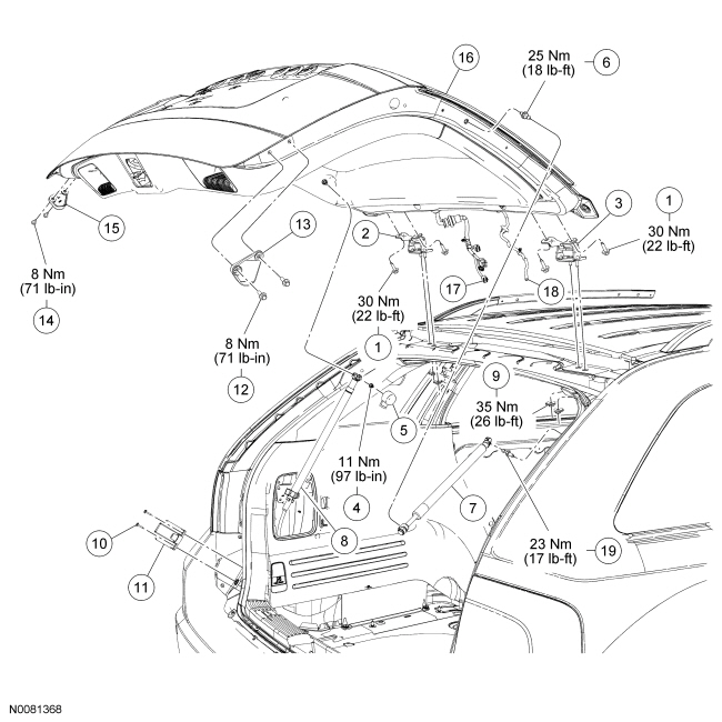

Here's a pic of components
Removing the power liftgate rod should be a simple matter of removing the one nut attaching it to the liftgate. Not sure how freely it would move after that to be out of the way for full manual operation test.
