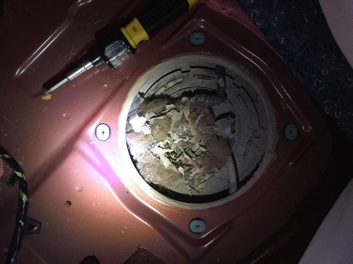

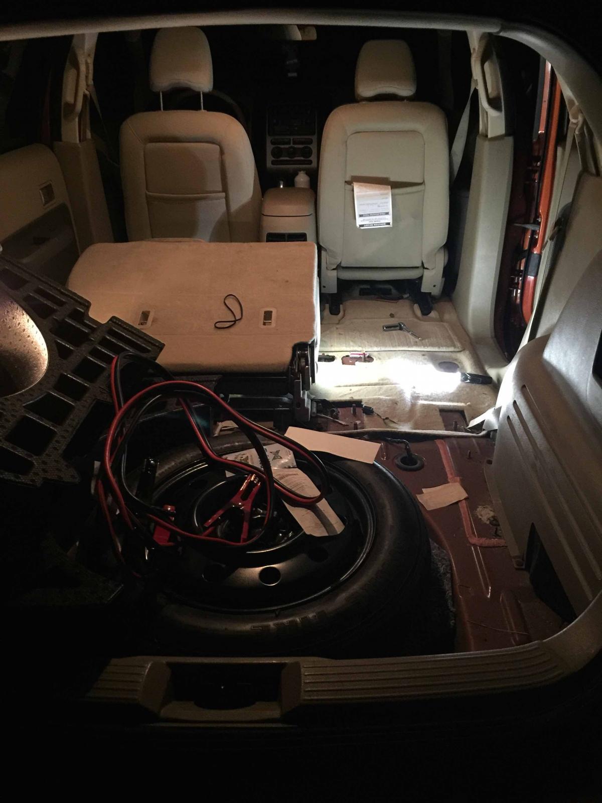

mrtm2016 Report post Posted August 25, 2016 Okay, so I've taken out the fuel pump and inspected it but it seems not to be an electrical issue. I went ahead and ordered a replacement while I'm here.. I'd like the car to last a long time so might as well replace it since I'm here and it seems like the filter is dirty. Getting it on Friday so will post with an update. Alternator:: never had the check engine light come on, though we did do a load test while checking the first new battery before replacement.. It came back to say the alternator was fine. No regular signs of alternator issue with lights dimming and such. Didn't turn the wipers on during test. Revved up the engine to about 1.5 - 2k RPMs and had the stereo and ac and lights all on at the same time. When the car is off, actually, the remote locks respond a lot quicker now with the new battery and it hasn't drained at all it would seem. Just still slow to start. I've got no after-market parts. But what's this one-by-one testing? I may do that.. I'm not the most experienced with electrical equipment, would be scared of shocking myself without trusted starting information. I'm also replacing all the spark plugs. The first three I've taken out seems to be decently worn - figured that's an easy thing to switch out while the car is stalled anyway. Haven't had an misfires, but who knows - mileage has been shitty for the last year so this could likely be a cause of the issue, battery issues aside. Share this post Link to post Share on other sites

mrtm2016 Report post Posted August 26, 2016 (edited) Okay, so I got a new fuel pump in the mail from Amazon: TOPSCOPE FP2470M - Fuel Pump Module Assembly E2470M fits 2007 2008 2009 2010 FORD EDGE, LINCOLN MKX https://www.amazon.com/gp/product/B01DM6IQE0/ref=oh_aui_detailpage_o00_s00?ie=UTF8&psc=1 Amazon said it didn't fit but the same model for Advance Auto Parts and others said it was fine. The only difference I noticed was the protrusion at the bottom. I assumed it was a change made after release for easier fuel consumption, but I could be wrong. Here's a picture of my old pump. And the new one is on that page. I'm still having problems with starting the damned car and I'm honestly about to lose it. I've replaced the starter, the fuel pump, spark plugs, battery, and so it looks like it's either an electrical issue (which I'm not gonna diagnose myself, unless it's really as easy as you guys say it is) or the Alternator. Also, side note. The new pump doesn't float on top like the old one did. It's extended all the way to the bottom of the tank and you can hear the hum it makes vibrating the tank. Is this normal for a new pump or did I neglect to pull out a stopper at some point? K thanks. Appreciate the help guys! Edited August 26, 2016 by mrtm2016 Share this post Link to post Share on other sites
WWWPerfA_ZN0W Report post Posted August 27, 2016 Do you have AWD? Then this pump should fit. Will not fit FWD. Might be the difference right there. 1 Share this post Link to post Share on other sites
mrtm2016 Report post Posted August 27, 2016 Pretty sure I have a FWD vehicle. So lame. But yet, the pump has been working... is having that extra valve at the bottom going to ruin the engine?? Share this post Link to post Share on other sites
WWWPerfA_ZN0W Report post Posted August 27, 2016 (edited) No idea. But vibration in a fuel tank is never a good thing. Edited August 27, 2016 by WWWPerfA_ZN0W Share this post Link to post Share on other sites
