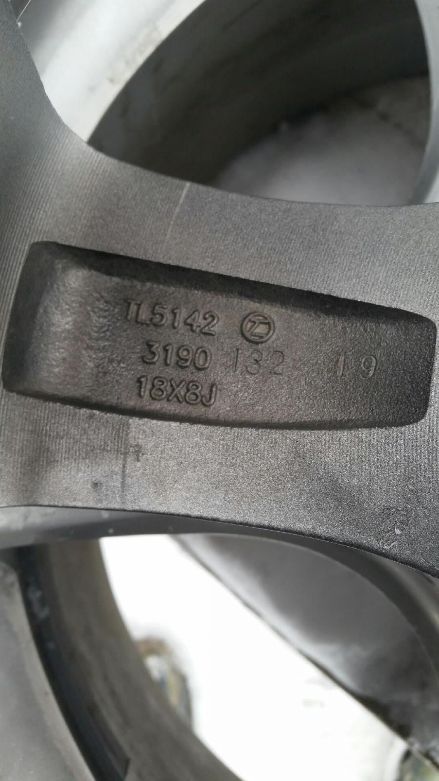

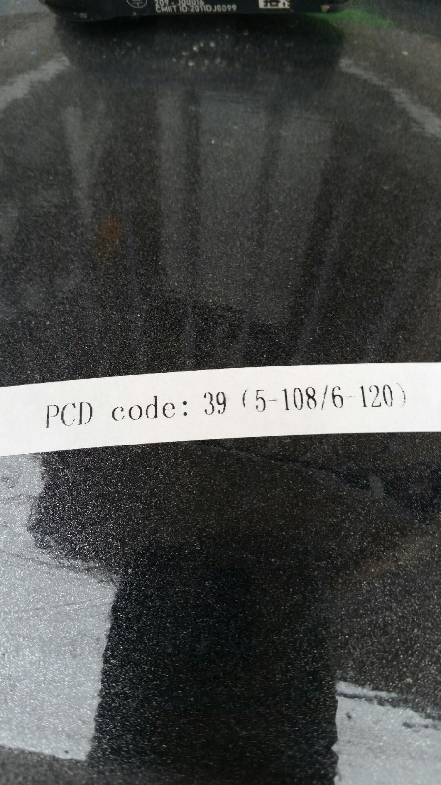

Now I'm looking for winter rims. Found a used set on classifieds. Touren Brand TR9 3190 universal 18". Sticker says PCD code: 39 (5-108/6-120). I'm assuming this means it will acommodate 5x108 bolt pattern?
How do I know the centerbore diameter?

Yes, 5x108 is the bolt pattern. Make sure the offset works with the Edge.
Can you explain offset?

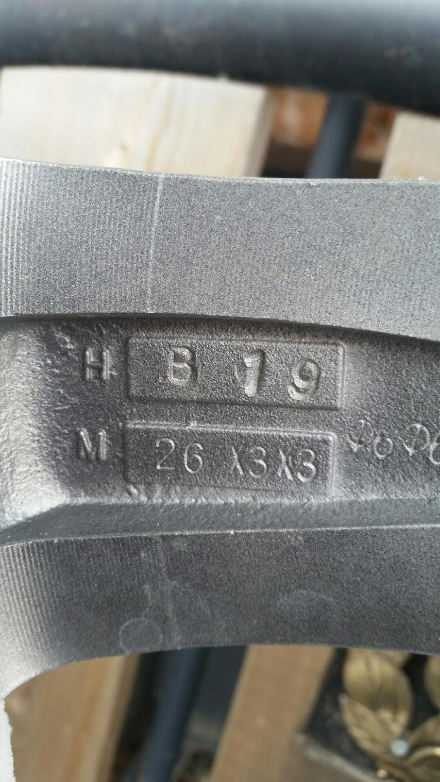

Edit: I think I understand the basics of it. But I can't tell what it is from the time I want to buy. I read that the number is prefaced by 'ET', usuallly listed after the wheel dimensions, but this is not the case on this wheel. Will attach pics.
I believe offset for factory ford rims is 52.5. So is this going to work?
Edited by hitops
Offset is where the mounting flange sits relative to the inside and outside edge of the wheel. Tire rack should have a great explanation and you can find the offset of compatible wheels there for comparison.
